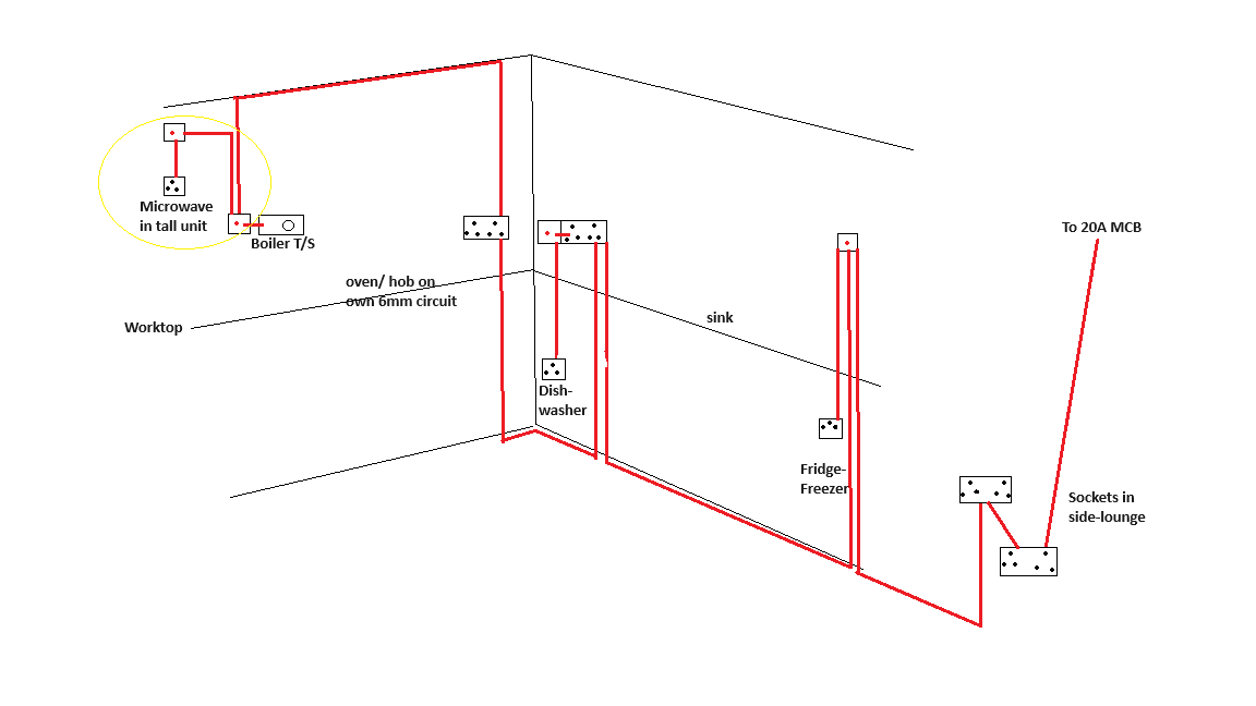

Hello Everyone,
I just want to make sure I'm ok adding this new socket for a microwave.
I plan on putting in a single socket on a 13A fused switch and linking it as a spur from the existing radial circuit. It will be in 2.5mm2 T+E, running from a circuit which is protected by a 20A circuit breaker. The cable will be run in surface trunking over tiles vertically and across in to a cabinet, all sealed safely. On the board, it shares a 63A RCD with four other 20A fuses.
I have attached a diagram showing what is already on it.
Thanks for your reply! I guess it's better to put a FCU on it because if it has a problem, it won't affect the whole line I don't think? i.e if it trips for some reason, the boiler and fridge etc stay on? It is a 1000W microwave so would require a double pole FCU I believe.
True - but just a 20A switch is required for that - although they cost more than the FCU.
I think they are all DP.
Unlikely.
If the RCD trips, the whole circuit and several others are off.
If the circuit breaker trips, the whole circuit is off.
If the fuse in the FCU blows, then only the microwave is affected - but it already has an identical fuse in the plug. You don't need another one.
If there is some problem with the microwave, it can be disconnected by unplugging it.
As above. Connection-wise its ok.
But I would worry about a 20amp MCB being man enough for Fridge/Freezer + microwave + dishwasher + whatever else is plugged in to the 4 x 13A double sockets.
That's my worry :( Occasionally we have had a heater plugged at Christmas when using a lot of sockets and the breaker has tripped.
But it might be a big job to remedy it. We would have to put in a new circuit and corresponding MCB, that could take some of the load. Too big a job to change to a 4mm ring. I've thought about putting some of the load on to the 6mm/ 32A hob/oven circuit. I think the hob is about 5-6kw and is wired in 2.5mm to a 13A FCU, which goes to a switched 45A FCU via 6mm which also has the (4.4kw) oven. Maybe an opportunity there somewhere?

In that case, the circuit is already at its limit. A new circuit would be best.
Why 4mm ring?
The current circuit is a radial probably wired in 2.5mm. It could be turned into a ring and the MCB uprated to 32amp.
See if a 25A Mcb is available for your cu
That seems like a great idea. There are currently 5x B20s protected by a 63A RCD so I could ask to have one upgraded. It's not much, should handle it.

Also a great idea, pushing it though unless changing out the 63A RCD for a 80? A 25A swap for the 20A might be easiest (and cheapest!).
Well changing the MCB doesn't mean you are taking more current than at present (well, apart from the microwave). Are you likely to be taking 230 x 63 = 14.49kW at a time on those circuits?
No I can't see it unless a lot of big electric heaters plugged in at the same time. With diversity in mind also it would be just fine.
