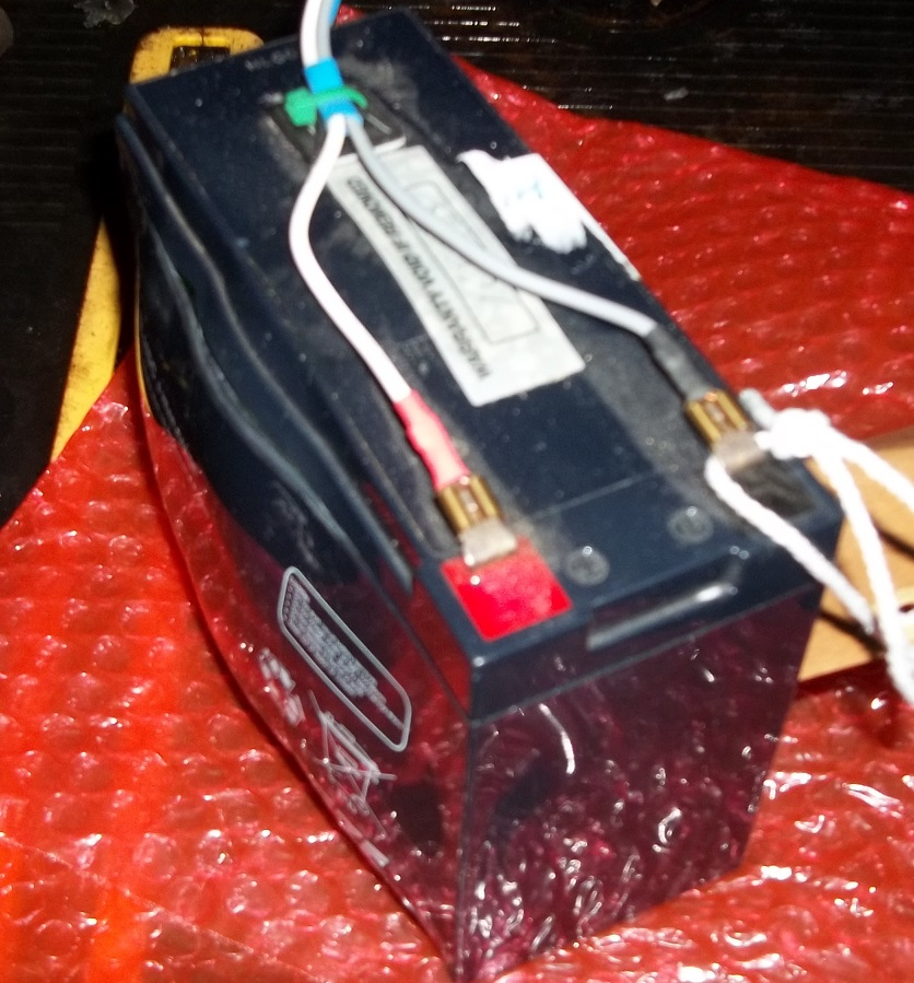

The result of using an inappropriate charger
