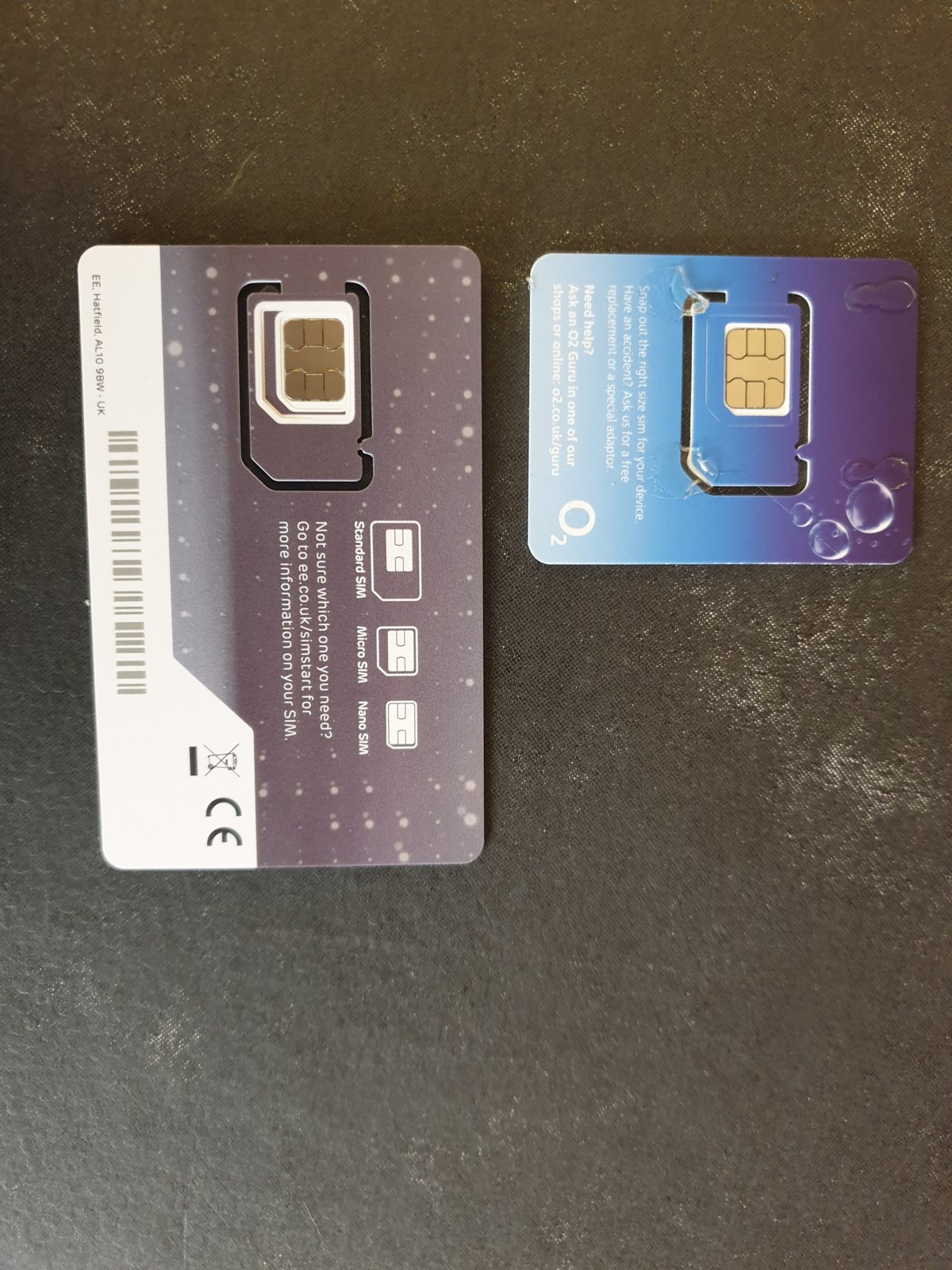

I see what you mean about modern O2 sims. I ordered some PAYG sims the other day. The EE ones are full size but the O2 ones are now half size. What I would do is push out the micro/nano size sim from the EE sim and replace it wit the same size sim from the O2 one. Should be a nice fit but you can always put a piece of sellotape on the non contact side to hold it in place. (y)

Utilising the card reader in the boot of the car I was able to insert the largest 'standard' PAYG card available (although too short against the original 1FF) by pushing it fully home with a credit card. I also managed to replace the original snapped off antenna mast with a genuine BM item, so I now have 21 year-old working 'phone … total cost £30 inc. £10 credit on the card (y)
