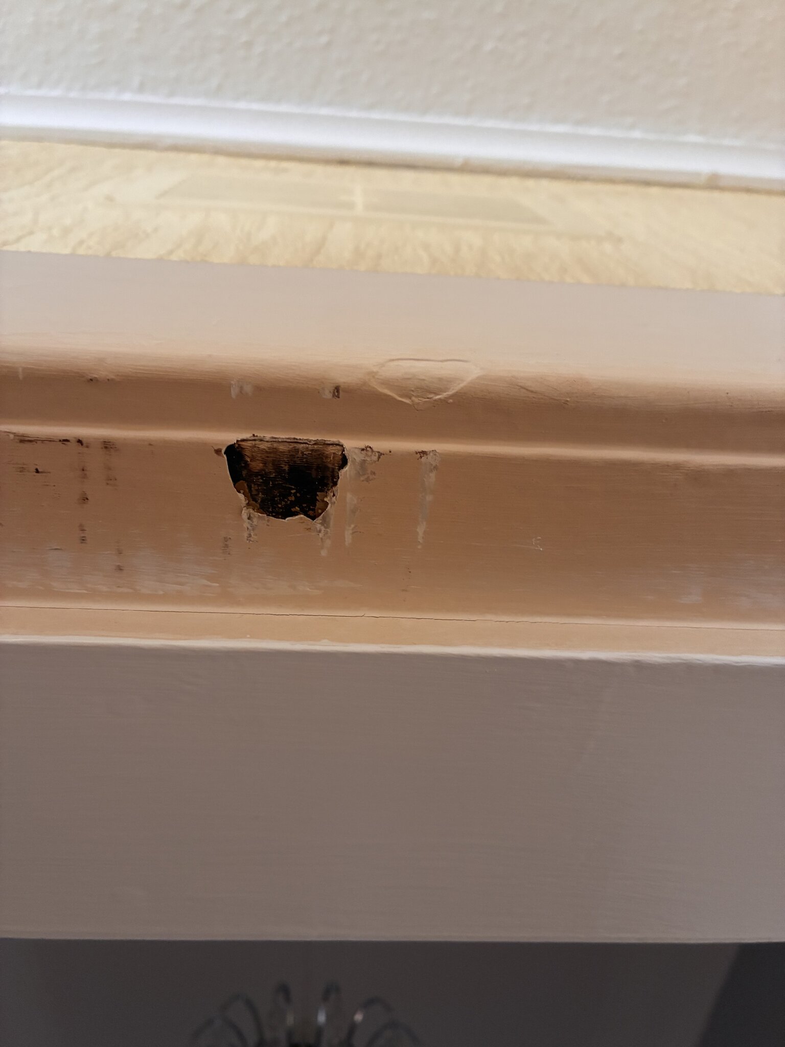

My house is pretty old. Not sure how old - I think they were built after WW1. The original skirtings, architrave and door frames seem to have been some kind of dark stain/varnish
I’ve replaced everything except the frames but with decades worth of old paint on them, they look really scabby. I did try a heat gun but the original varnish went really sticky and stringy and it was a nightmare - then it suddenly dawned on me that some of the paint is potentially lead based.
What can I do to get rid of all the old paint? Not sure about paint stripper as I think that would be really messy.
Picture showing lovely big chip
Buy 5lt of paint stripper as the larger tins aren't for DIY market and the good stuff, or if you can spring for a speedheater cobra infrared paint stripper, that will work.
Definitely will have lead in paint
