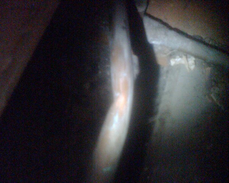

X800 has now been drained out and refilled with plain tap water, got the cytrol valve working as well. Still got the pumping over on anything above 1 so started to have a look around at the pipework. I have found a kink (not totally crushed) in the cold water feed from the F&E tank (see photo sorry for poor quality).The pipe is 15mm and the kink is around 3M from the tank. I have also found where it tees into the heating circuit (still 15mm)but no magnetic attraction.
Do you think this kink could cause my pumping over? Or is it just generally a poor system design 15mm not going to 22mm (although from the boiler is 22mm). However system does seem to perform ok but I do think it may be drawing in air perhaps due to kink

Only issue I seem to have is the pumping over on anything but 1. This is why I have had the floor up to try and find if I had corrosion/magnetite build up. This is when I found the damaged pipe.
