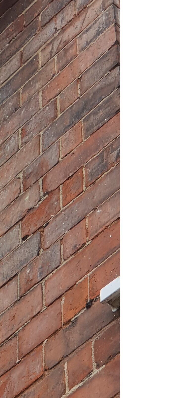

Hi,
I am thinking of renovating a 1930's ish four bedroom terrace property as a potential investment opportunity.
Read about some new regulations coming in where properties cannot be rented unless have an EPC rating of C or higher.
I think the property may have solid wall rather than cavity wall. See example brick layout I have attached.
Have a few questions looking for some advice on please:
1. From the picture I have attached showing the external brickwork design, does it look to be solid wall and not cavity?
2. If I hired someone to install internal solid wall insulation, presume I would only need to do this on the external walls and not the side walls (due to being a terraced) or other internal walls?
3. I am aware will lose about 4 inches of space with internal solid wall insulation, but there are any other disadvantages?
4. Would it be hard to hang anything heavy such as shelves or fit a tv to the walls that are internally insulated afterwards?
5. Can you share any indicative average costs for this?
Thanks in advance or any comments, thoughts and recommendations.

1. From the picture I have attached showing the external brickwork design, does it look to be solid wall and not cavity? Solid.
2. If I hired someone to install internal solid wall insulation, presume I would only need to do this on the external walls and not the side walls (due to being a terraced) or other internal walls? Correct.
3. I am aware will lose about 4 inches of space with internal solid wall insulation, but there are any other disadvantages? My advice is use 60mm thermal laminate board.
4. Would it be hard to hang anything heavy such as shelves or fit a tv to the walls that are internally insulated afterwards? No problem.
5. Can you share any indicative average costs for this? No, sorry.

I'd go for external wall insulation - doing that makes the walls a part of the building's thermal mass (i.e. the walls will be warm) target is 100mm. It also means you do not loose internal space. I paid £35 per square meter including scaffolding rent, waste disposal etc for the external wall insulation on my property.
