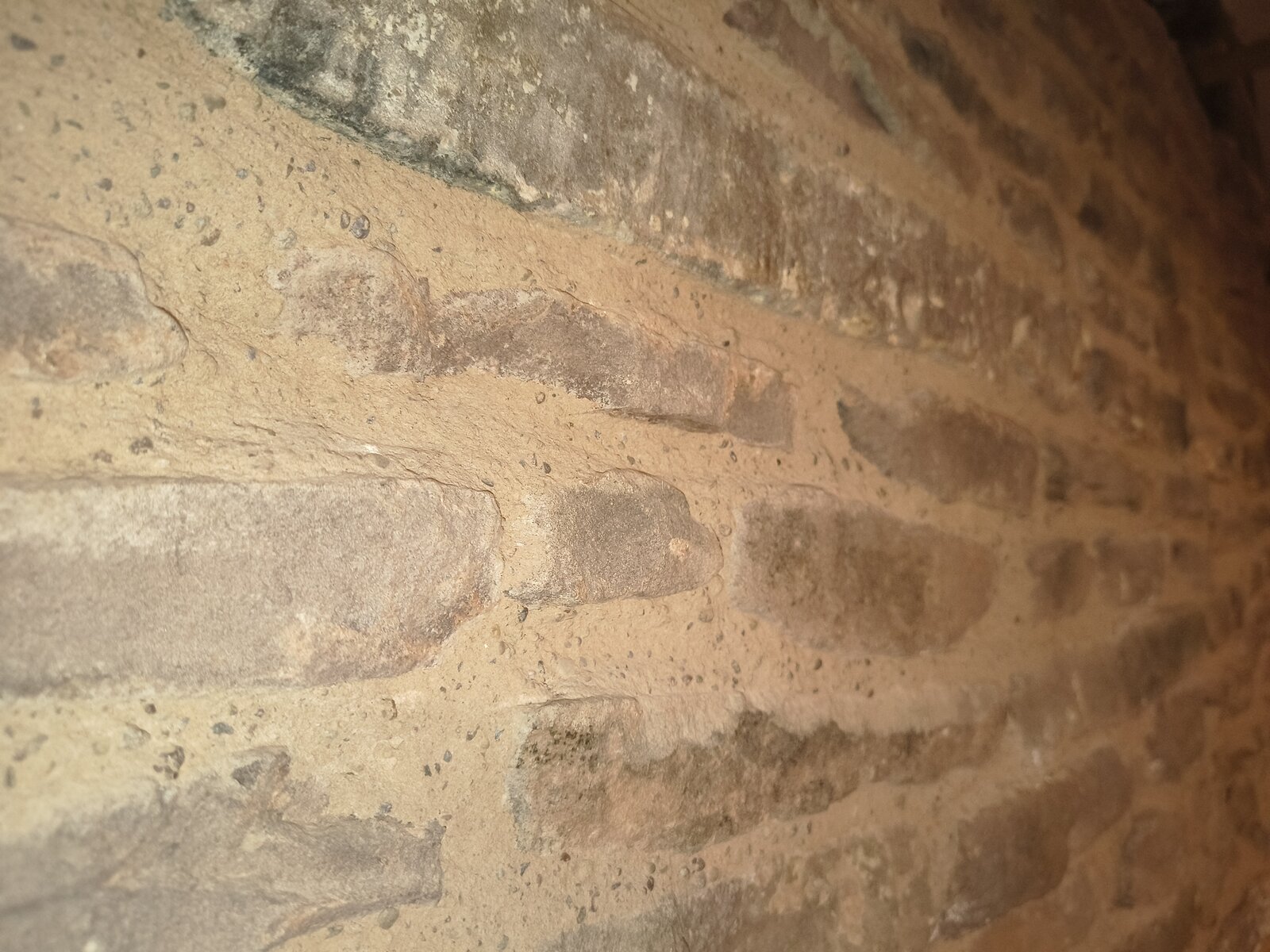

Mortar gun needs wet mix to go through so as it lime will tend to get shrinkage cracks as it dries.yeah not looking forward to that part, I bought a mortar gun to see if that makes it easier.
I want a flush point so is that still achievable the way you advise?Mortar gun needs wet mix to go through so as it lime will tend to get shrinkage cracks as it dries.
I would use a course drier mix with a narrow finger towel and beat it back with a stiff brush before it gone off too much
Yes, as you hit it with the brush it grinds the surface down so you only tap it lightly .I want a flush point so is that still achievable the way you advise?
that is the finish that I am after.Yes, as you hit it with the brush it grinds the surface down so you only tap it lightly .
I don't know the finish your after but old lime pointing has little course bits in it and tapping exposes them on the surface.
I don't know your location but traditional building material suppliers selling bagged pointing mortar in the colour and texture of your area. Ty Mawr lime is ours but further East is Mike Wye.
Mine slightly below the surface in places but natural stone has a pretty uneven surface
