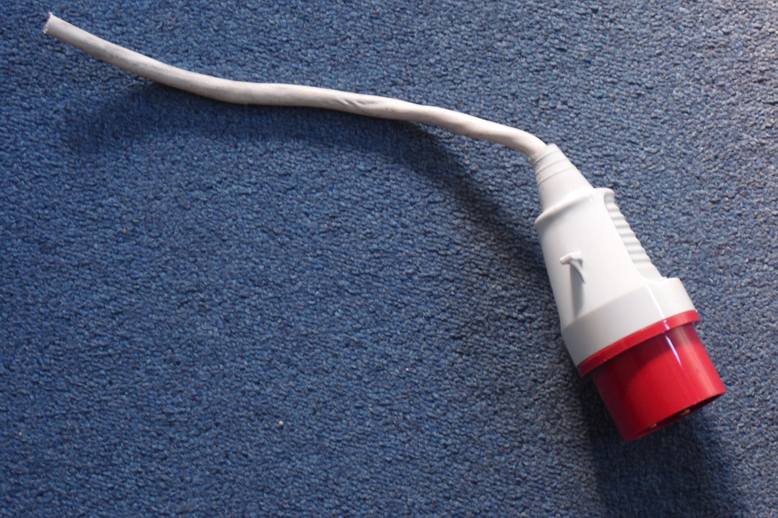

My gripe is the undersize cable installed by ignorant know-it-alls which again is something I've had the task of putting right on far too many ocassions, especially in the mobile catering industry.
One of MY 'old chestnuts':
dsci0492-jpg.149171
As it happens this was the widow maker lead to be connected to the catering trailer, but that's a different thread title.
