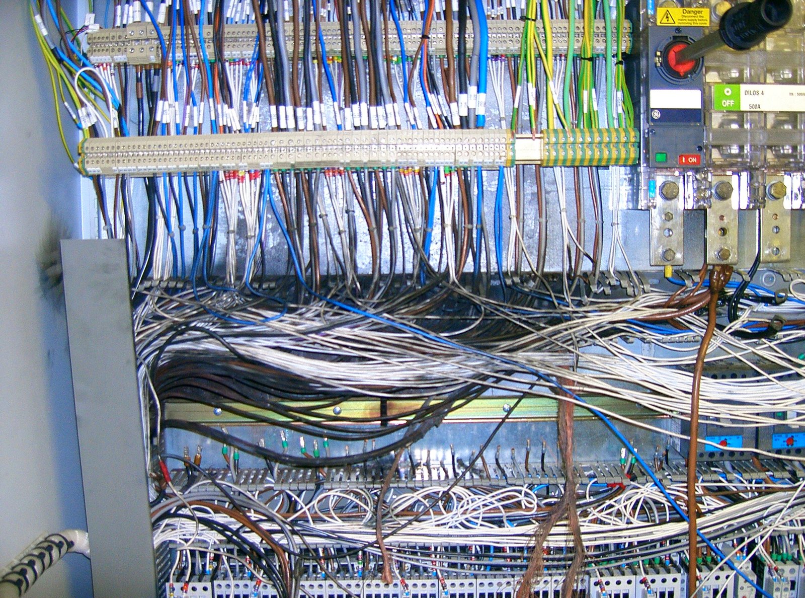

The question of increasing wire size is a double edged sword, yes it costs, yes it's heavier, yes it takes space. Yes it reduces heat dissipation.
Again a lot of my work is control panels and having 200 wires in a trunking is quite normal. The derating factor figures for tri rated wire go as far as bunches of 12, example at 45°C 0.5mm² is rated at single; 11A/ bunch of 12; 4A , 1mm² as 17A/8A and 2.5mm² as 30A/17A.
I don't know if you can make out much in this picture but that burn out was 16mm² ring of Tri rated (100A/56A) which was estimated to have been running (by the panel manufacturer) within the CCC, as it happens on Chrstmas day and having been in service <2 months.
k2-2-jpg.135932
They wriggled and wriggled but my Report was eventually enough for the various insurance companies to accept is was a manufacturers error.
IIRC that is a 300 A supply.
