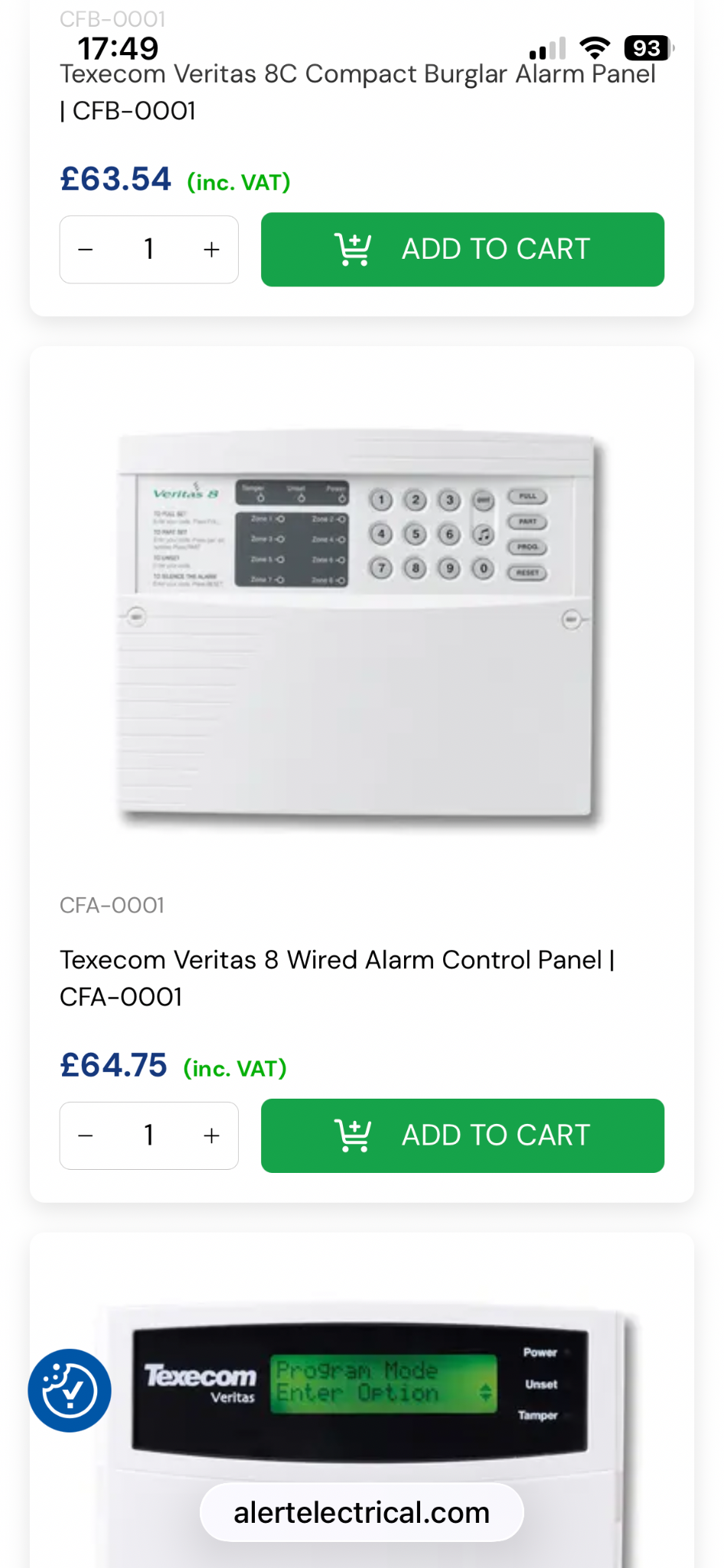

You don’t have much choice anymore ….texecom Veritas , the full size is better than the compact version as you can fit a larger battery , have you checked the internal speaker ? If it’s blown then you won’t get any bleeps from the keypad
Rough cost ( alert electrical )

I decided to power down the system and while dis-arming the bell-box I could here the internal sounder going, The panel had reverted to factory settings and was functional. I programmed as normal and the system now seems to be operating ok. Can only assume, for some unknown reason, the microprocessor had "locked up".
