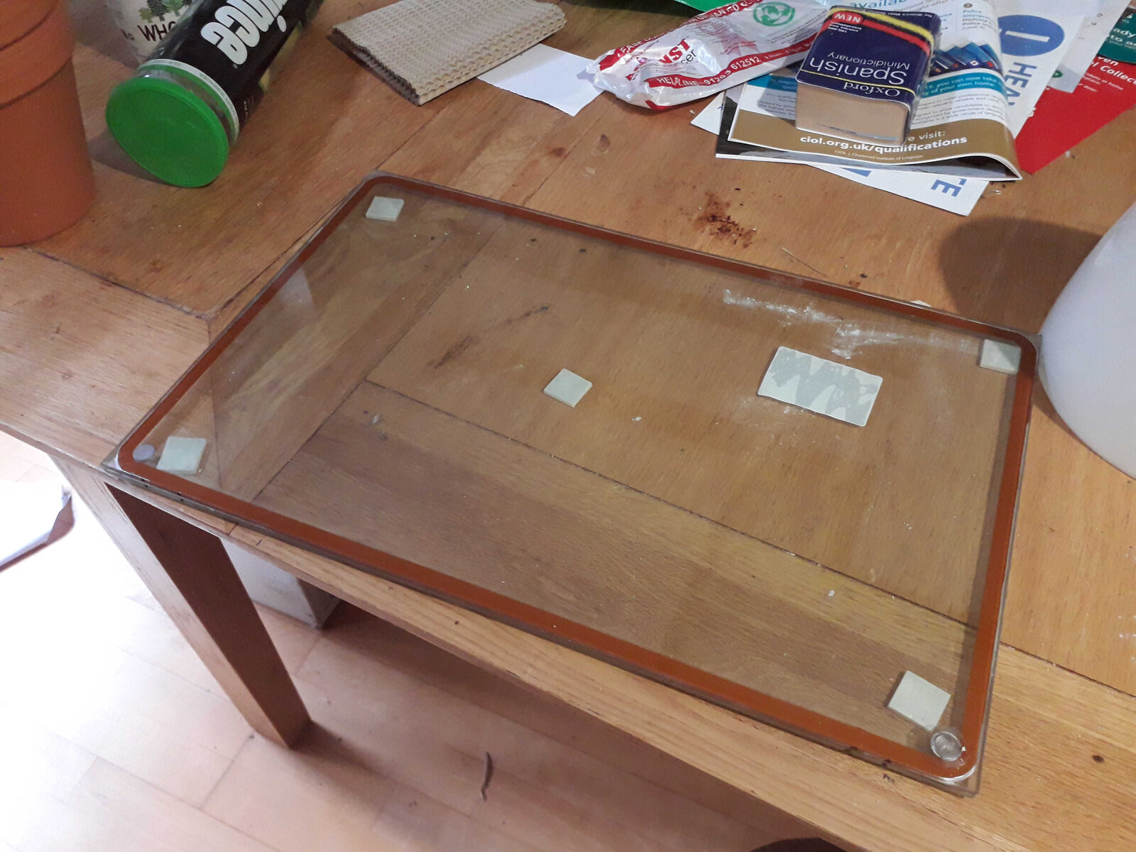

The other con is the "plugs" and "edging". The agent who deals with LandVac sales in the UK didn't tell me about this, and you don't see this on LandVac's marketing videos. But right round the inner edges of the panes there is this rather ugly brown lining/edging. Fortunately this won't be visible when my panes are installed in the frames. However, there are also two "plugs", i.e. little round things, further in from the edge along one edge. These will not be possible to conceal with the current batch. However, I calculate that with the future batches I may be able to arrange things so that these plugs will also be concealed "by the woodwork", i.e. by ordering panes which are slightly longer, and by removing more wood, particularly from the wider batten at the bottom of the casement sash.
See the attached photo. NB the white squares are a small part of the protective packaging in which these panes were delivered. This pane measures 280 x 450 mm ... and the "plugs" which you can see at the bottom right and left corners are 6 mm in diameter. The brown lines, as I say, won't be visible when the pane is installed. I was actually quite amused by the horrified reaction of some people in another forum when they saw this. But it's to be expected that these panes actually need some fairly serious engineering if the vacuum is to be maintained for years. I think LandVac's marketing should be a bit more transparent though.
Some of their competitors do mention it, i.e. they say that their competing vacuum products don’t have ugly “plugs”. Did you consider Fineo?
I did look at the competitors before committing.
LandVac seemed the clear winner. Fineo as I recall seems to have some sort of marks in a grid all across the pane: not very noticeable, but there. Also from the specs point of view it just wasn't as good.
