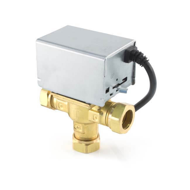

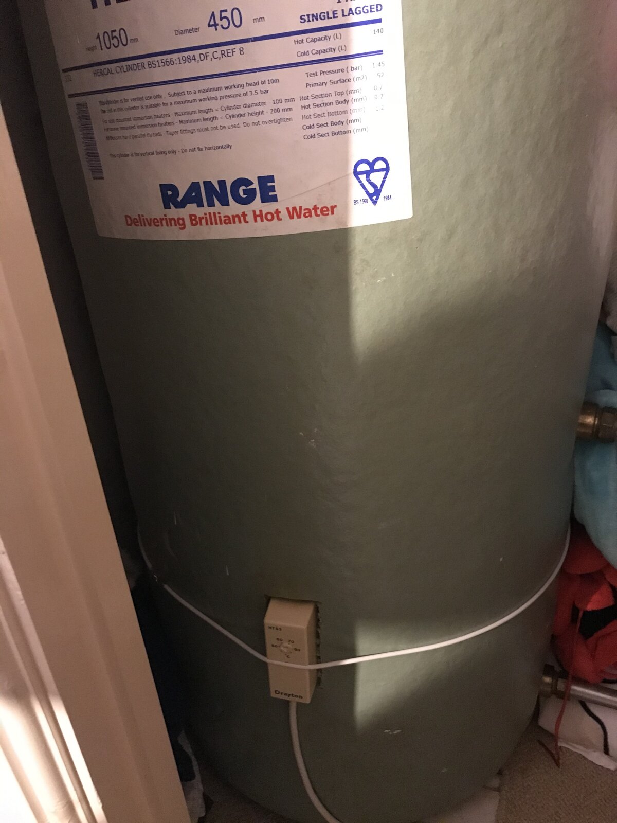

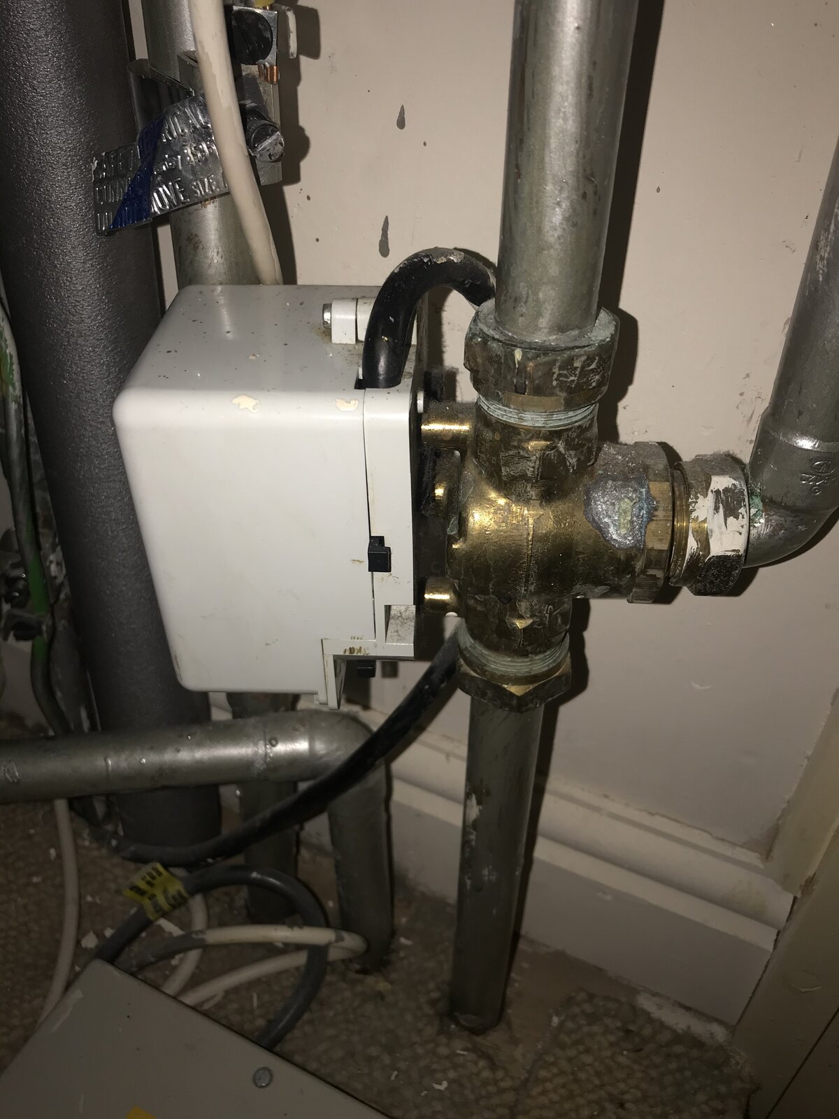

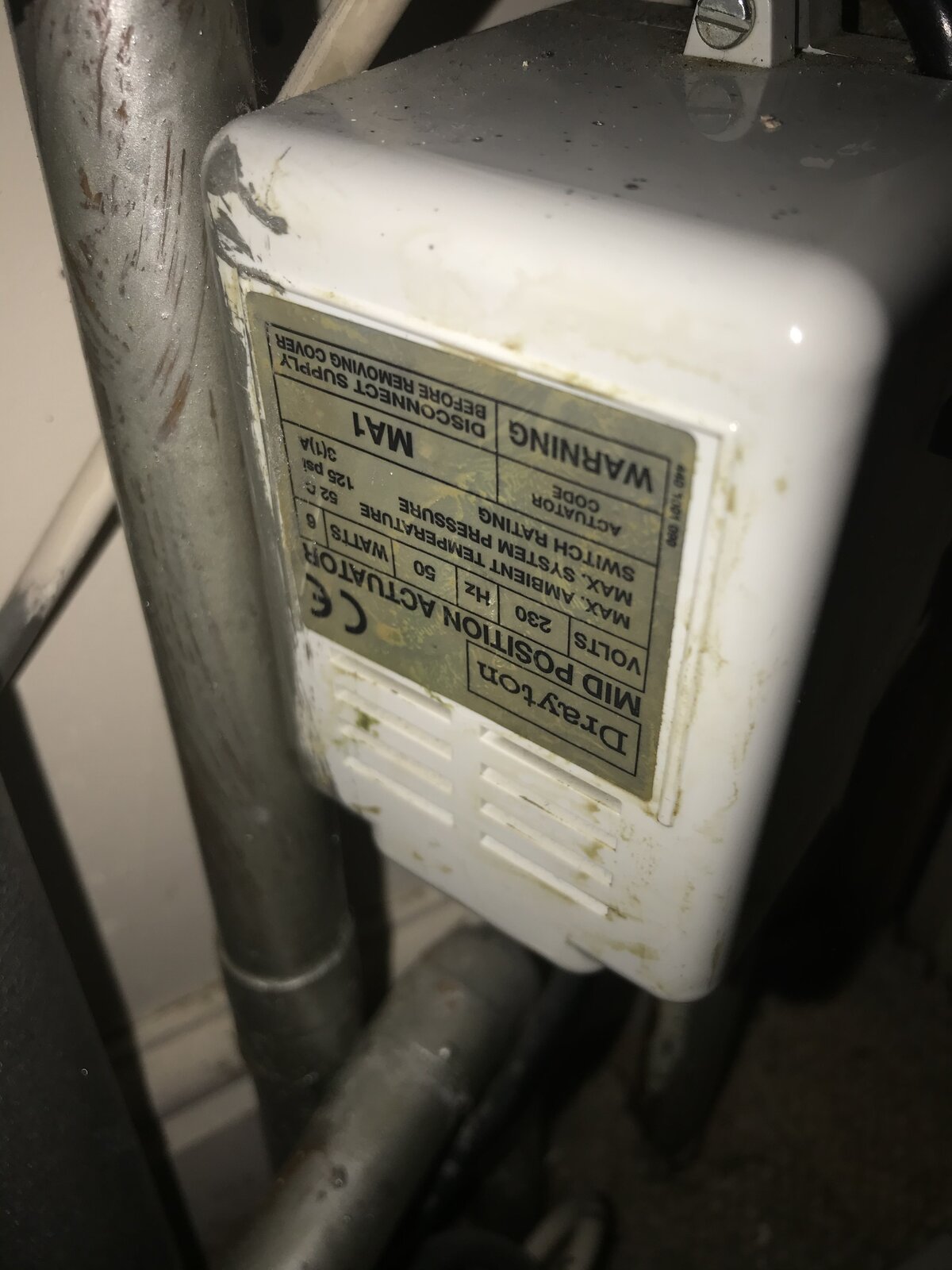

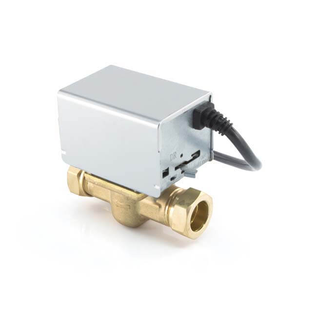

Turn off the HW, just leave the CH on at the programmer. Repeat test by turning off all hot rads. Does boiler continue to fire? Picture of HW cylinder would help, particularly of any Motorised Valves you may have.

Here’s some pics
Did these ever work? Is it a new fault? Have you checked they have water in them?
Yeah the boiler continued to fire when the hot water was turned off.
Right, that means the heated water from the boiler is going somewhere around the system. If the Rads known to be working were off, then it has to be going somewhere, my guess at them moment would be, the 3 way valve is letting by and some flow is going through the cylinder. Repeat the test, then check the pipe going upwards from the 3 way valve, does it get ridiculously hot when the boiler kicks in? (Also, does the Hot Water at the taps seem exceptionally hot? Would also point towards this issue.)
