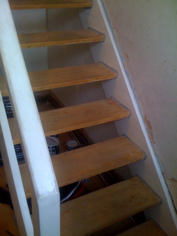

Hi All,
I have these open backed stairs which I think are pine (if anyone can see differently please advise).
Im having a dark (espresso) wood floor put in downstairs and I decided I wanted to dye the stair treads the same colour as the floor.
However my research on wood dye seems to say to me that it might end up a blotchy mess with pine.. so can anyone advise what to do.
Im thinking...
either dye the treads then wax
or use a coloured oil / danish / tung.
or something better (not carpet)
Rich
Hi Richiedc
Osmo do a range of coloured wax/oils from white to black and are available in tester pots so you can trial them. It's a quality product aswell. Just google "osmo".. beware though, the oak tones don't bear well on pine but the dark tones do!!
Mac
they remind me a bit of elbow patches on my old school headmaster!!!
Ill go for the coloured oils, thanks all
