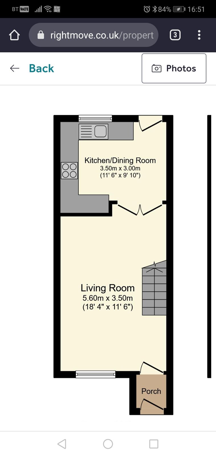

Just looking for a bit of advice. I just moved into my end terrace, it has an open plan livingroom with an open staircase. I replaced both old storage heaters in the living room and kitchen. The issue is keeping heat in. I have just had the windows/doors replaced and thought this would help. To a major extent it has, as the house was so bitterly cold. However the livingroom is still pretty cold and unless i leave my new electric radiator on all day at full power, it takes ages to heat. I am all electric, no gas.
My new radiator is 2000w and the doors to the kitchen are kept closed.
Livingroom layout, - 5.6 x 3.5 metres attached layout.
Just to see if it would be worth getting another radiator and keeping it at the other side of the living room, my main one is on the wall at the porch door but at the bottom of the stairs. I dont know if it would be more effective having one at each side rather than one full power struggling to heat.
Any help would be appreciated :)

Thank you for the reply.
I used the online calculator for the radiator and it says that one should heat 24.5 square but this doesnt take into account the open staircase. (my room is only 19.5 and i have a separate radiator in my kitchen as there are doors to separate it)
Sadly my full estate is electric and no gas, but ill maybe try your advice and see if it makes a difference.
You say it is open plan. All the warm air will naturally rise up the stairwell to warm the spiders on the landing ceiling.
Try to prevent cold air being sucked into the downstairs rooms to replace it. Draughts will come through the floor and under the skirting boards, and round doors and windows.
The further from the stairwell you put your heaters, the more heat will stay downstairs, but it is a losing battle.
I'm also afraid I made an assumption about your house being a terrace.... and old!
Is it a relatively new-build with decent draught proofing and insulation?
1986ish it was built, ive just had all triple glazing, new doors and porch replaced. It seems a sturdy house, my main issue i think is the pesky staircase, however i dont want to close it off as its a small living room and might make it seem closed off.
