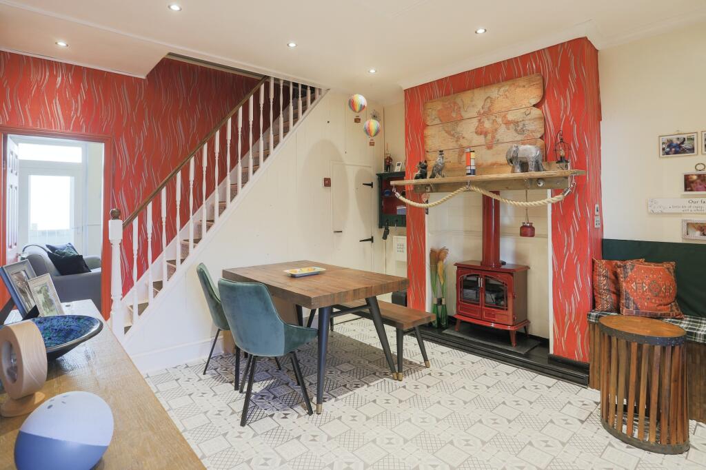

Can anyone advise me on the rules for having an open stairway in a room which contains a log burner. We currently live in 2 bed terraced house and want to open up the stairs. Does this follow regs? Would we have to install fire doors/escape windows in the bedrooms upstairs? The picture attached is how it would look for reference.

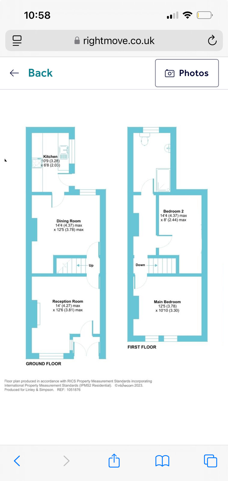

What age is the property? Escape windows would be required for all habitable rooms (including ground floor) but no fire doors, care to post an existing plan (estate agent plan will do)? What age is the property?

Thank you for your help. It's early 1900s. Plan is below.

The enhance requirements - mainly protected escape routes, additional escape routes, compartmentation and warning and detection kick in for three storeys and above
This is a two storey house. Escape windows apply to two storey houses where there is no protected escape route.
It wouldn't need to comply with current regs, but I would have thought that it is not permissible to undertake any work which makes the current situation with regard to fire safety and means of escape any worse.
Yes, 2-storey can have open plan but normally with escape windows upstairs. If the upstairs windows just have top-openers, then making it open plan is making the means of escape situation worse.
Making things technically worse, does not automatically mean the situation becomes non-compliant worse, it just means it is different.
