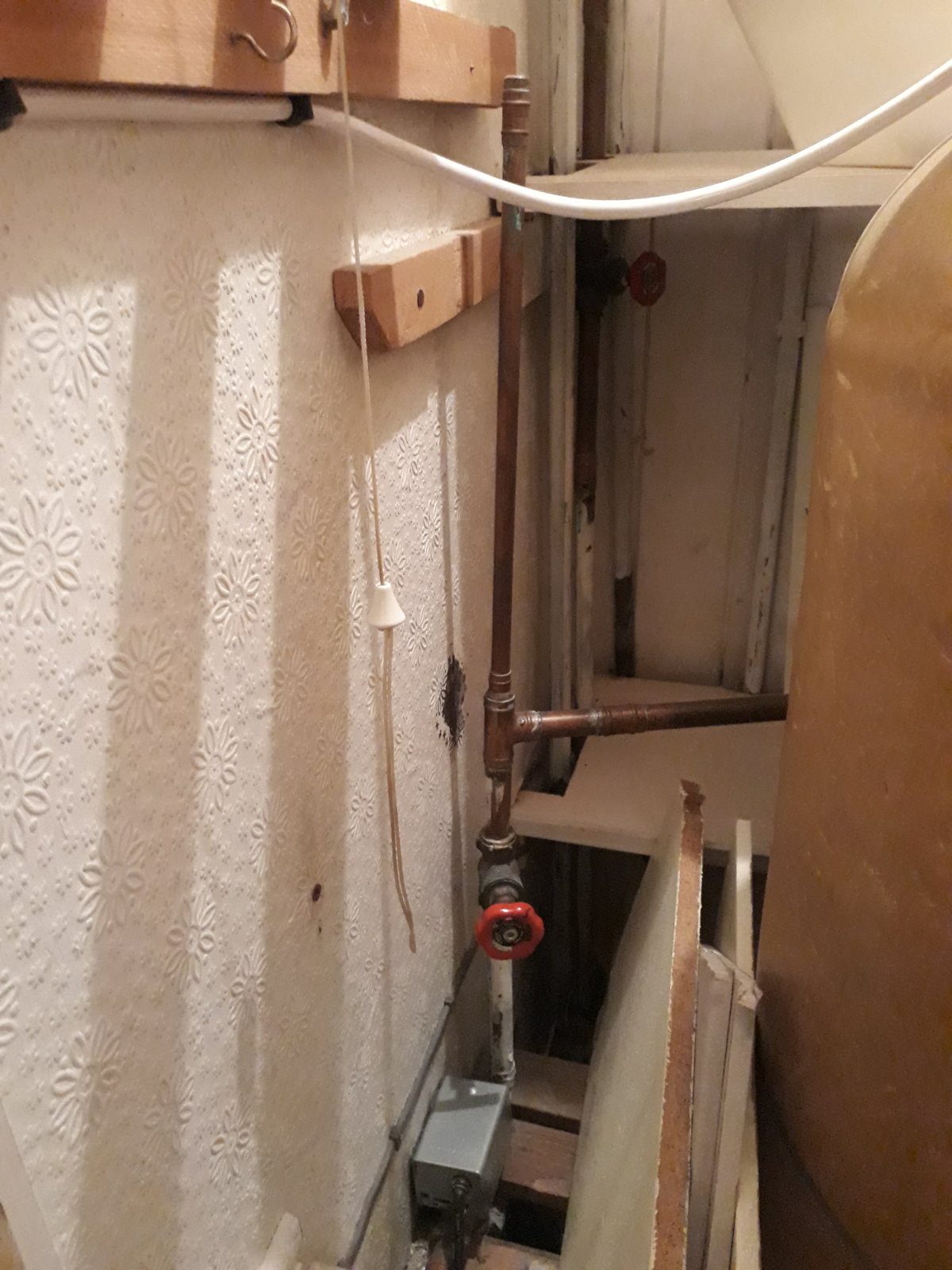

Late update..... Solved! for the most part!
It was the filter!
I opened the flush valve on the filter and it dribbled at first....and then it something seemed to happen and it became a torrent. I was ready with a bucket.
The only issue I have left to solve is why there is no water coming through the drain cock at the bottom of the hot water cylinder. I assume there must be an airlock in the coil?
Any suggestions for that one? Hose on it and blow? Or hose pipe and force fill?
P.S My filter additions and moved and re-plumbed radiators.....no leaks! Thus far anyway....we shall see once there is a bit of pump pressure.
