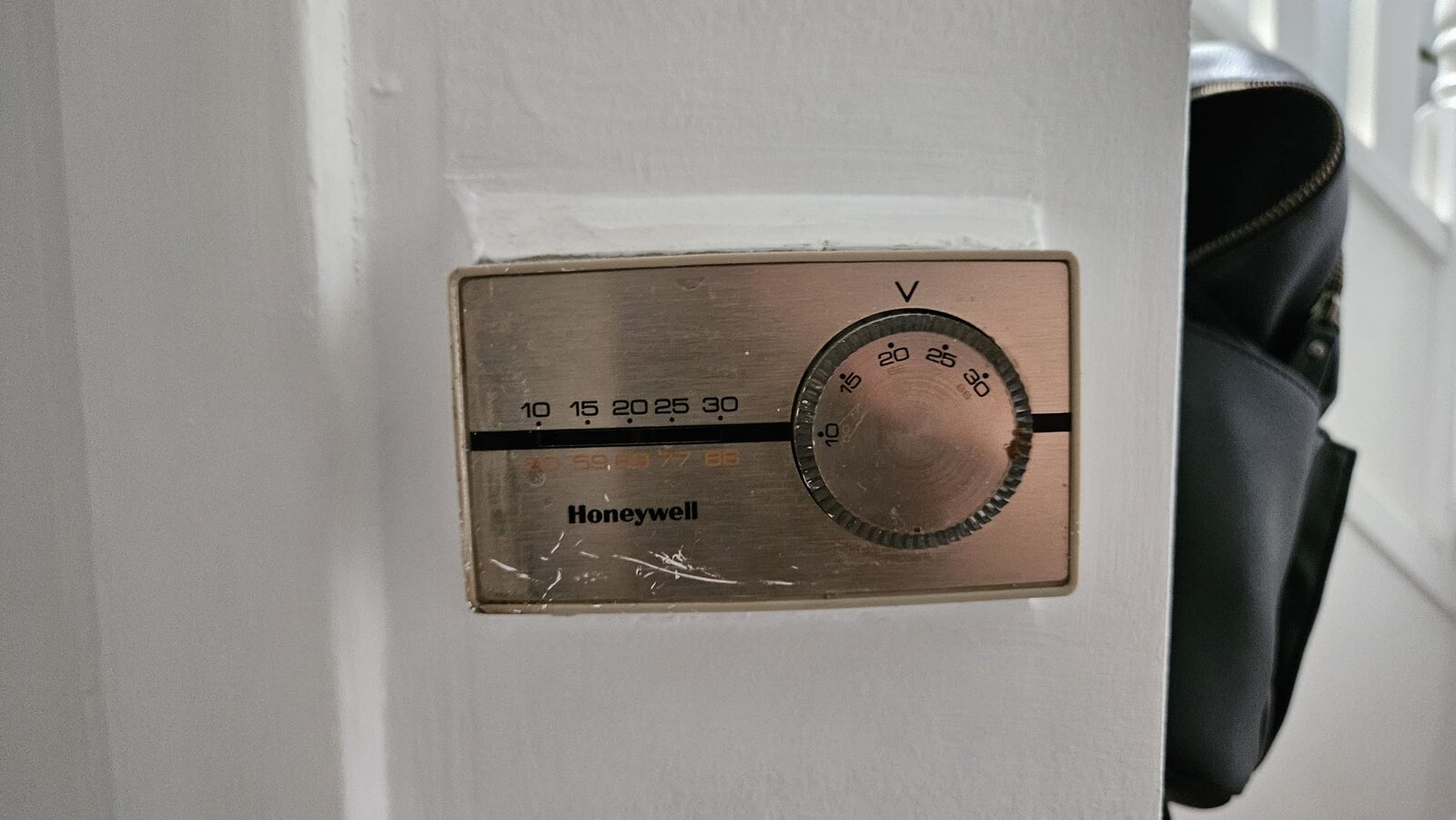

Hi @Johntheo5, Thanks for your comment.
I was referring to the 3 port valve there.
I am new in this house - moved in 1 year ago.
The only other component that looked like room stat (I always thought is not functioning as assumed not powered and a leftover from previous system) is this one attached in the hallway.
Could this play a role in it?

It most certainly could and should. Open up (to 5) a few rad TRVs, turn that roomstat down to 10C, boost or programme CH only ON, check that pump/boiler not on, turn up the roomstat until it cliks on, check pump/boiler running.

I did that test and yes the roomstat turns off the boiler if TRVs set to 5 and I turn the room stat down to 10C. I then turned it up to 22C again and the boiler switched on. After that I had to turn the TRV down to 0 from 5 and again to 5 and observed the boiler firing again. I checked the CH pump after the test and it was showing 19W (I listened to your advise and change it to CCII which seems to be working fine for now).
