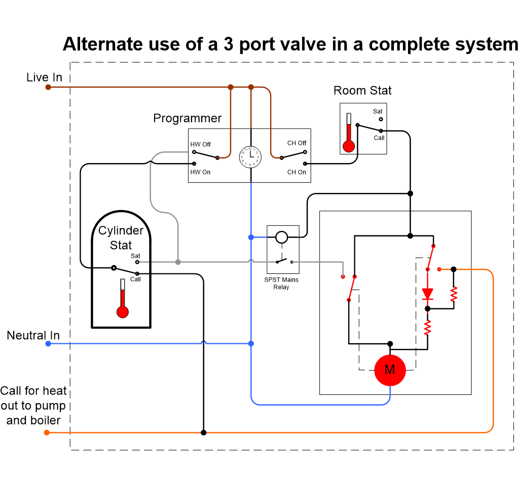

Apologies @fandyman I completely missed this. There is a great difference between Y and S plans - for every 2 port valve I replace (good qual valve) I replace maybe 3x3 ports. By their very nature 3 port valves burn themselves out much faster than 2 port valves do as they can be powered constantly depending on what was the final call for heat. I have S plan systems that have never had their valves replaced (honeywell), can't say the same about the Y plans - every Y plan I look after (where they haven't been converted) has had the actuator replaced.
Wonder why the MPV makers didn't just use a additional £10 relay to give a guaranteed unpowered (HW) last port of call and a very long MPV life, no good for their balance sheets though.
Indeed - It didn't really seem to make sense to invent a convoluted but never the less very clever process to ensure the valve performed the way they wanted depending on what permutation the system was at but as you suggest there must have been a longer term financial servicing factor involved whereby the actuator failure was almost guaranteed and would require replacement.
They did solve it, with a MOMO type 3-port valve, which only moves position, when called to move, the rest of the time, it sits unpowered.
