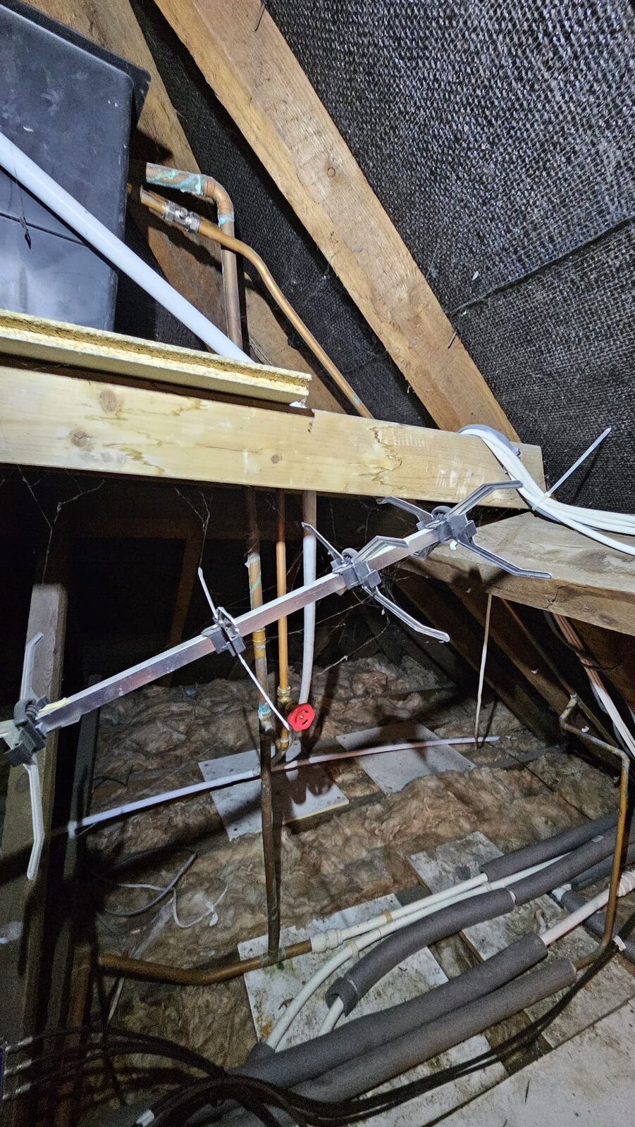

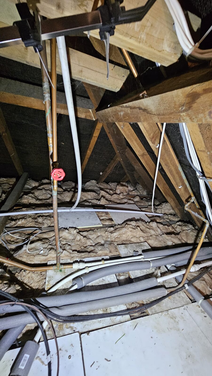

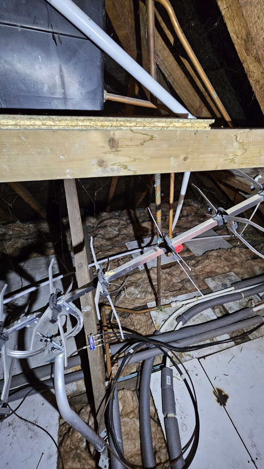

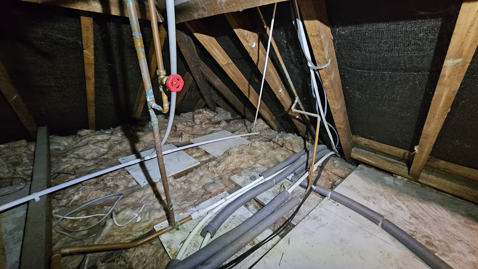

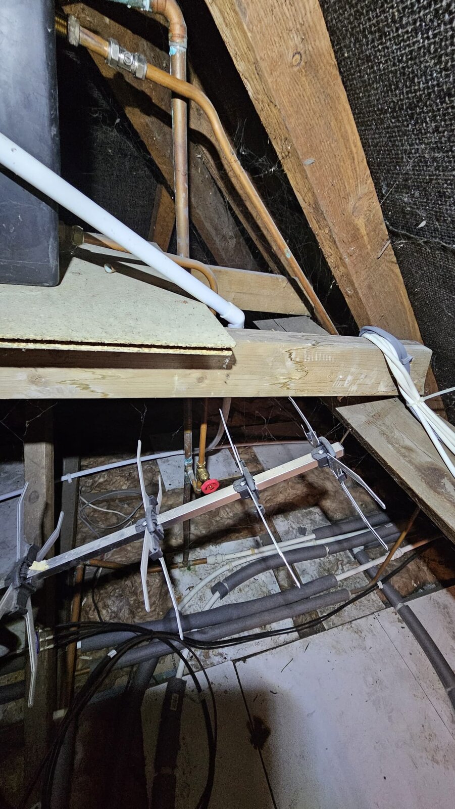

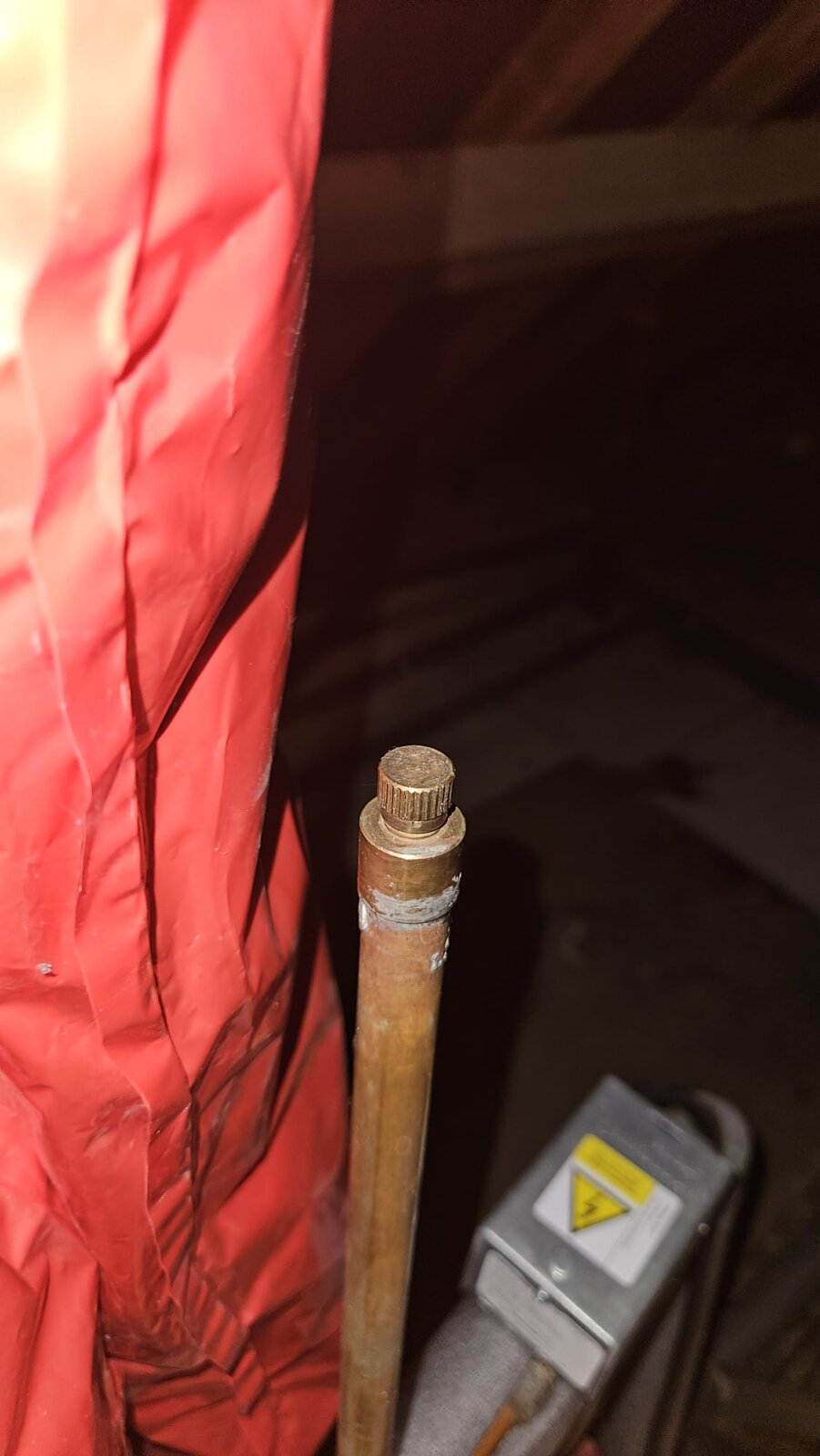

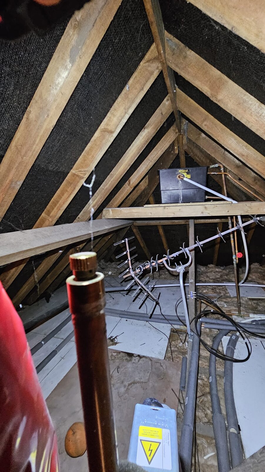

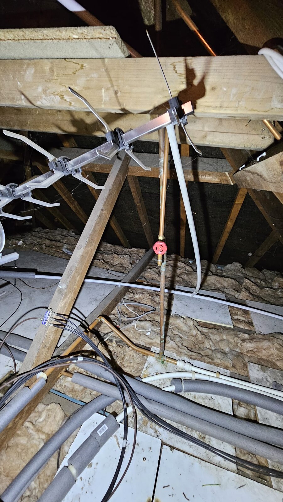

Show us a pic of the pipework around the pump and the feed to it from the loft.
Do you have a strong magnet ?
Have you checked all radiators are full of water ,bled any air out recently?
See attached

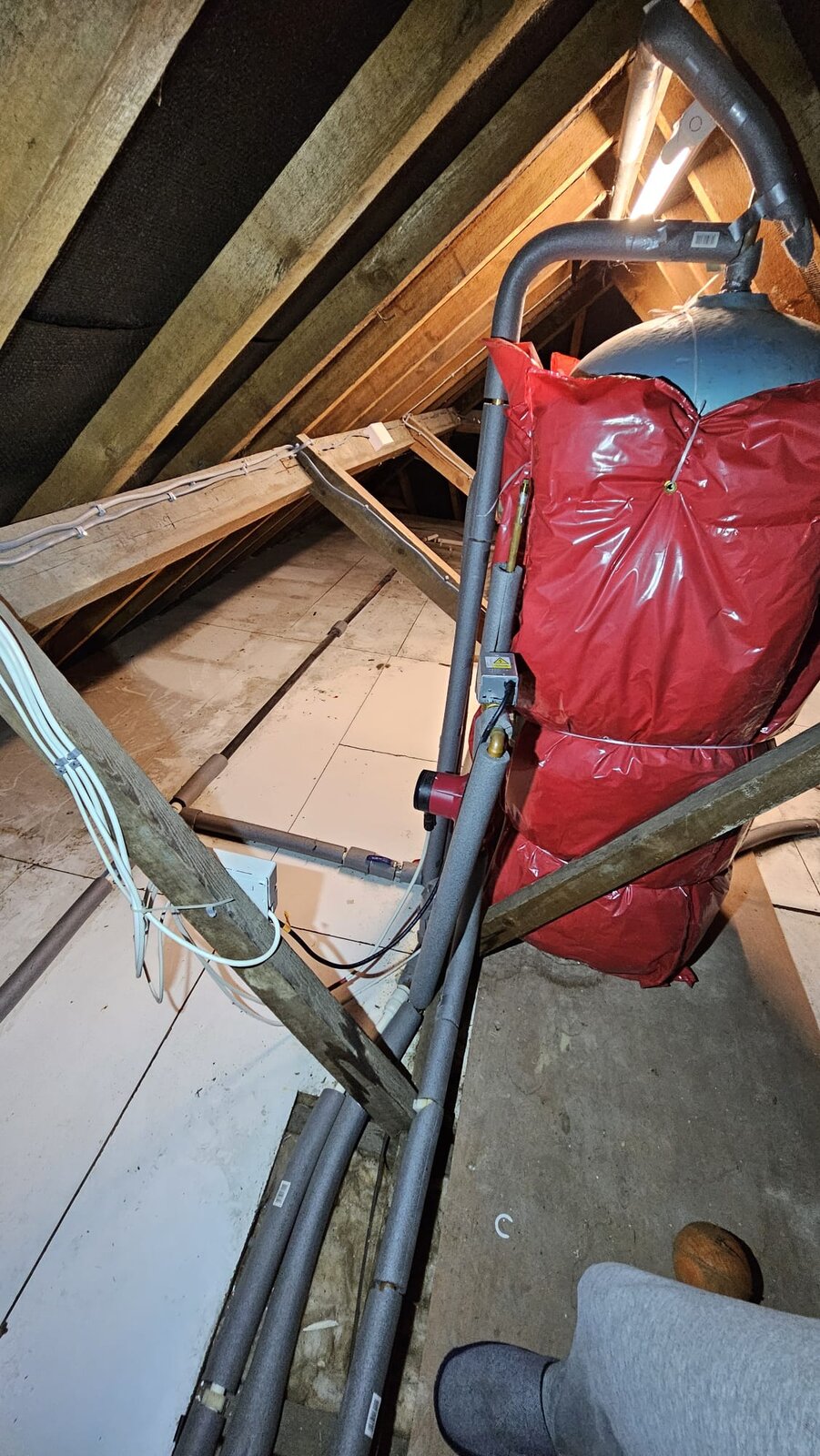

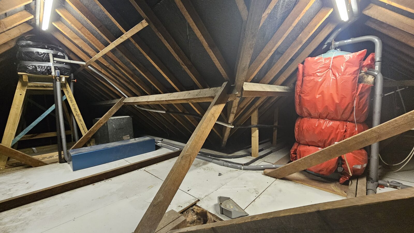

Sorry ,I can't make out from your pics where the F&E cistern is. That large black tank looks more like the cold water cistern feeding the hot water cylinder ??
The black tank is indeed the F&E cistern/tank.
There is another large tank/cistern on the other side of the loft (on the left on the below picture).
I have a magnet but not strong I suppose no. Where can I get one from?
Amazon maybe.
You need to follow the outlet pipe at the bottom of the F&E , paying attention to the first Tee ,and any elbows. If there is a blockage on that pipe run the magnet will be attracted to the pipe .
