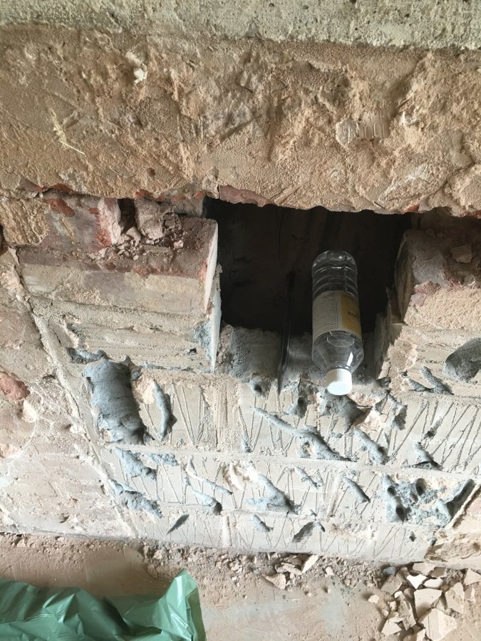

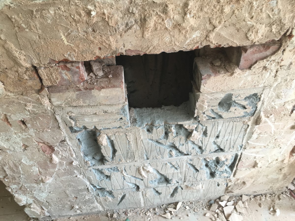

In our new property I wanted to open the chimney breast, so I can put a nice stove in it. However when knocking a few bricks out I only found a black flue(I think) so no depth!
Is this right? Attached pictures

How old is the house?
How far does the chimneybreast stick out of the wall?

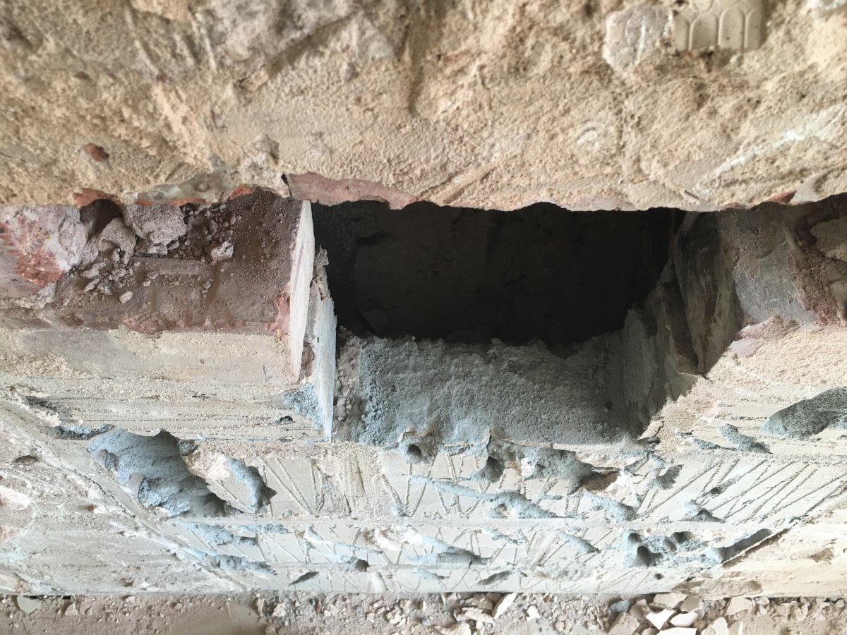

Poke your camera through the hole and take a shot looking upwards. Out your hand in for scale.
Is there a concrete pad in front of the chimneybreast?
House in a large 1962 semi.
I got a bottle of white spirit to show you scale
Yes there's a concrete lintal just above the 2 bricks you see.
It's a black angled tunnel.
It's 30cm out of the wall.

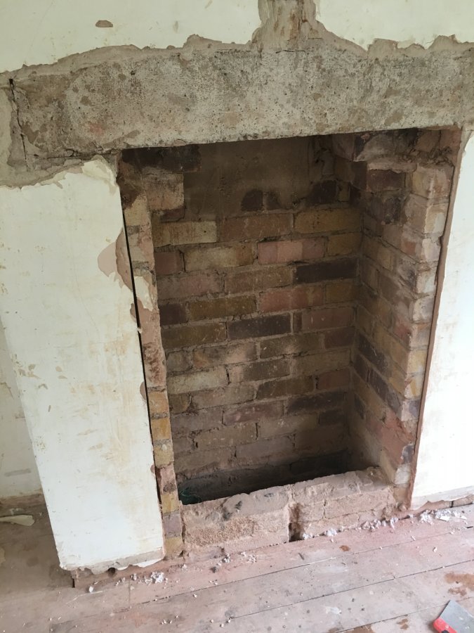

We do have another chimney breast which is not linked the chimney. And the opening of that was totally different(see pic)
