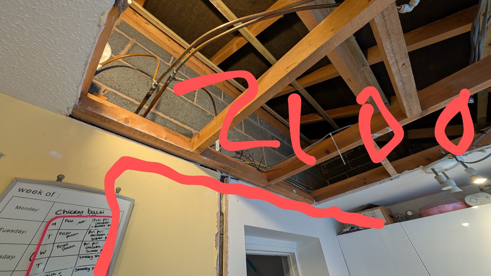

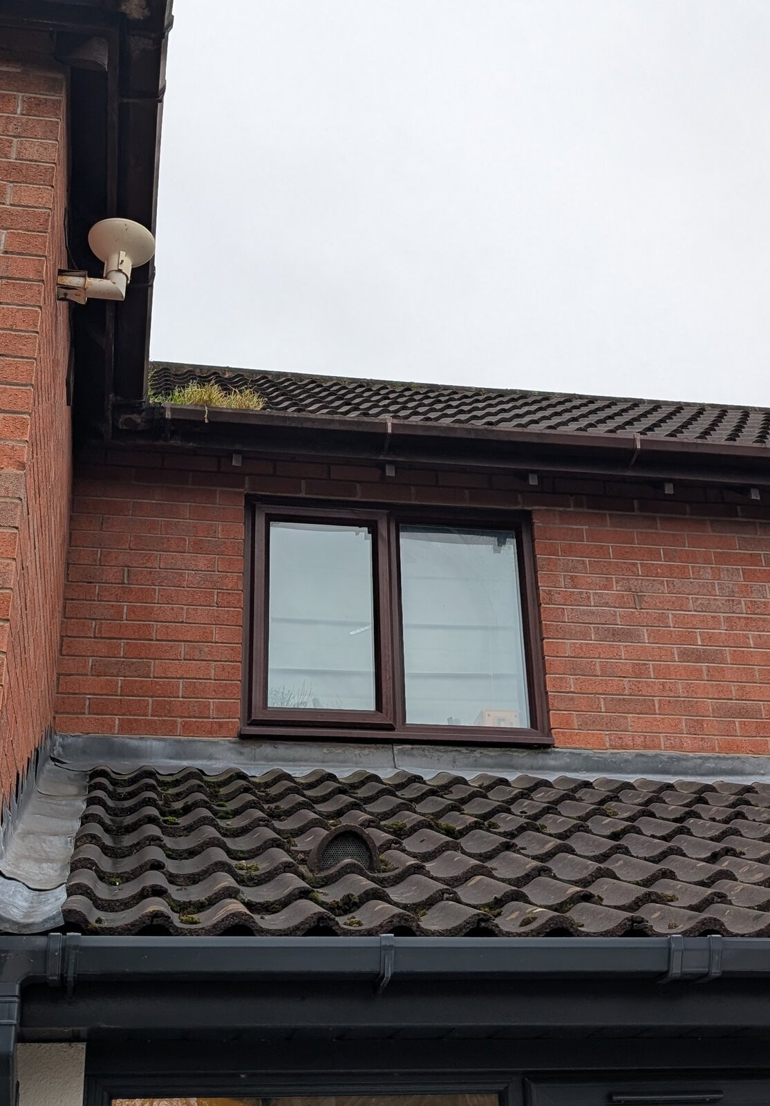

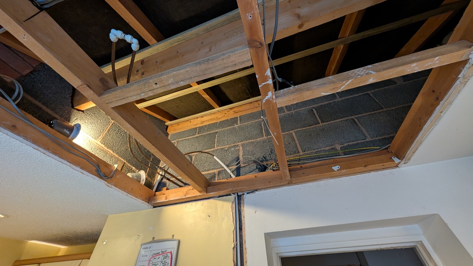

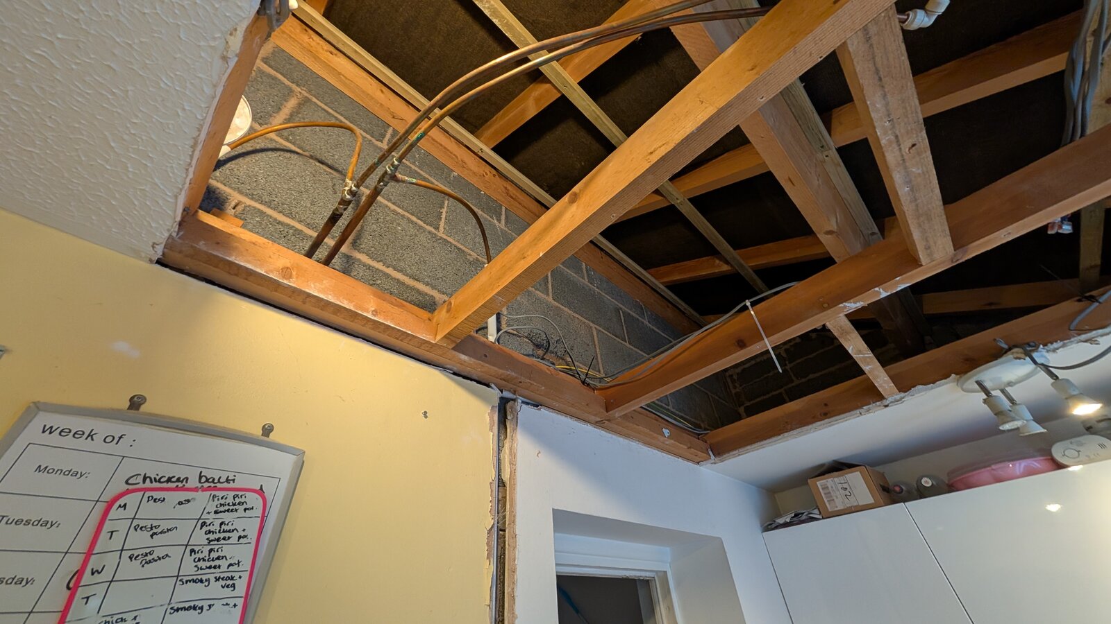

Hi
Was wondering if any builders might give me a clue on the process and rough cost on opening up this doorway?
The wall supports an externally wall, the beams run parallel to the wall for the upper bedroom just behind the wall.
Will it require a lintel or RSJ?

Sorry, I’m not the right person to answer your actual question. You want to widen the opening, right? Yes I think this will involve inserting a beam of some sort. Assuming it’s a cavity wall, you need an arrangement to support both outer an inner leaves while not forming a cold bridge. An expert will be along in a minute…

The wall adjacent seems to be doing a bit of work, i.e. supports the roof purlin etc. What supports this wall? Is there a beam under it? There may be a padstone behind the plaster, just above that menu/planner.
