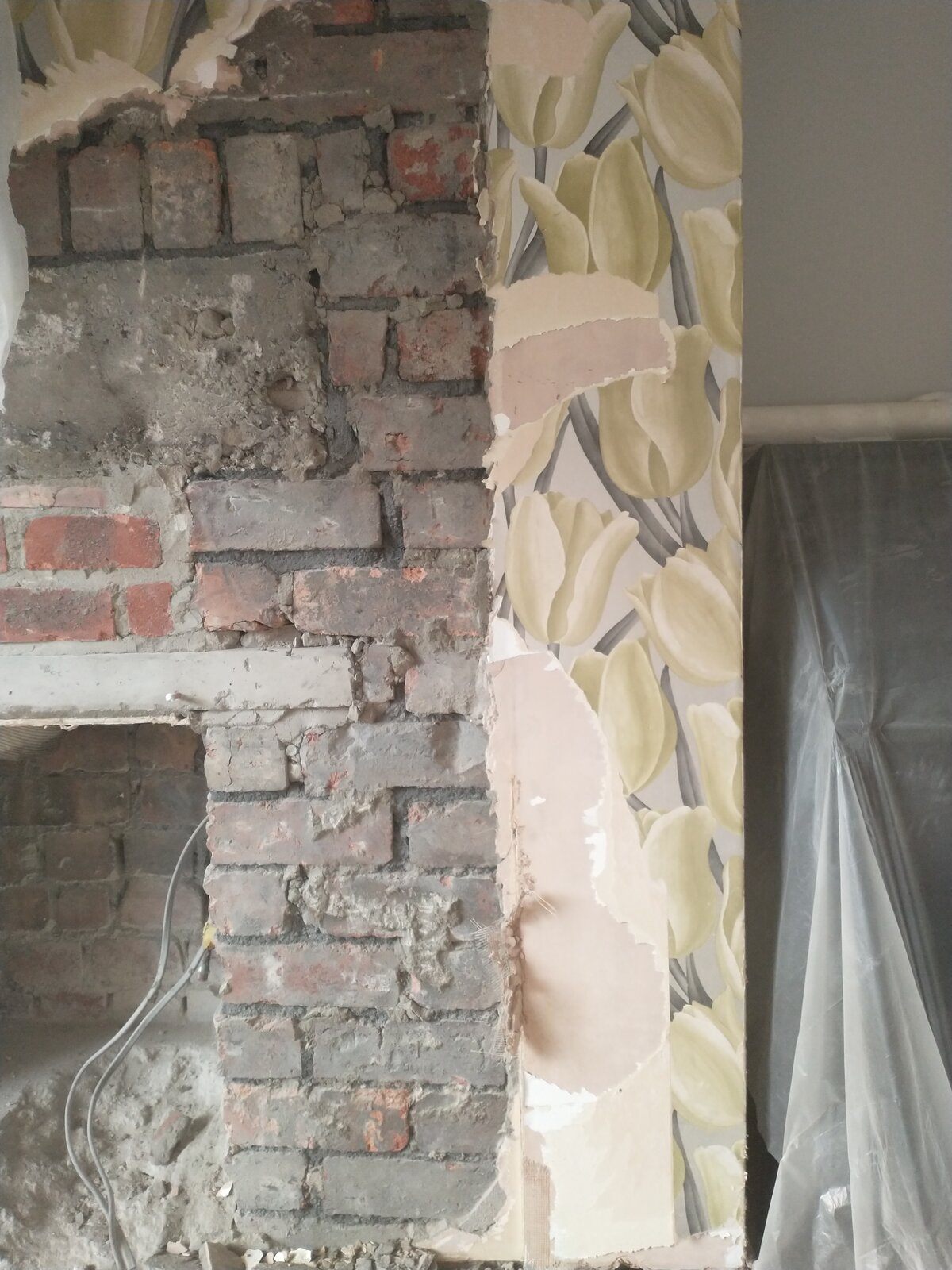

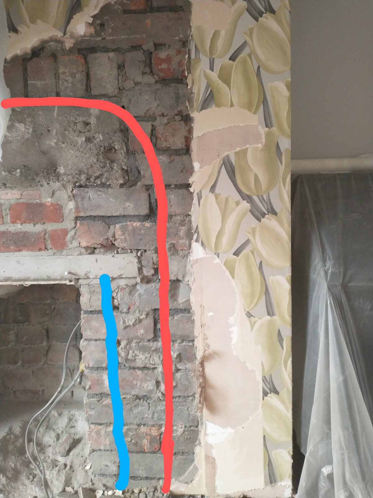

Ok, a bit more hacking away has, I think, revealed where the original arch was, can you check the picture and tell me if I'm right or deluding myself?
I've marked in red what I'm hoping is the supporting structure and marked in blue where I want to extend the fireplace to. Does this seem reasonable?

Oh that's a bit disappointing. Looking at that pic (especially the brickwork above the new lintel that you've exposed) it looks to me as though the right-hand return is actually original and brick and a half rather than brick. The soldier course above your red line looks a bit flat to be capable of taking any load on its own (unless there's a lump of steel hidden under there that we can't see). Just below the red line- is that the remains of plaster yet to be hacked off or is it a lump of concrete?
It's a big lump of concrete, this isn't sounding good , just 4 inches away from succeeding
Indeed not. Chopping out that half course (your blue line) would leave the new lintel and that large blob of concrete (and probably the rest of the front of the chimney) not particularly well supported, as well as removing support from the right-hand wall (if you peer up the chimney you'll probably see some corbelling starting about the height of that soldier course- thats being supported by that uncommonly beefy side return).
So, options.
You might still find an arch above that soldier course but I'd be surprised, those soldiers on edge look to me as if they were a finishing edge.
To do your planned opening up is going to be a lot more engineering without an arch in place.
I'm a bit suspicious of that lump of concrete- as it is (supported by new lintel) it's fine, not sure how much load it would take if you removed the new lintel.
Have you got a magnet you can wave around that soldier course and concrete lump (see if there's any metal in either).
If the plaster isn't being a pig to remove I'd be tempted to keep going upwards just on the off chance that there's some structure further up...or you could just cover it up and forget the whole plan cos your original little job is turning into quite a big one
Tried with a magnet, either it's not strong enough or there's no metal so I'm going to forget extending the fireplace. I'm going to call a gas plumber out and see if there's a way to re-route the gas pipe that is at the top of the boxed area, if there's a way to chase out some part of the breast to route the pipes up into the ceiling space and join it up there then I can remove the boxed in section which will centralise the fireplace. It'll mean redoing the coving and some ceiling repairs afterwards but I was planning on having the ceiling plastered smooth anyway and the coving work isn't difficult.
