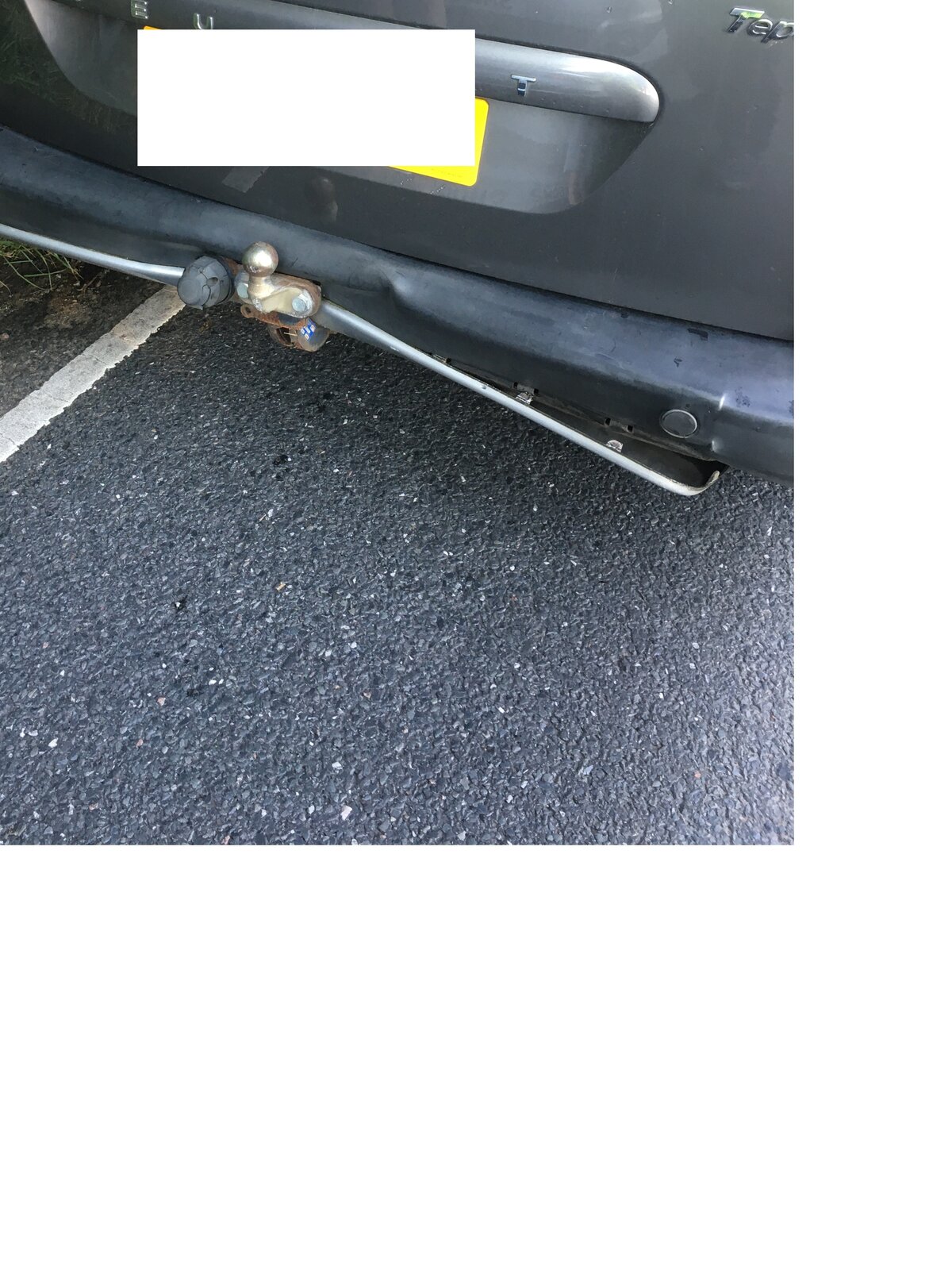

Had a rear ender yesterday and this is the damage to my car.
It's a 60 reg Peugeot Partner and was MOT'd last week.
What I want to know is if anyone considers this to be a likely write off by the insurance company. 'We buy any car' have given an online value of £3,300 but there are one or two small dints/dents elsewhere so I know they will reduce the price if they had had a look before this incident. I had a feel underneath and there feels like a thick tubular cross member that feels bent.

No need for anything hasty here regarding your insurers.....the bumper is a plastic shell with the reinforcing bar behind it. Best to remove the bumper and see if the reinforcing bar is creased, but you'll need to budget for a new bumper and paint.
An independent garage will sort you regarding the fitting and then it's off to the body shop - asking for a cash price!
'We buy any car' will offer a rock bottom price so avoid if you can.

The tow bars taken quite the knock, so it could have twisted the chassis rails where it bolts to,
Its also possible it damaged the crash structure behind the bumper.
It's a difficult one to assess, in theory it just needs to go on a jig and be pulled about and then have a new bumper and tow bar,
Sounds like the deliberately deformable crash bar. If I am right, they are easily replaceable on most vehicles.

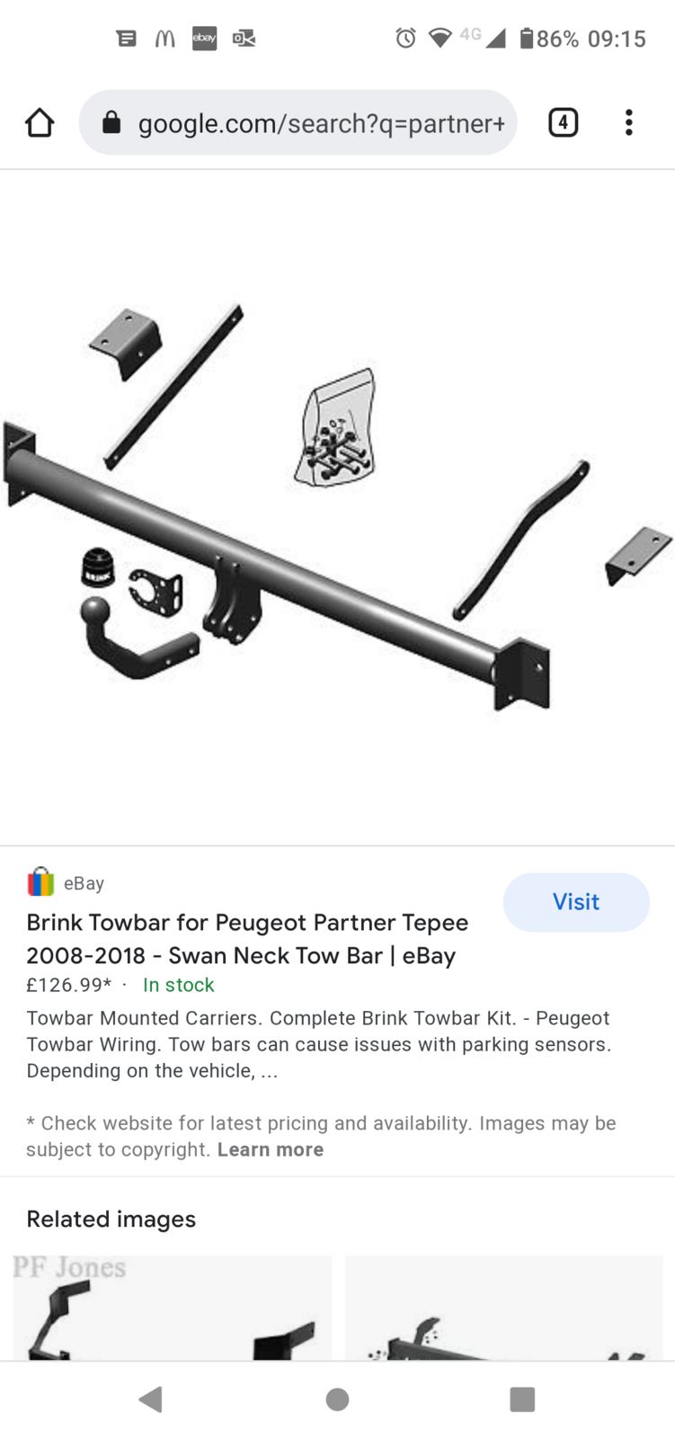

Big tube will be the towbar bracket. Insurance won't repair that but it will be a nice earner for whichever back street "repairer" gets hold of the salvage, but new owner might struggle to fit another tow bar!
It's a while and a few cars since I fitted mine but there's two big chassis rails (I know it's a monocoque chassis but it still has them) running up inside the wheel arches and they usually bolt to these, either directly to captive nuts or with some reinforcing plates. They might be a bit bent inwards with the impact.
Some people say a towbar saves your car, others say it bypasses the crumple zone and causes more structural damage.
Stick your phone camera under the car, and try to post up a few photos of the big round bar and the area around each end of it

The towbar replaces the rear crash cans and bumper reinforcement, so you need to check that the chassis hasn't been damaged. Make sure the panel gaps either side of the tailgate are even. Also, that the spare wheel carier still functions. The towbars are easy to fit, and there should be plenty of them around. The harder part is the wiring (which you already have) so if the chassis is OK, it shouldn't be much work to get a bumper and replacement towbar from a scrapper.
