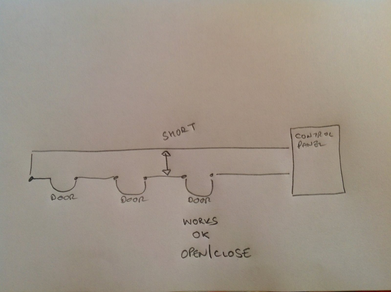

I have a strange problem I am struggling to resolve. My downstairs zone (timed & final door set) has stopped working on all but one door. In total 8 doors on the downstairs circuit are wired with door sensors but the system will only set on one of them the other 7 being comeptely ignored. It was fine a few weeks ago. If a wire was disconneceted then the system would never set but why does it do so on the one door? I have checked all the connections the best I can but the wiring is burried behind walls, floors and door casings. Behind the main box, if i recall correctly, there are some wires going into chocolate bars which is making me wonder if I have 2 circuits connected into a single zone. There is only one set going into the actual zone connection visible inside the man box. Hope I am making sense!!
Essentially my downstairs zone has worked with 8 hard wired doors for years but now only one door on the circuit is working. The other 7 are just dead as if they have no sensors connetced. I can set the alarm and leave the property no problem with just a single door on the circuit armed. I am really puzzled by this since it suggests the circuit is intact but why then does it allow me to set it with the other doors open??

Are all the 7 doors on one zone ? E.g. Zone 1 or across different zones ? Do they go from door to door or all go back to the control panel ?
Hi
Thanks for coming back to me. They are all on the same zone (zone 2) I have zone 1 for front door and zone 3 for all the upstairs doors.
The downstairs zone is all on a single wire run running in series. No return back to box. They have used telphone cable switching on the blues (both blue/white and white blue togteher) and returning on the orange. A tamper circuit is setup on the greens but i have disarmed that for now in an attempt to find the problem. I thought the fault was one of the door sensors which I have removed now and closwed teh circuit by connecting all eth blues together.

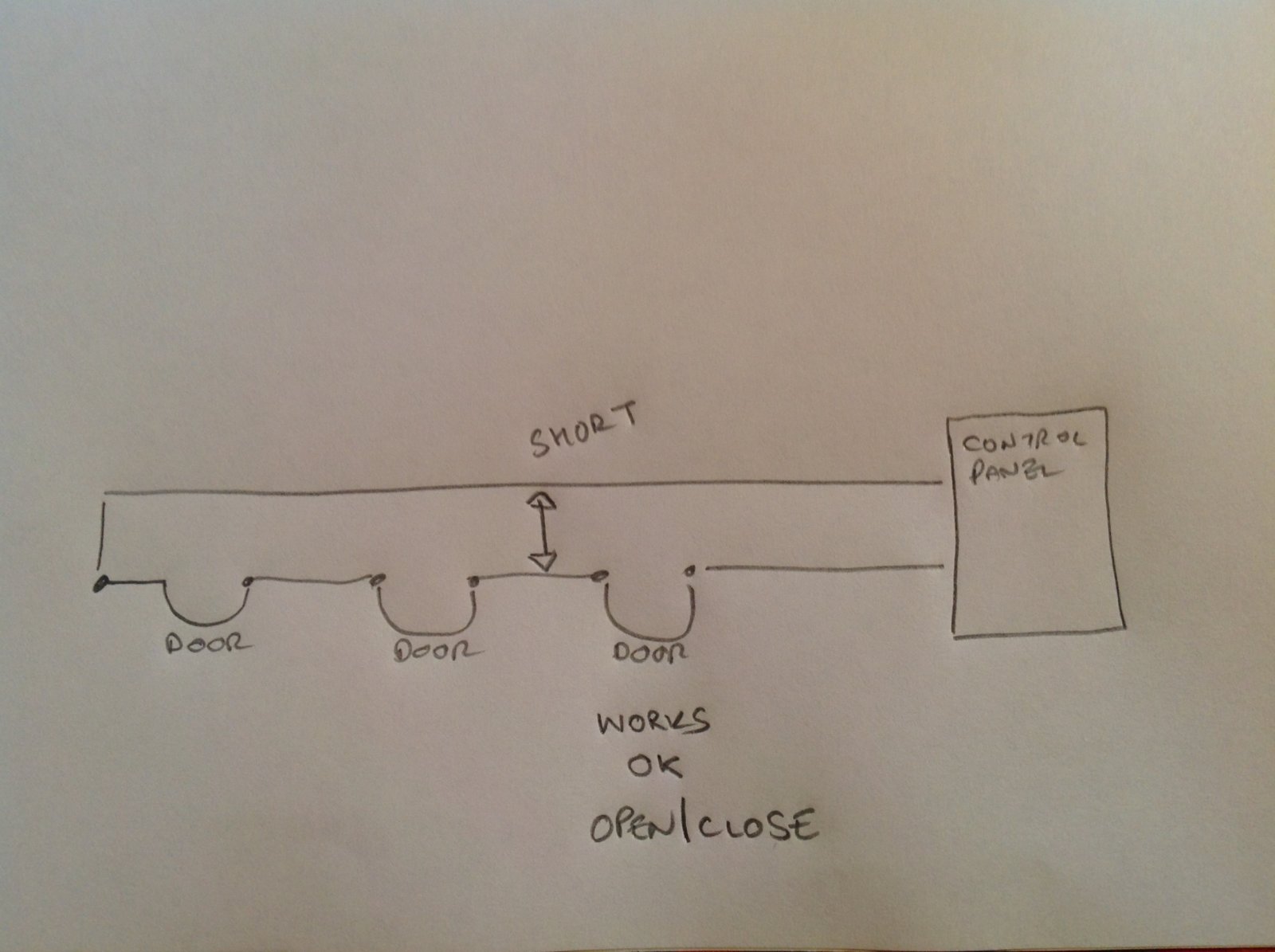

IMG_1527.JPG There's a short on the cable
See crude diagram ....lol
Guess so but how do i find it? All the wiring is buried behind architraves and plaster! By short I presume you mean the blue is touching the orange between the first and second door at some point (the door which is working is right next to the box so i assume its the first on the run) thereby providing a return to the box. Thats the only logic I can see. If so I am going under the floor boards tomorrow! lol
