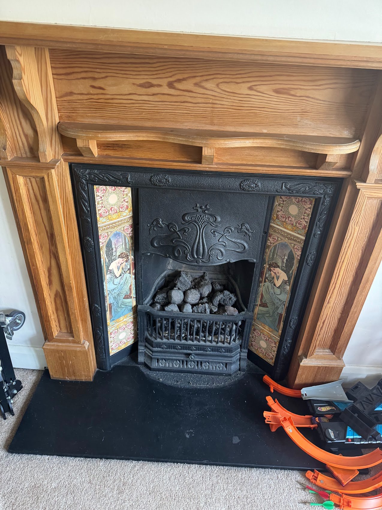

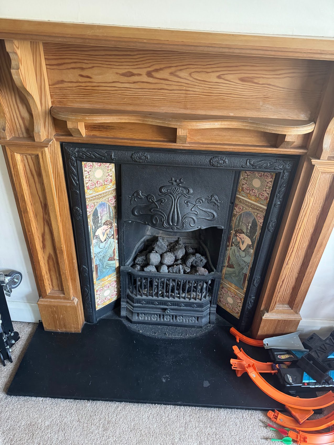

We live in a 1930s semi, lounge still has chimney breast with a gas fire and surround as pictured below. I want to take out the gas fire and suround, and hearth; and board it over. Grateful for any advice of whether I should do this myself, or an idea of the scale/cost of getting it done. My sense is it might depend on the state of the gas...
1. We've not used the gas fire in the 10 years we've lived hear, but understand from the previous owner that the chimney is open, the gas fire works, and that there is a gas 'tap' in the left-hand alcove. Can I just confirm the gas tap is switched off, then remove it myself?
2. How do I actually take it apart? The hearth, gas fire and surround all seem rock solid. I can't see any screws or release points. There are a couple of points that look like there might be sunken nails, but it seems all firmly and permanently attached. I assume the surround needs to come off first, then the fire, then the hearth. Left to my own devices I would probably knife around the edge of the surround and the wall and see if that makes a difference; otherwise crowbar or SDS chisel. Is this the best way? Or should I be prising the 'facia' parts of the surround off, to hopefully reveal wall attachments?
4. Any tips for the hearth or fire?
5. With everything out, is there anything important to do when boarding up? Do I need to 'balloon' the chimney? Leave a vent? Just board up and plaster?
many thanks for any advice!

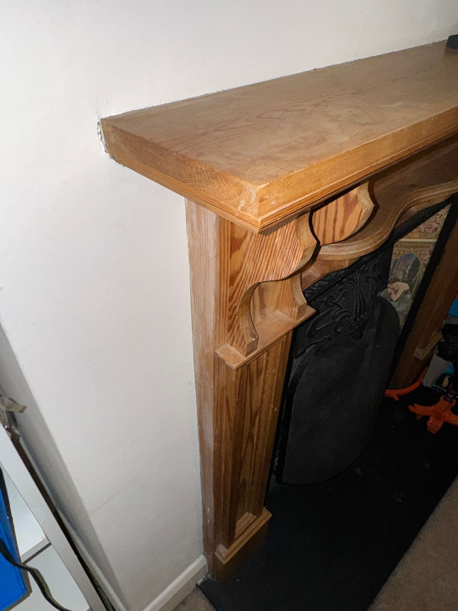

You will need a gasman to cap off the gas pipe that feeds the fire , the fireplace is 3 pieces the wooden mantel will have brackets to fix it to the wall just prize it forward and they will crack the plaster and show up , the back tiles and cast iron will come out in one piece , then just lift the hearth
Thanks - so if I prise of, literally the top horizontal mantle (i.e. just the top-most put of wood on the top of the surround), that will expose the brackets?
When you say the "fire place is 3 pieces" - is that left "tiles, central unit, right tiles" or something else?
What's a reasonable price SW London/Surrey to have the pipe capped off? Presumably by a gas-safe engineerin/plumber?
no prize from the side , the brackets will be down the sides , no 3 pieces will be the wooden mantel/sides , 2nd will be the cast iron / tiles in one piece then the hearth

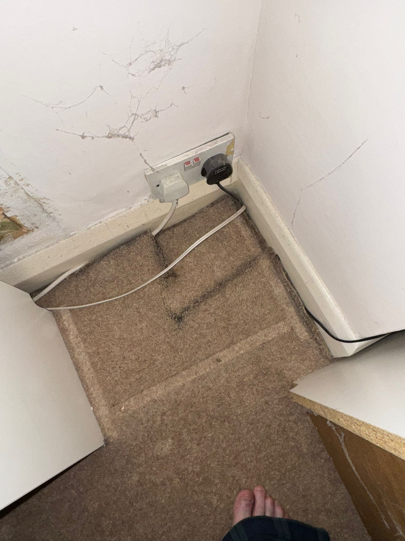

So I had no idea about this, but I just moved the furniture to expose the tap, and to my surprise - it has been removed. It used to stick-up through the carpet, but now gone - with just a couple of holes in the floorboards. TBH, I don't have a clear memory of this at at all - but we did a big extension that impacted the kitchen gas, so it must have been taken out then.
So this presumably makes removal easier.

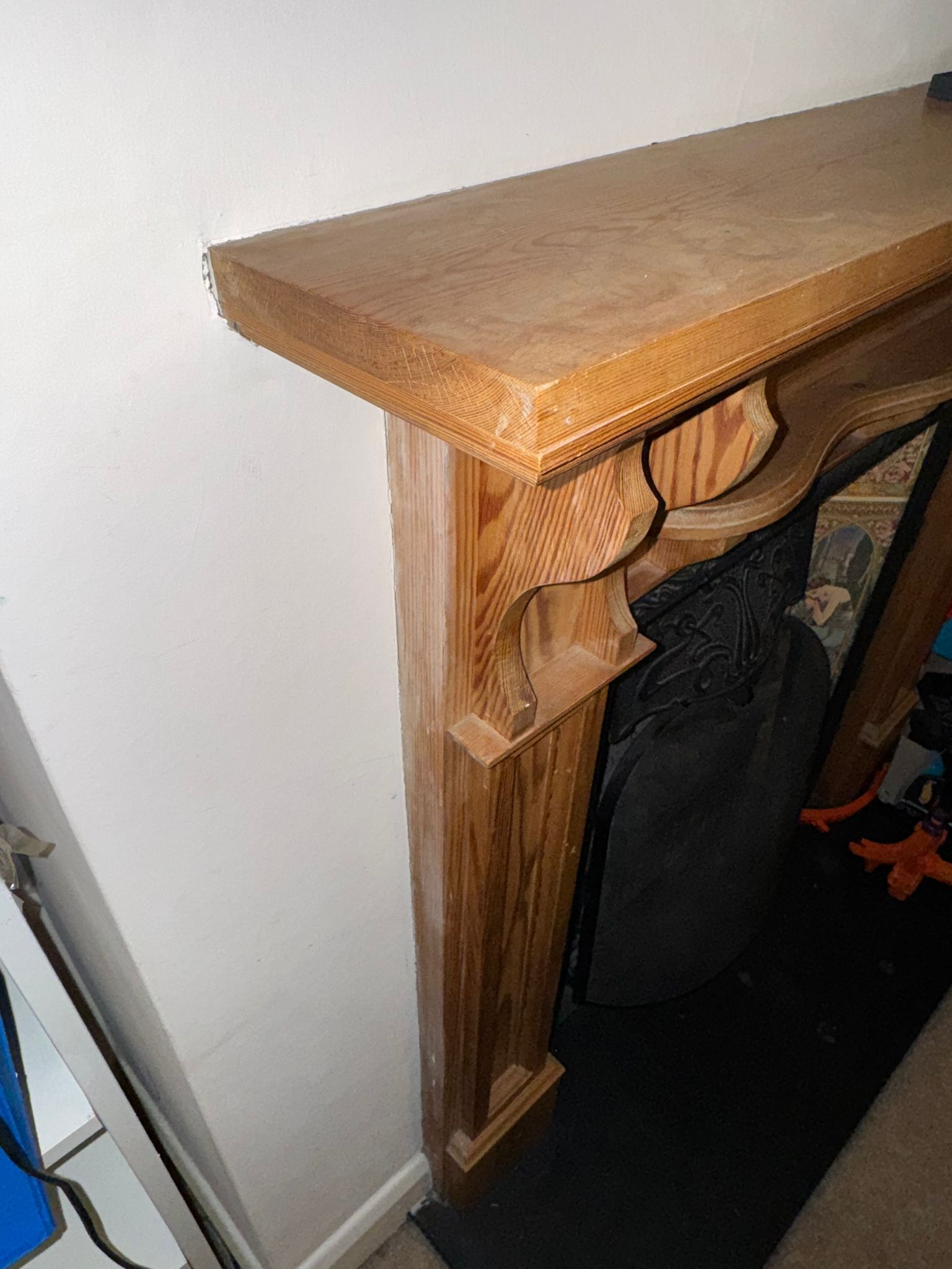

I might try crowbarring the marked section pictured below of the surround tomorrow. Do you think I'll need any special tools to remove the gas fire itself? presumably will be screwed down? And connected to metal pipework that will need a wrench to remove?

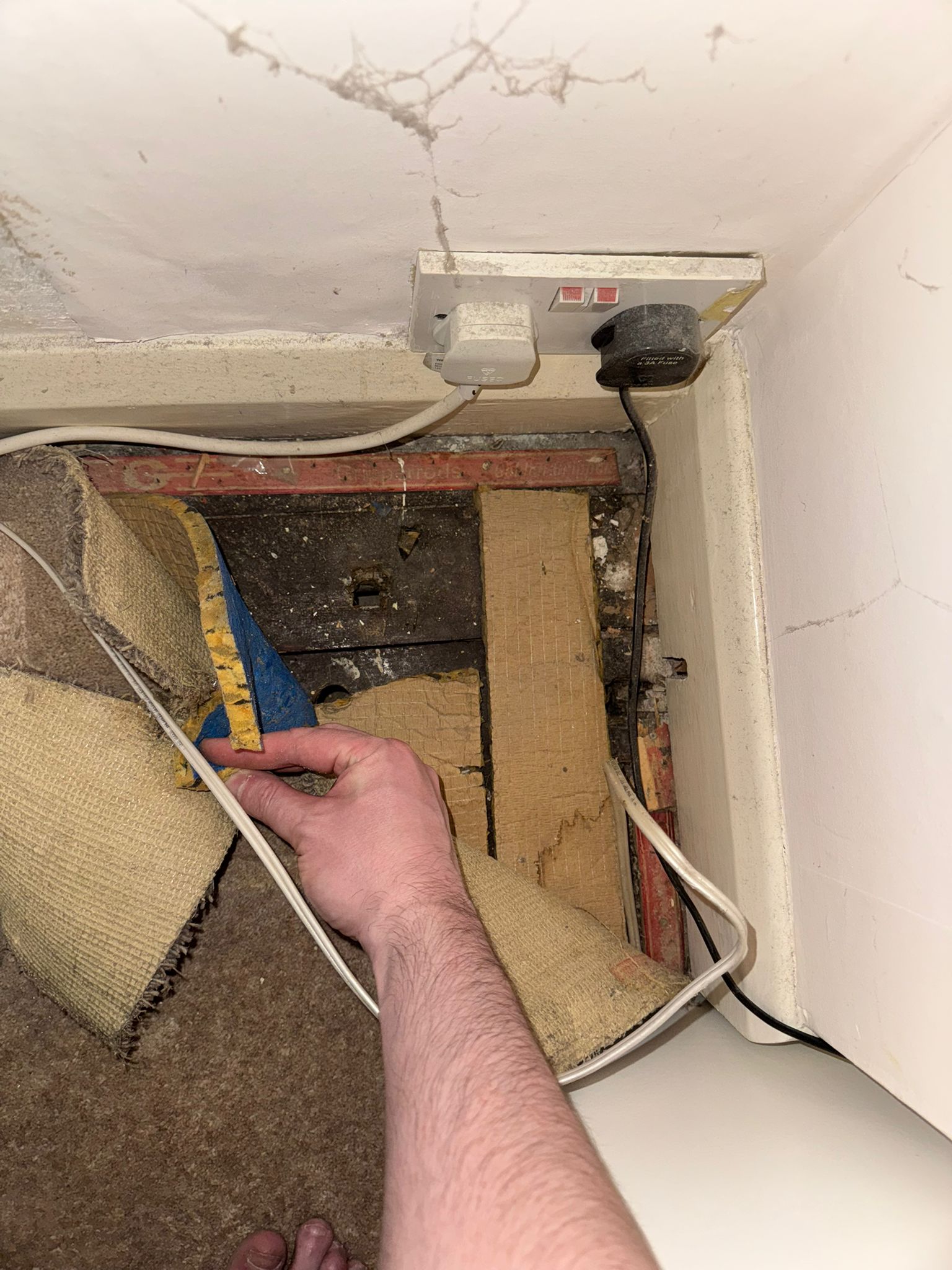

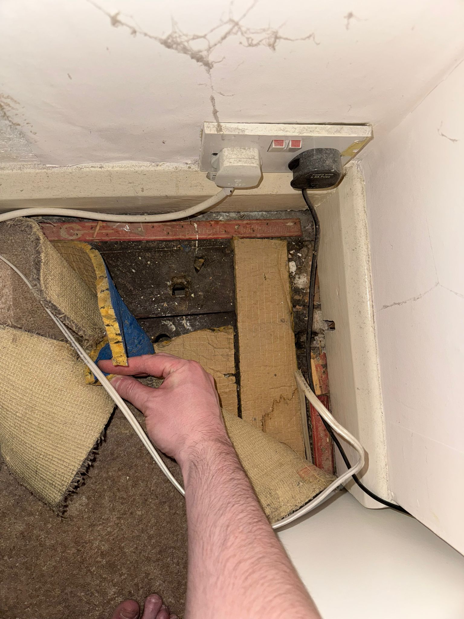

I should have looked after moving the furniture yesterday, but I presume that if I lift that floorboard, I should see the old pipe with a cap on it.

Use a knife to cut the outline seal/paint to your fire surround - it will allow better removal of the wood fire surround & mantle without spelching the surrounding plaster.
If fixing brackets have been used then Its possible that the wood surround can be lifted up & off its fixings?

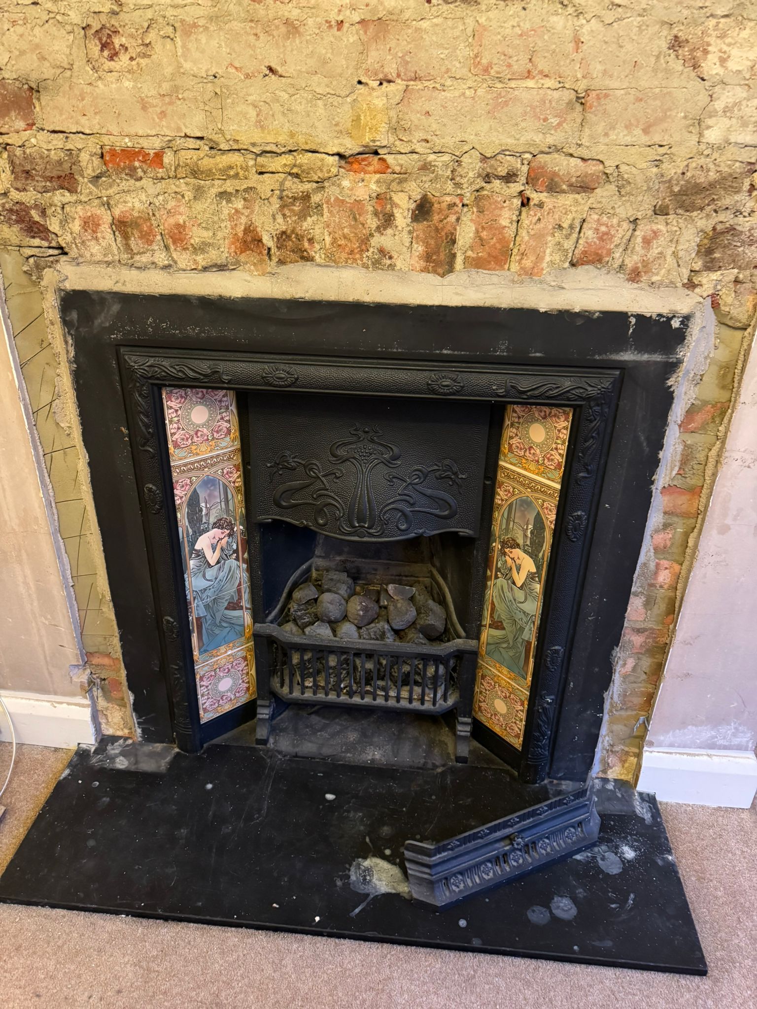

The cast iron legs of the tiled cheeks will often have fixing lugs set about 150mm down from the top & up the bottom - the lugs will have been screwed to the brickwork.
Gently prise the hearth up but keep it in one piece if possible?

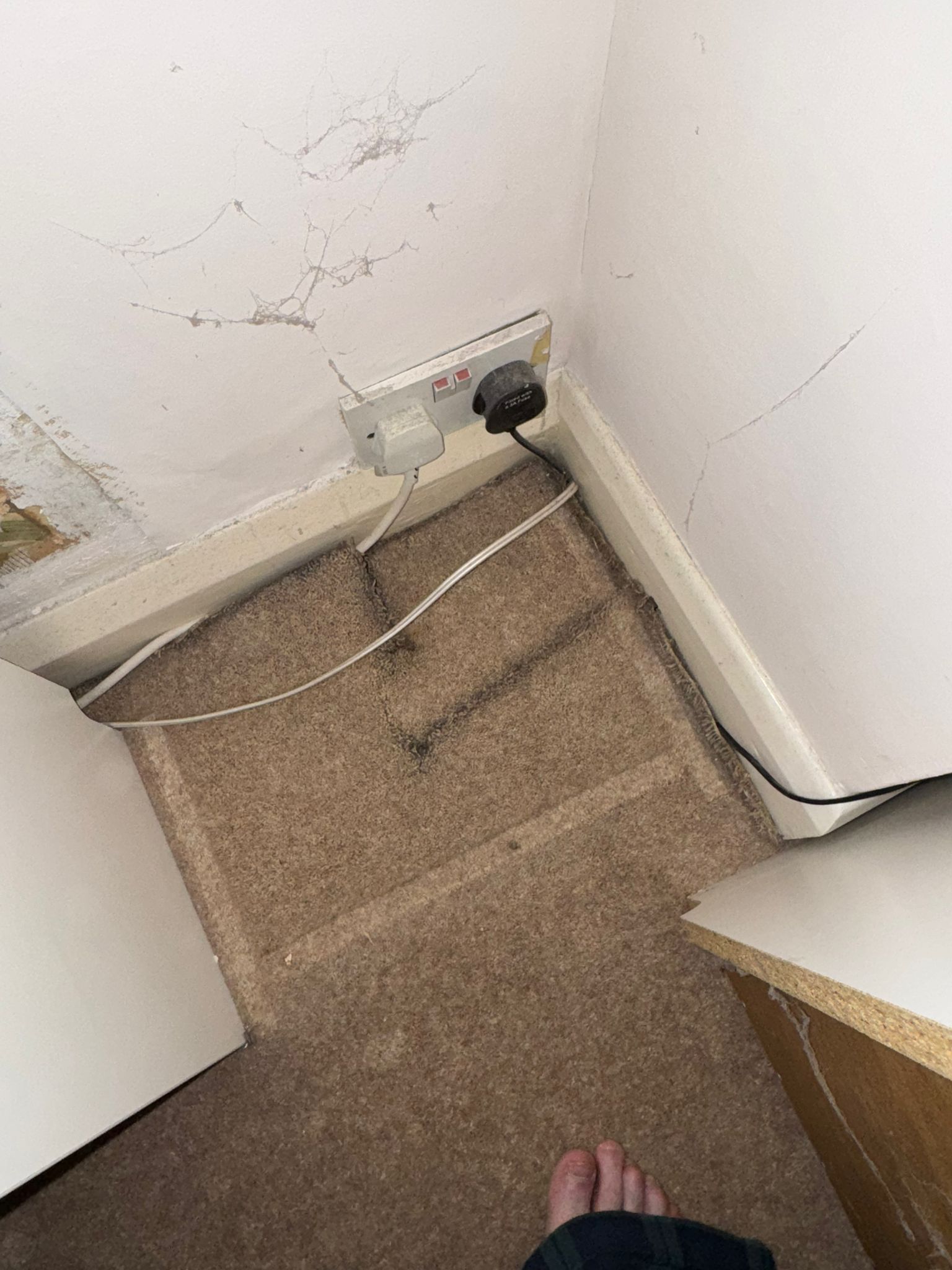

FWIW: your sub-area soil is pretty damp - there's a patch of swollen plaster near the elec outlets. Do you have good underfloor ventilation from an adequate number of air bricks?

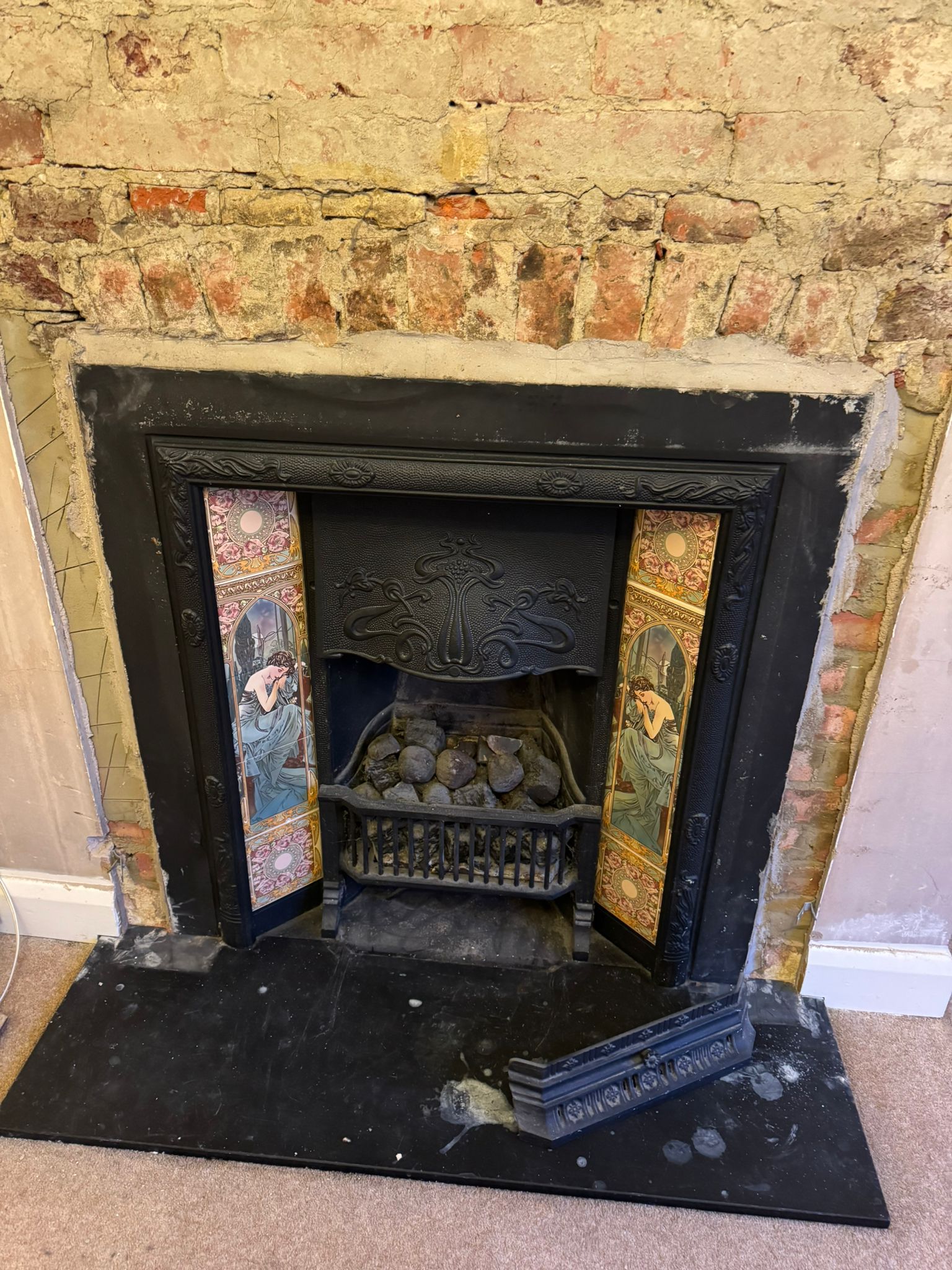

Hi all - thanks for the advice here. I double checked under the floorboards and the gas pipe is firmly capped off.
Wood surround had a fixing bracket about 10cm down from the top mantle and another about 15cm up from the bottom on each side. After cutting around with a knife, it took some hard pressure on the top mantle to expose an edge to get a chisel in, and eventually a crow bar. It was only half way through this that a located the brackets, so the right side was levered off, but the right was chilled and unscrewed. Quite a bit of plaster came away with the top of the mantle.
Behind the mantle, the gas fire looks to be plastered/cemented in. The (decommissioned) gas pipe goes from the bottom of the fire into the hearth. I was planning to cut that with a multi-tool, then use a SDS drill on hammer mode to cut around the outside of the plaster. Not sure if I should expect other attachments as well? Will try to get it out undamaged? What would I expect to get for it?
Ref the damp: there is an air brick at the front of the house, but the rear of the room has a rear-extension with a poured concrete floor, so no ventilation that side. I'm not sure when that damp would have occurred.
