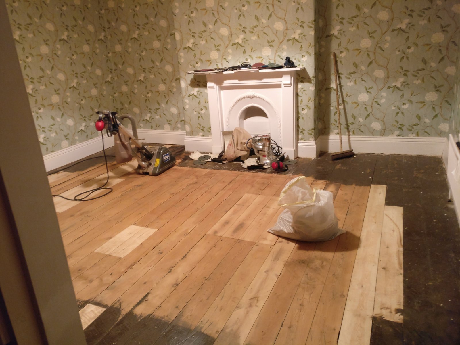

Having our Victorian boards sanded after removing the carpets... nice 22mm ones.
What options are there for treating them and what are the pros and cons? I'm aware that it's a right faff to do one option and change your mind.
So far varnish seems the obvious one, but it can be slippy and shiny and I guess if it scratches or chips it will flake off as it's a surface treatment only? What we'd probably like is them to be coloured (pine or other light colour but not Scandinavian) but then look as if they are untreated while obviously this isn't the case. So they look and feel 'warm', if that's a useful term.
I suppose waxing and staining are other choices but that's where I run out of ideas.
If you start staining them, then it'll make any repairs more difficult. You'll want a UV stabilised varnish, or you can use something like OSMO solid oil that can be done in a couple of coats. Have a look on OSMOs website for your options.
So here's a hiccup. Some parts of the floor are painted with a weird black paint which appears to melt the moment it's sanded, clogging the sanding paper... They've got through 10 sheets of 40 grit just to do one part.
Anyone know what this might be and how to get it off? The boards appear original Victorian. They're going to try heat next but haven't come across whatever this is before.
Go for the heat and scraper, get the floor cleaned, and then come back with the results.
Seems to be working, though white spirit is the best they've found... Makes the black stuff go brittle so it can be sanded.
So, I have antique boards which I presume are pine (?). They've used new 20mm boards for repairs which are very pale...I love the way the old boards are coming up but wonder what I would treat the new ones with to get a match, before perhaps applying a clear varnish on top?
My issue is I want the same finish on new and old boards... Stains all seem to be stain+varnish, would I be better colouring the new wood then applying the same varnish to the whole floor? Colouring the new boards with something that permeates without affecting the finish. Would that be oiling or waxing... Or should I just get some clear and coloured varnish from the same range?
You're not going to get the same finish I'm afraid. You've got old and new boards, and unless you get a very dark stain then you're going to get a difference in the colour. You would have been better off staggering the new boards around the room, and that would have blended them in a bit.
Have you looked on the Osmouk.com website for the range of finishes and colours they do.
Identical is not the dream, just similar. The photo above shows then after sanding... The old boards are quite pale just not white like the new ones. I see people sell antique pine varnish/stain.
But finish and colour are separate things. Different colours on the new boards is one thing, but the old ones being Matt and the new ones gloss for instance would be awful!
We couldn't get old boards up without damaging them... And sadly there were no reclaimed ones to be had when we needed them
Getting the old boards up require patience, you use a nail punch to knock the nails through. Whichever way you go, whether colour, stain, matt or oil/wax finish, you're going to notice the new boards for a few years till the blend in.
Yeah that's fine... Part of the character as long as they're at least sort of close. I can always sand it if I mess it up I suppose
