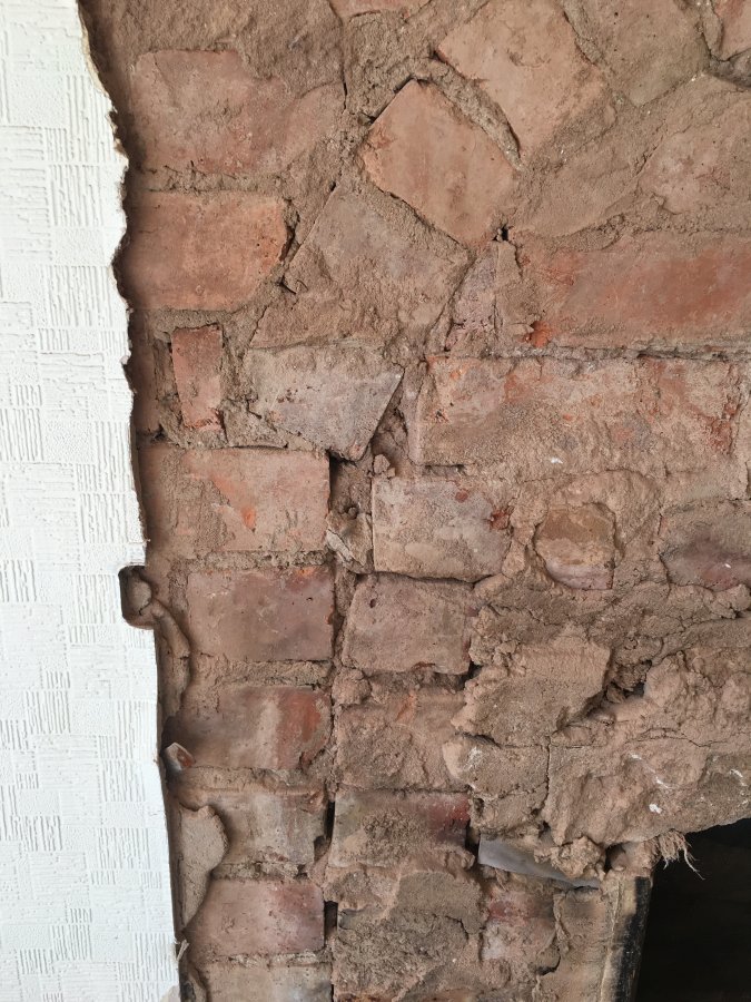

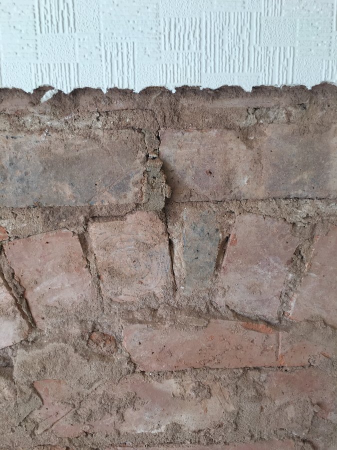

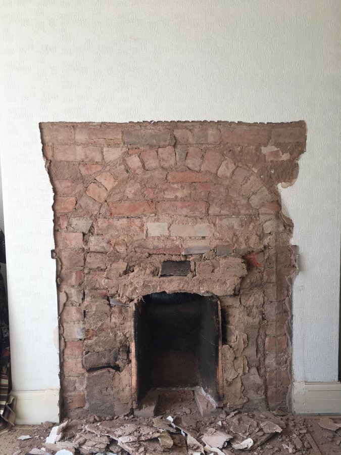

So, we removed the old gas fire (including concrete surround) and started chipping away at the plaster to try and find the original builders opening but now slightly confused.
Is the curved brickwork the builders openings original lintel and everything below it filled in for fitting of the gas fire?
I can see where the newer, untied in brickwork is an add on but wondered where the support for the chimney above comes into play?
The arch supports the wall above
Cheers Woody! So am I safe to assume that the brickwork below the level of the archway can indeed be removed without affecting the structure? The doesn't appear to be any movement within the arches pointing etc.

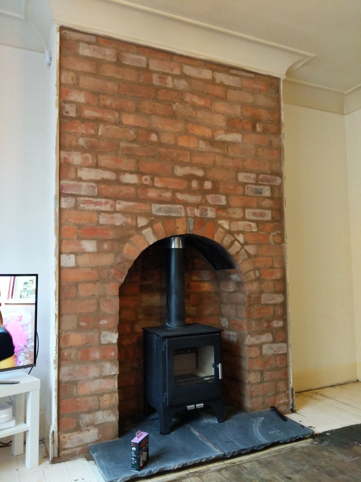

Nice job. Good when someone gets back with the finished job. That will please woody, the arch actually stayed up.

Apologises for old photo. Surround has been refitted since.

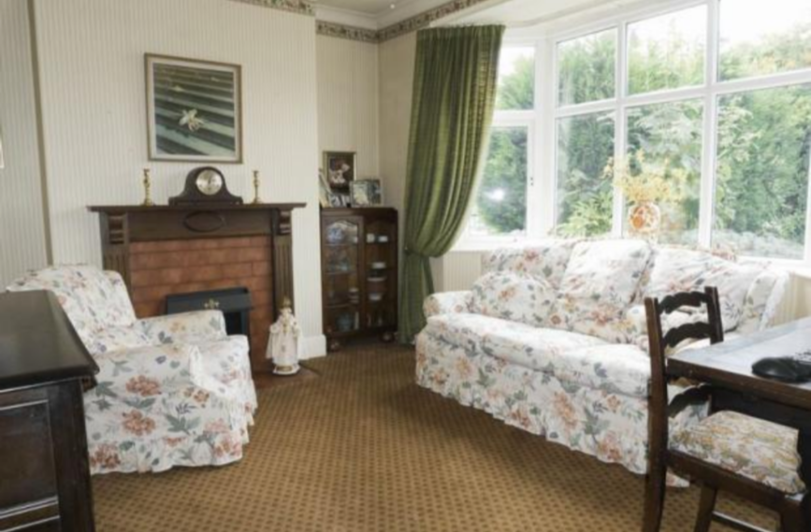

This was the original room before 'restoration'
