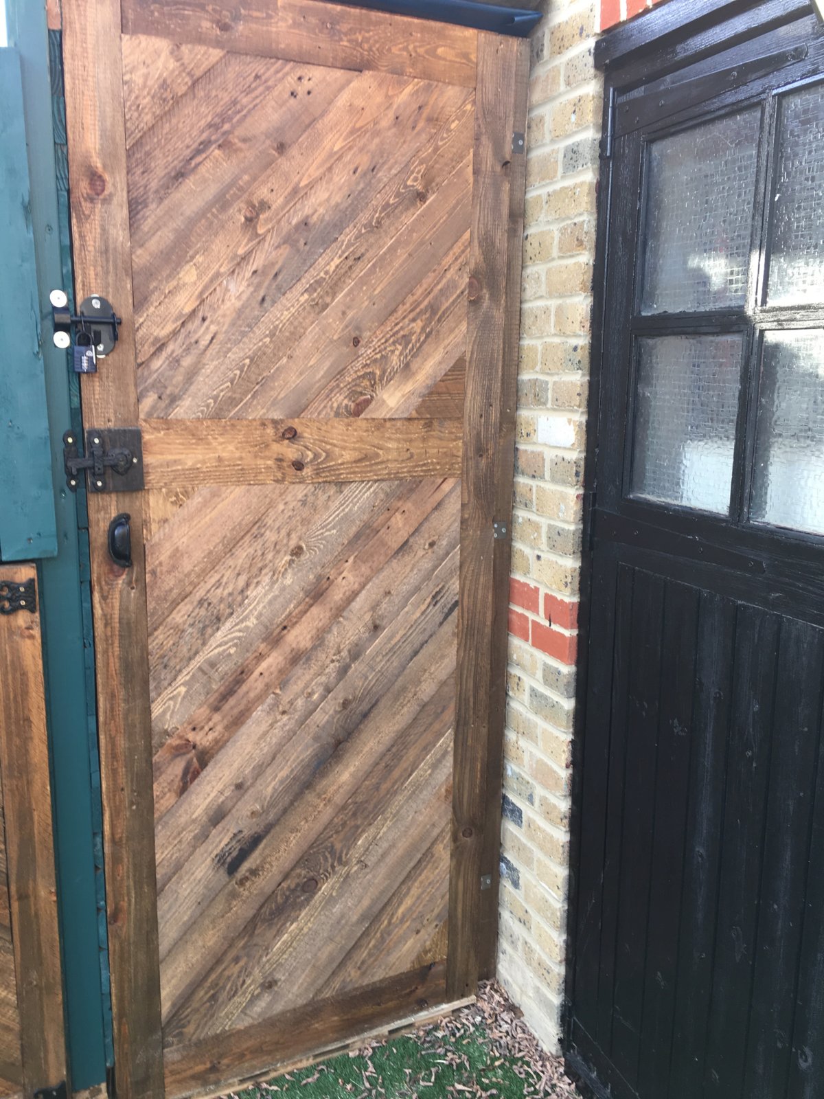

Osb door clad with pallet timber?

Scaffold Plank L&B Doors very good idea.
I'll go back to them and say "over the weekend I came up with this fantastic idea" :LOL::LOL::LOL:, not really, thank you.
