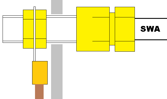

... yet you seemingly do 'like' relying on the mechanical joint between gland and banjo?

When done properly [the old way] the banjo connexion to the gland doesn't rely on the mechanical lock nut.
That's a bit semantic, isn't it, since it does rely on A mechanical lock nut, it's just a different lock nut from the one holding the gland to the enclosure. Indeed, it's arguably slightly 'worse, since if the nut holding the gland to the box was a bit loose, that could compromise the mechanical (hence electrical) connection between the banjo and the nuts on either side of it (like your concerns about having a nut on a bolt, against the box, prior to the lugs).

My belief is the earth lead to the gland body has nothing to do with dissimilar metals. As I remember it the introduction of the current style of SWA glands came in 2 styles; Gland and one lock nut for use when running a separate earthwire or gland, banjo, 2 brass lock nuts, brass bolt set and instrustions on how to fit. in either case there was no reliance on the mechanical jointto the enclosure for the circuits earth fault current.
And of course there is no, and never has been, a requirement to fit a brass gland for a SWA termination.
John.

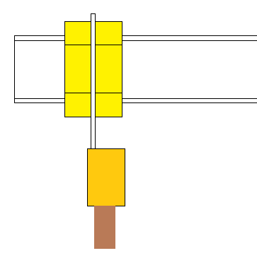

May I assume you would accept this bolt with 2 nuts tightened against a lug forms a sound electrical connexion?
That's my belief, too - and it certainly was not me who brought 'dissimilar metals' into the discussions.
As I remember it the introduction of the current style of SWA glands came in 2 styles; Gland and one lock nut for use when running a separate earthwire or gland, banjo, 2 brass lock nuts, brass bolt set and instrustions on how to fit. in either case there was no reliance on the mechanical joint to the enclosure for the circuits earth fault current.
True, but in the second case (with a banjo), whilst there was "no reliance on the mechanical joint to the enclosure for the circuits earth fault current", there was "reliance on the mechanical joint between the gland and banjo for the circuits earth fault current" - and, just like "the mechanical joint to the enclosure" that (electrical) 'joint' was reliant on "a" locknut. I somewhat struggle to see any material difference.
Very true, but this discussion appears to be all about the situation when a brass gland is used.

John. May I assume you would accept this bolt with 2 nuts tightened against a lug forms a sound electrical connexion?
You may assume that ... so long as the nuts don't become loose.
The chances of one of them coming loose would probably be less if one of the nuts were tightened (on the stud/bolt) against something else (like the wall of a 'box').
Kind Regards, John
Kind Regards, John

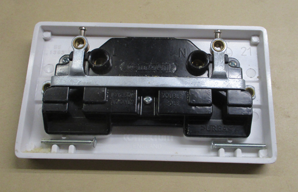

Well I hope it does form a sound electrical connexion as it is the method used for terminating on to these as there is nothing to tighten against:
I can't find fitting instructions on line to quote from but they say to leave 5mm clear of the resin, fit a nut, washer, lug, washer & nut.
So, as predicted, you have pre-empted my question but I'll ask it anyway. When that bolt is actually the thread on the gland and the thread passes unhindered through the wall of an enclosure, let's say it's plastic as I believe you understand that concept, may I also assume you accept this arrangement is electrically, but not mechanically, sound?
The lug is of course now replaced with the banjo.
Perhaps we should go back to previous arrangements with a tapped hole for a lug to be bolted directly to.
