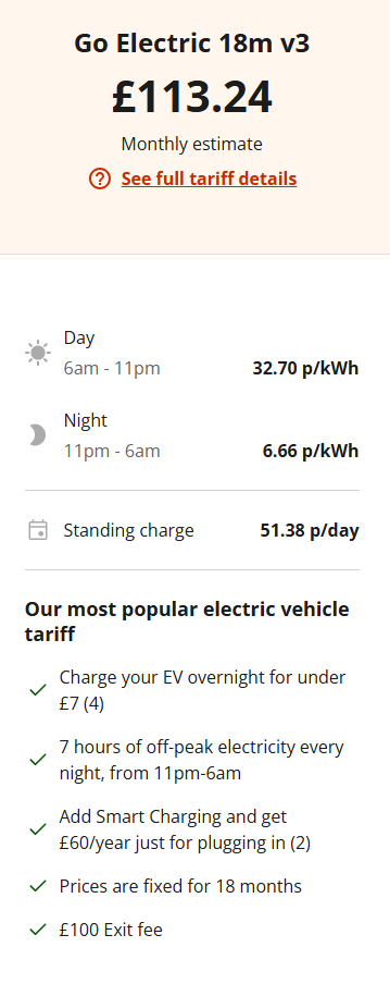

Just got my new & increased lecy bill tariff. I was paying around 6.6p off-peak & 23p peak. Good energy now want 8.8p & 34p an increase of 19% & 39%. So i have had a shop around & EDF seem to be the best of the rotten increases around, pluss an extra 2 hours off-peak than most others. Have you seen better. ???
Electricity Prices from 1st May 2026
Standing charge (per day) 69.699p
Unit rate - day (per kWh) 32.277p
Unit rate - night (per kWh) 8.625p Seems wrong, they are lower, see #8

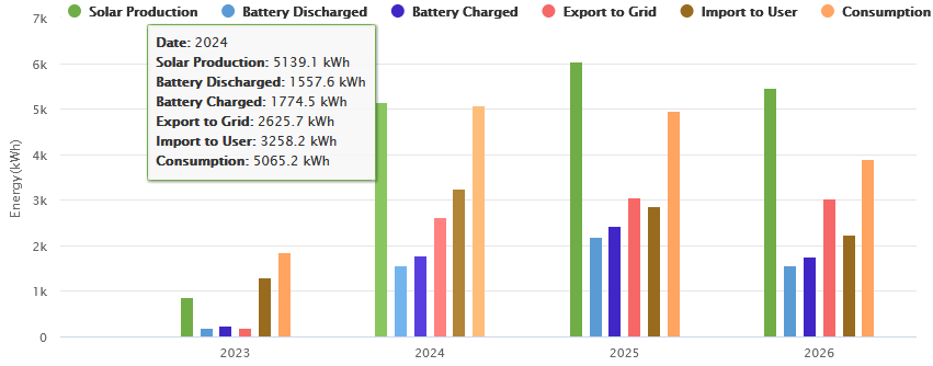

It clearly depends on battery size, and how much imported and exported at each price, as long as off-peak cost less to export, I can fully charge battery overnight, and it does not matter if solar produces over what I need. Once the export drops below off-peak import then I need to consider how much to charge my battery.
Today already exported 1.8 kWh.
Each household will have their own patten of use, and I know I am moving to time of year when my solar production is going to drop.

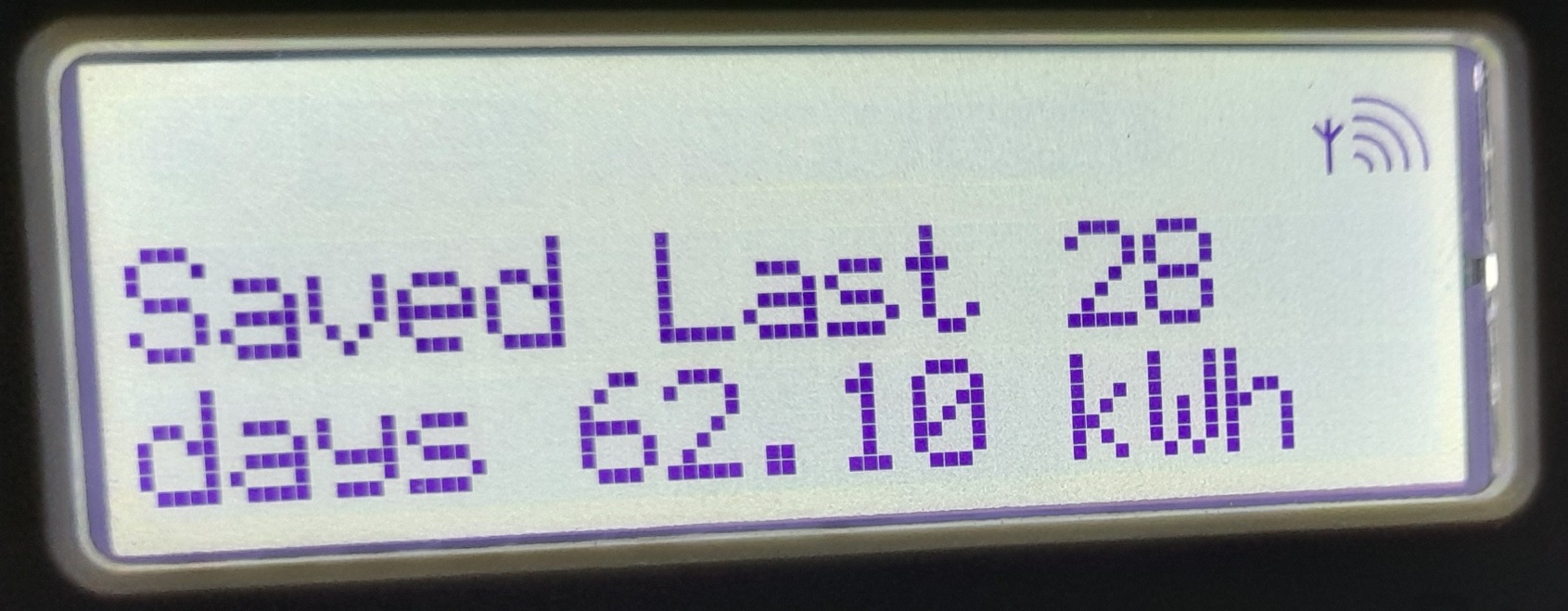

So when solar panels fitted, had an iboost+ (in hind sight a mistake) but it recorded how much as it put it saved by using solar, so could actually see how much the immersion heater was costing, also went from 9" to 27" in length. Saved last 28 days Tuesday 4th Aug 26.jpg So I know in summer, 2.2 kWh per day average, and around 3.8 kWh at least per day using oil, could be up to 6.5 kWh if run every day. But also the extra would be heating the house, so can add the cost of running the AC to cool it again, so makes sense to use solar at 12p/kWh loss if exported instead, to using oil.
We do use very little hot water, and an over night timer would likely save more, I suppose removing batteries from CT coil and I could use overnight off-peak, but never set it up.

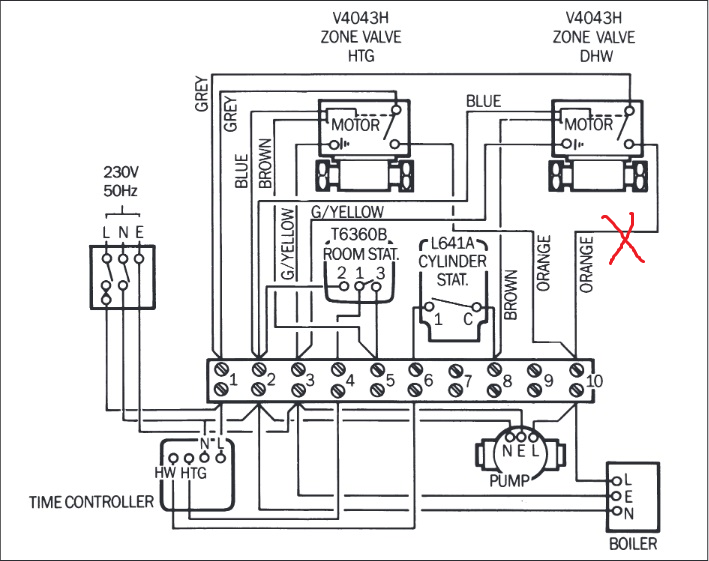

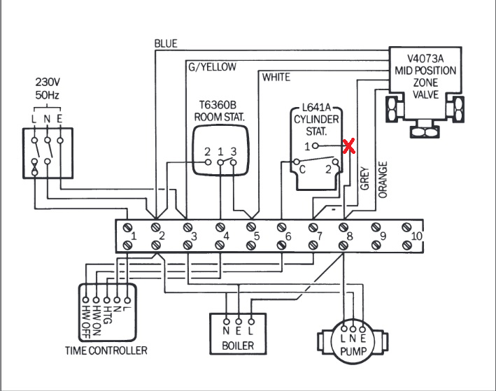

For me easy, using a C Plan so can't turn DHW off, so if boiler is running for CH then the DHW is also heated.
The Y and S plan not so easy. With 1791637438215.png1791637806705.png a switch where the X is a valve will open/close, but it will not fire boiler, so DHW only heated when CH is called. But it would require the switch being off so in winter DHW only heated when boiler is running anyway.

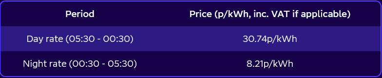

But, I have found, in winter not enough solar, and anyway solar paid at 12p/kWh and off peak cost 8.21p/kWh so for me, a simple time switch is enough and run the immersion heater overnight only.

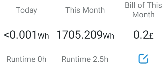

I first did this some 10 or more years ago, in the main no surprises, most stuff has a label saying how much it uses, and the one watt limit has been in for stand-by for some time, the old Sky+ box was a surprise, as back then to be able to start recording early if there was a program change, it needed to keep the LNB powered so it could read the program guide, so was using more like 15 watts, so around £30 a year, the other three items, which are hard to work out costs, are the tumble drier, washing machine, and dishwasher, as there are so many programs, each one uses a different amount of energy, and they weigh clothes and vary amount of water heated etc, and sense humidity and change drying time. I found using a vented drier at 1 kW or a heat pump drier at 750 watts, worked out nearly the same. But with a condenser drier, often no option to turn down heat and extend the time, so they use a lot more power.
The other is the freezers, it may say 250 kWh per year, but most take more than the label says, so if it says 250 kWh per year, likely more like 350 kWh per year, however if they loose gas, they use more power, so every year I put the monitor on them, and see how it compares with the last year. Mainly as a warning it is likely to fail, rather than a reason to get new.
So we are left with the likes of the oven, can't use a plug in energy monitor, so we again have to guess, the smart meter or solar app may help, but you are measuring totals, so we look are different ways to cook food.
The Y and S plan not so easy. With View attachment 423961View attachment 423962 a switch where the X is a valve will open/close, but it will not fire boiler, so DHW only heated when CH is called. But it would require the switch being off so in winter DHW only heated when boiler is running anyway.
