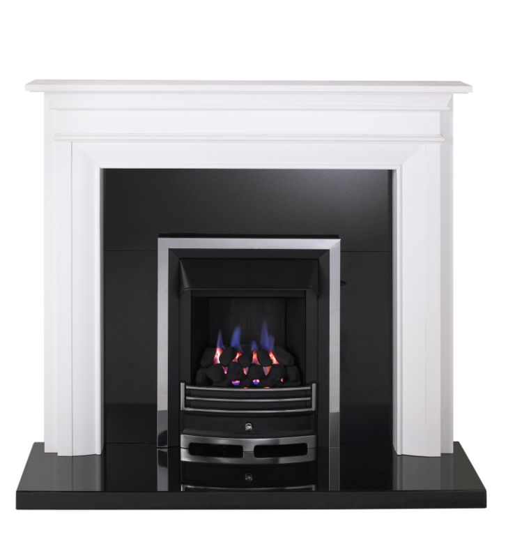

Well the oven arrived on Saturday the gas fire has been ordered and the Sparks is coming on Thursday to start on the new CU & kitchen rewire. I had to contact the leccy people though as I have no proper earth (a peice of metal tubular conduit is sticking out of the ground which is my earth :eek: ). I have contacted the energy company who said it'll take 3 weeks for them to work out if PME is available in my area :rolleyes:
At least when my holiday comes up at the beginning of January all the Pro work will be done and I can crack on!
