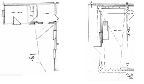

Argh, hadn't even thought about the drains under the floor! The pipes were already running under there on the way to an old outside toilet, but presumably should have been appropriately bridged when the concrete floor was laid. I guess no way of telling how well that's been done without taking some of it up?
And is there a manhole cover somewhere under the floor. Bridging (or not having been done) may be the least of your problems. Can the drains be rodded in the event of a problem. Go back to the planning application, and see what they did.
Looks like (hopefully) the pipework was redone. The manhole cover on the right image is there when we visited.

If the extension has got final certificate, founds, drainage etc should have been inspected. Cert would not have been issued without electrical part P.
If you are unsure about drainage, you could get a cctv done.

There is some risk in buying the property, not so much with what you can see but the risk of the unknown elements, like founds, steels, drains -you would need those elements checked.
