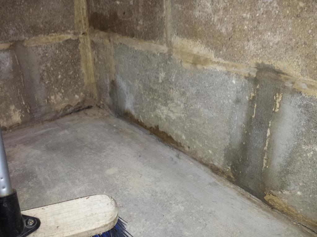

Recently moved home and there's a nice hobby/workshop outbuilding in the garden. It's a single block construction on a concrete base. Definitely has some damp issues as it had a very damp musty smell.
I pulled the pinboard wall covering off in one half of the building to find some nasty cracks in the block wall where one end of the building has obviously settled. I have filled those cracks with new mortar and I chiselled out and replaced some mortar on the lower levels which was cracked. At the other end of the building there is some serious damp in one corner - I believe the cause of this was rubble/soil piled against the side of the building well above the DPC which I have now removed.

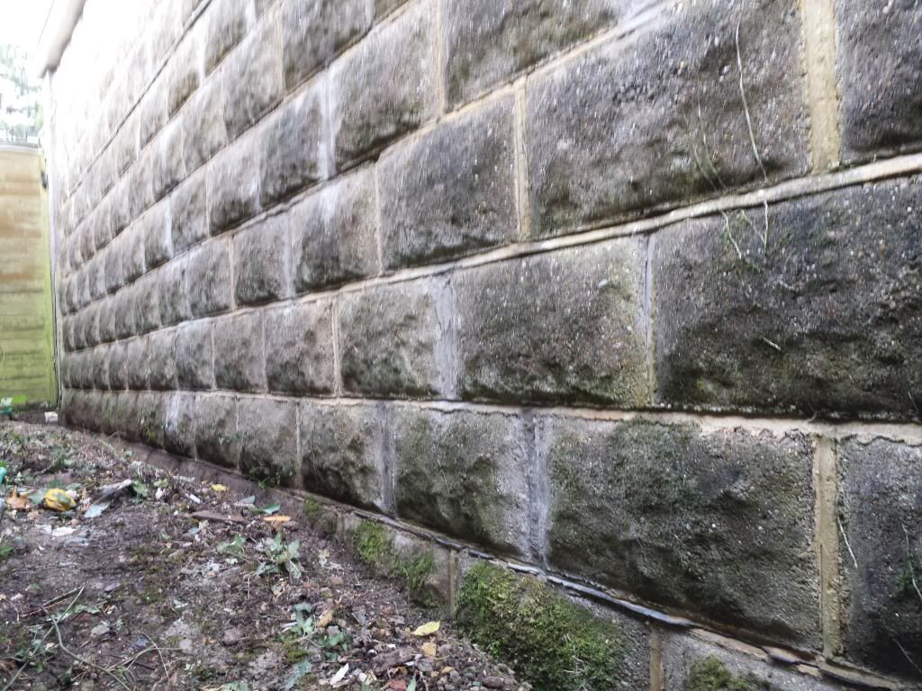

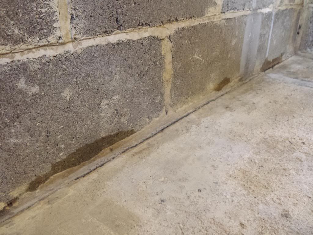

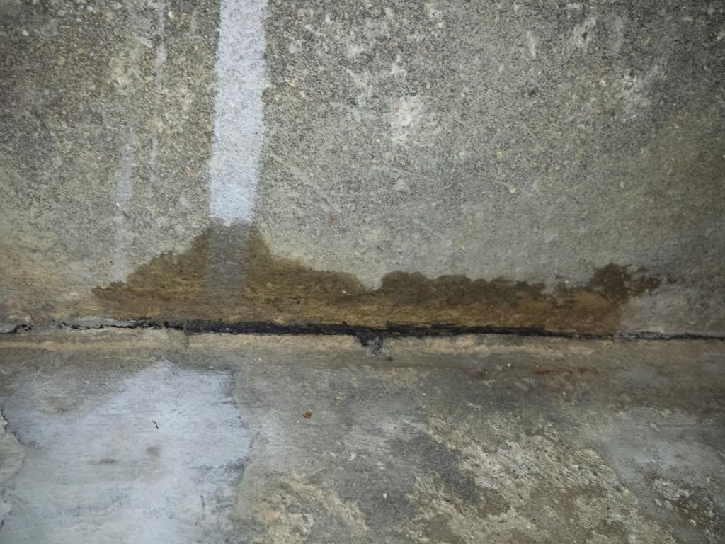

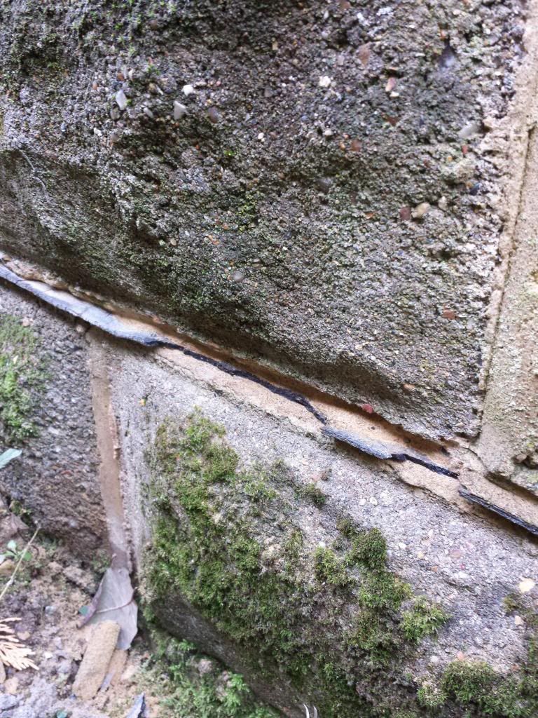

Everything dried out in the last few days and I hoped that the damp issues would be resolved, however this morning I checked it out (given that there was a lot of wind and rain last night) to find a few damp patches directly above the DPC. Looking outside that line of mortar was quite damp and not in the best condition. I gave it a little rub with a stiff brush to see how crumbly the mortar is (with a view to possibly re-pointing it) but in places the DPM sees very brittle and is crumbly meaning I can't easily replace the mortar without risk of cracking / damaging the DPM.
I'm not sure that the DPM in itself is letting damp rise it seems more likely that with heavy driving rain water is running down the wall and sitting on top of the DPM then seeping in through the mortar.
