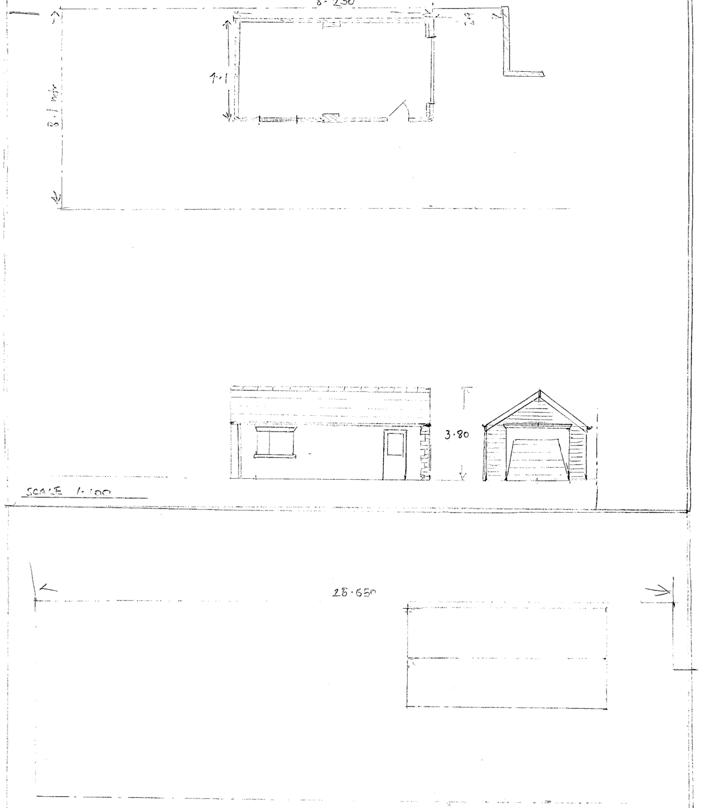

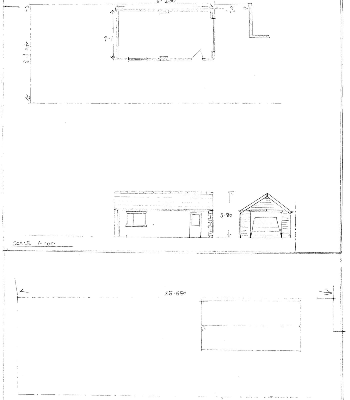

?? The planning costs are the fee - £200ish depending on area plus a couple of downloaded plans for site plan and location e.g. https://www.ukplanningmaps.com/site-plan - for PP you only need hand-drawn sketches to scale of plan and elevation - planning is only interested in form and function - they don't give a monkeys about structural issues. You don't need an architect and structural for a garden room!!
this got planning (not mine)

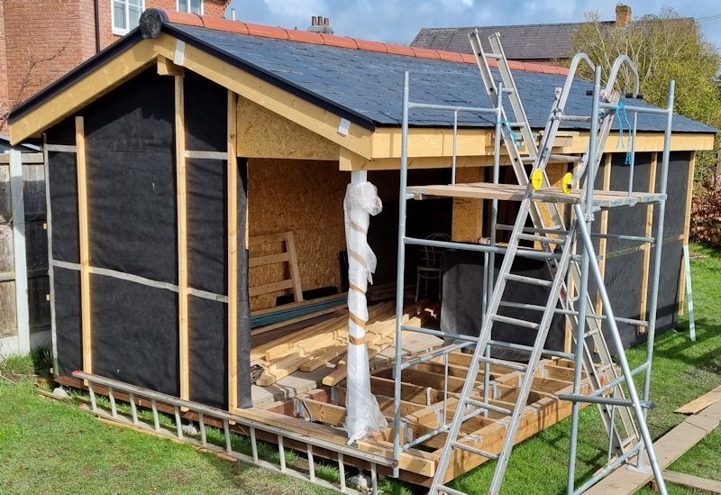

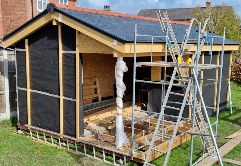

and here's my garden room in progress with planning permission
