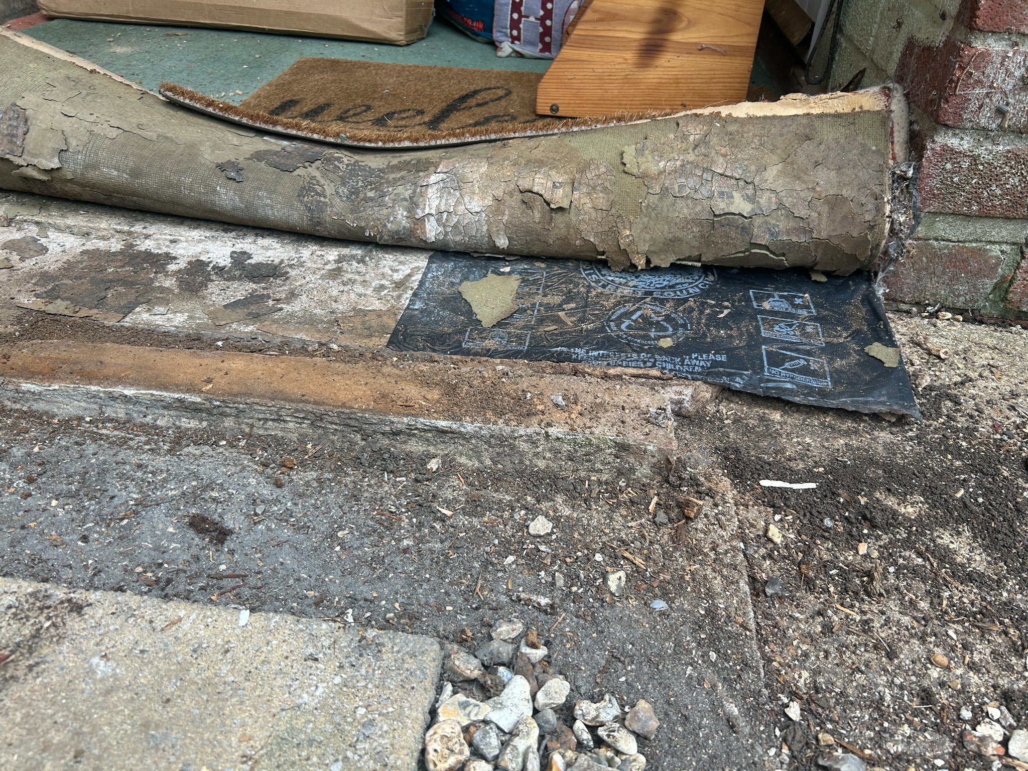

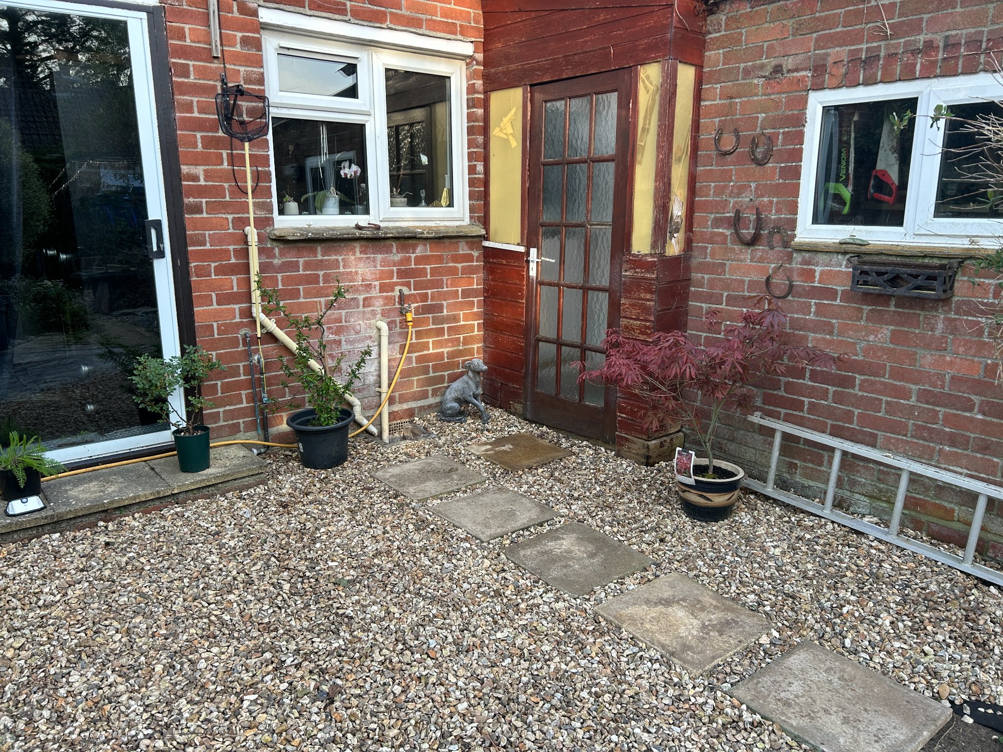

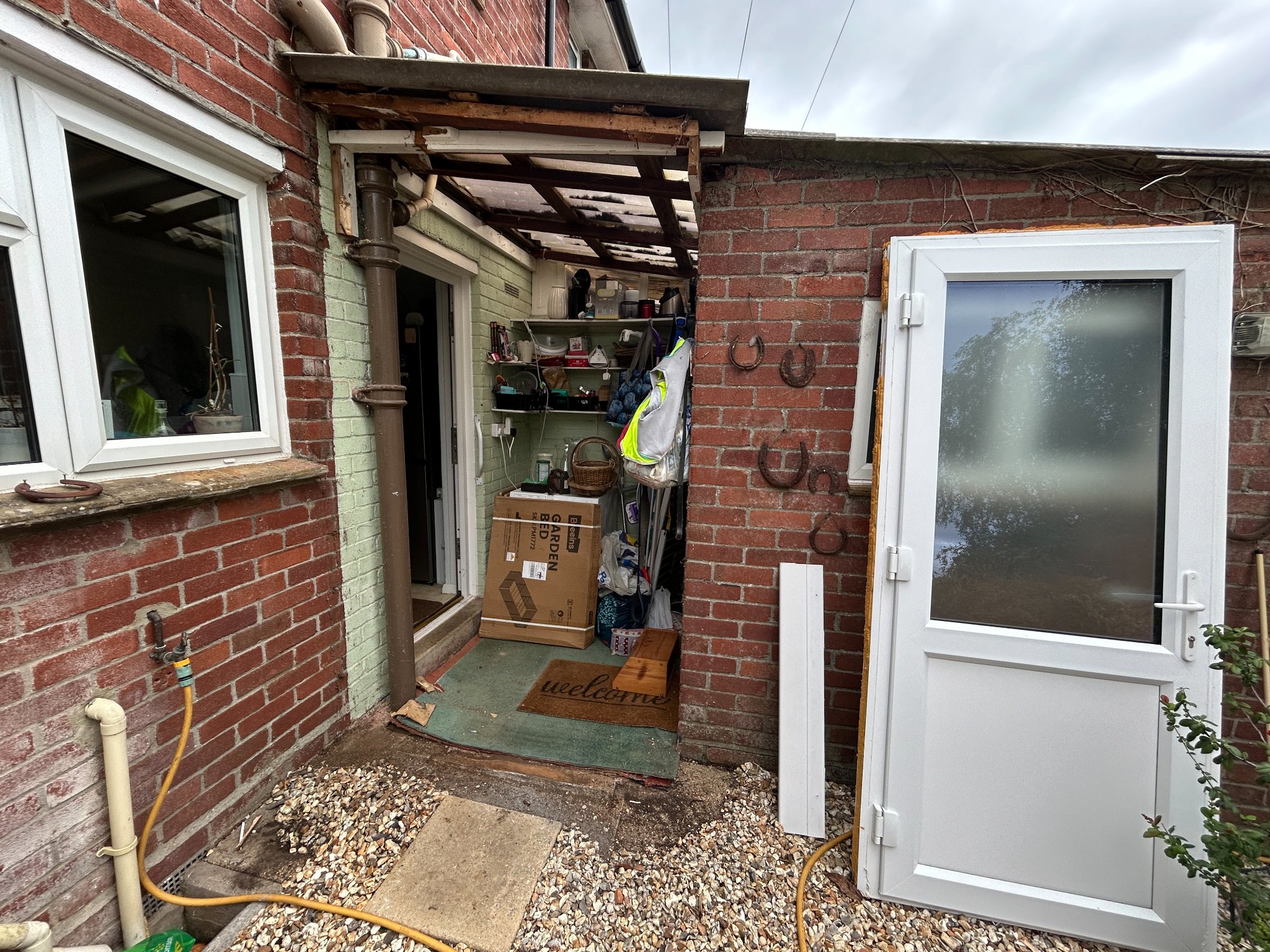

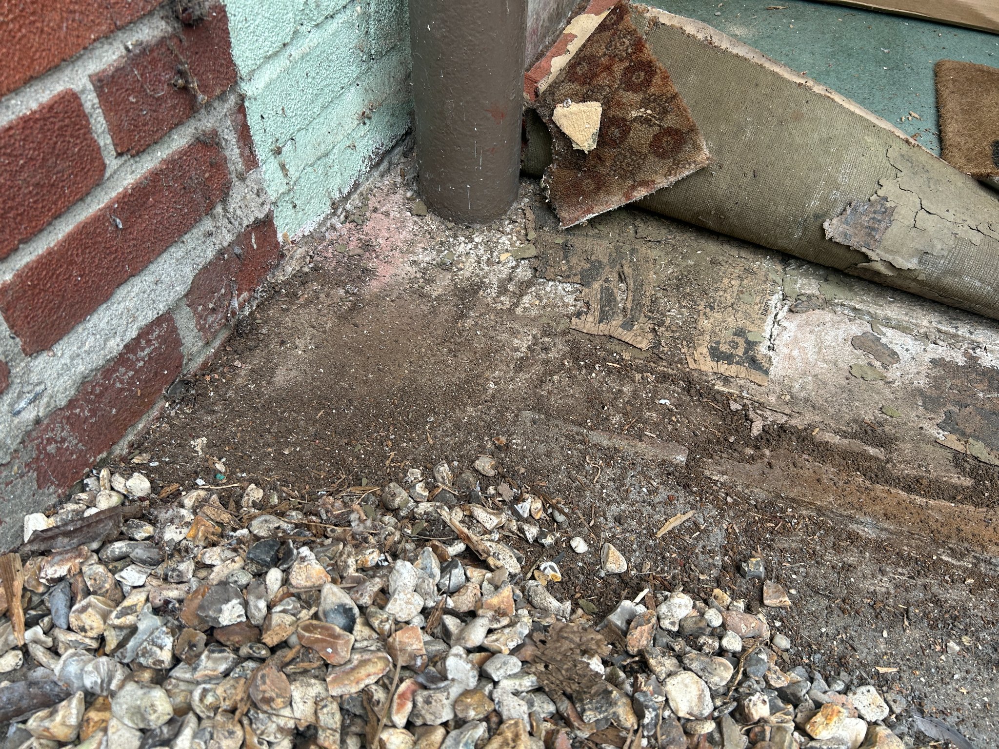

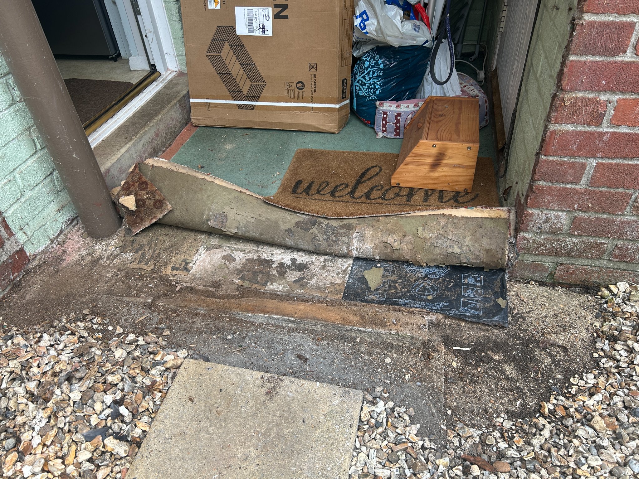

Hi all!
We moved into our new house last year. There is a brick outbuilding, around 1.5m from the house and like a lot of others on the street, they have been connected with a roof and boxed it in. The previous owner used a timber frame and internal door which over time has obviously rotted. Today I ripped it all out so I can replace it with a UPVC door and UPVC cladding. I will frame it all with timber. The problem is, the floor at the house end is level with the floor outside. The other end is around 2 inches lower due to the slope of the garden. I should really raise the floor using concrete, to stop the timber rotting and to stop water ingress. Is there any other way I could do this without the hassle of raising the floor level? Probably not, I just thought I'd ask the question on here? Any Ideas would be great! Pictures below.

Do you mean the floor of the link is sloping away from the house and you are worried about water getting in under the new door frame.
If so just order a frame with an inbuilt step and set it onto a fillet of cement to make it level and square. Or am I misunderstanding?

If it were mine, I’d definitely try to solve the floor level and water issue before putting the new frame and UPVC cladding in. The main reason the previous timber probably failed is that the bottom section has been exposed to damp and splashback over time.
You don’t necessarily need to pour a huge amount of concrete, but you do need a proper break between the timber and the ground. One option would be to build up the low end with a small concrete screed or slab, making sure it falls slightly away from the house so water drains out. Then use a damp-proof membrane and sit the timber frame on something that won’t absorb moisture.
