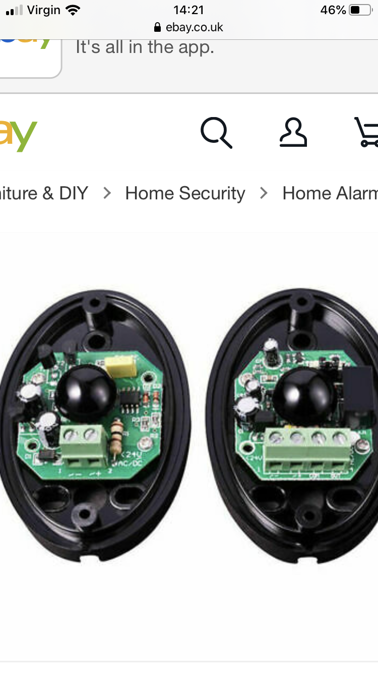

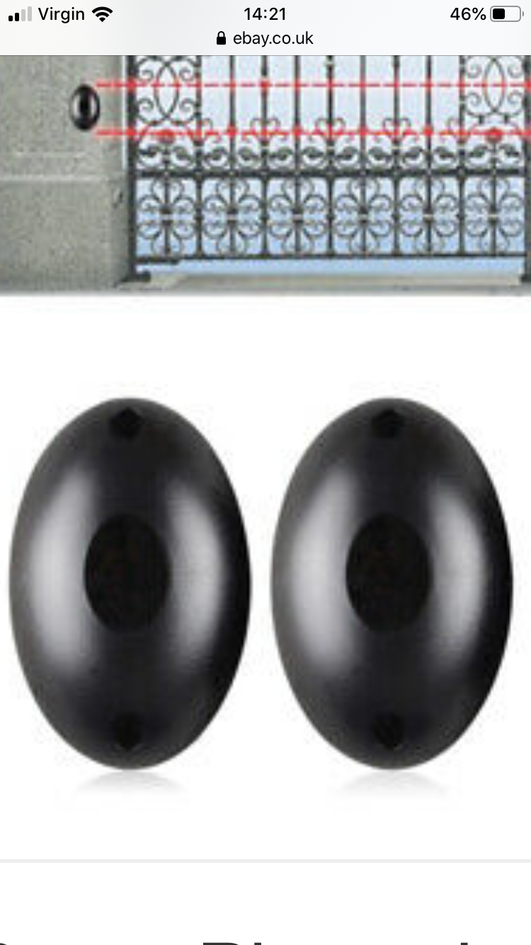

These ones
There's your problem, those are gate safety photocells, designed to be very fast acting across a short distance and probably too sensitive for this application. They're also difficult to line up on anything other than a flat and perpendicular surface. I'd recommend swapping them for something like a Takex PB-30 set. They're more adjustable in terms of alignment and you can tweak the response time as I mentioned above. It's worth the investment if you want reliability!
Thanks for info they are about 12metres part and very easy to line up.will take a look at the takex

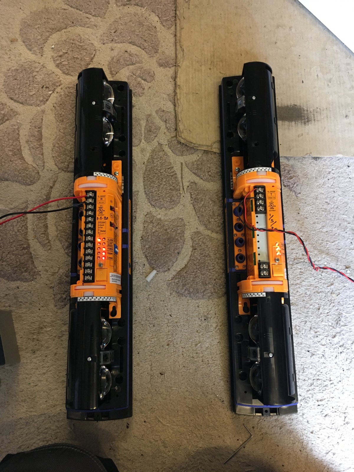

I’ve got a set of SL-350QDP Across my garage ....bit overkill but they only cost me £45 ( £250....RRP ) but not had any false alarms since install ( 12months ago ) and it’s set 20hrs a day ...
I have a texecom house alarm so reading instructions this one has a double knock (the beams are fixed about 2feet from back fence going across the garden )so if anyone came over fence and then went to go back it would trip. My other thing is they are under 3 large trees so my other question is if I change beams would the others be ok in the same situation.
7153D50F-7628-4C6D-8121-69DC731FE16A.jpeg Yours has single beam , most security beams will have 2 or 4 beams ....
