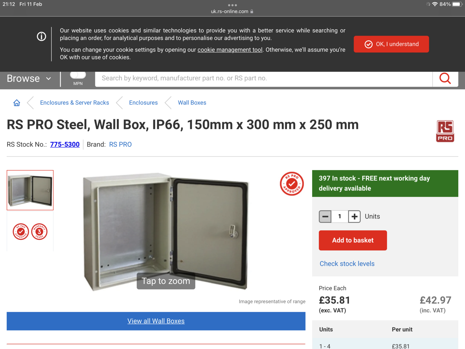

Hi, I've searched everywhere and can't find the answer to the questions below
I would like to have an external shutter installed however I have been told electrictrics isn't something they sort out and I would need an electrician.
The will install the shutter however leave the nvr control unit on the wall next to the shutter with a 1.5m cable. My question is, is the NVR unit safe there? Surely its not waterproof and secondly can someone get in to the rear yard and open the shutter by pressing the button. Secondly can I just extend the cable using a junction box (ip68) and plug it to my kitchen? If so how would I protect the wiring outside?
Finally is there anything else I would need to do to protect the electrical part of the installation outside?
I will be getting the electrical part done by an electrician however having prior knowledge when speaking to him will help.
Thank you

There are weatherproof enclosures that could be used
Thanks for your reply, the company have said the will install the shutter, provide the NVR and it will also have a 1.5m cable.
I would have to find an electrician who would place the NVR in a waterproof enclosure and also run the cable by extending in to the house.
Is this a wise idea and how safe would the nvr be outdoors from an intruder safety point of view.
Put it in a lockable waterproof box …..like most electric gate controllers ….
Thanks appreciated!! Last questions, apologies is advance.
There are no knockouts or holes for the cable to feed in/out.
Would they just need to be drilled
