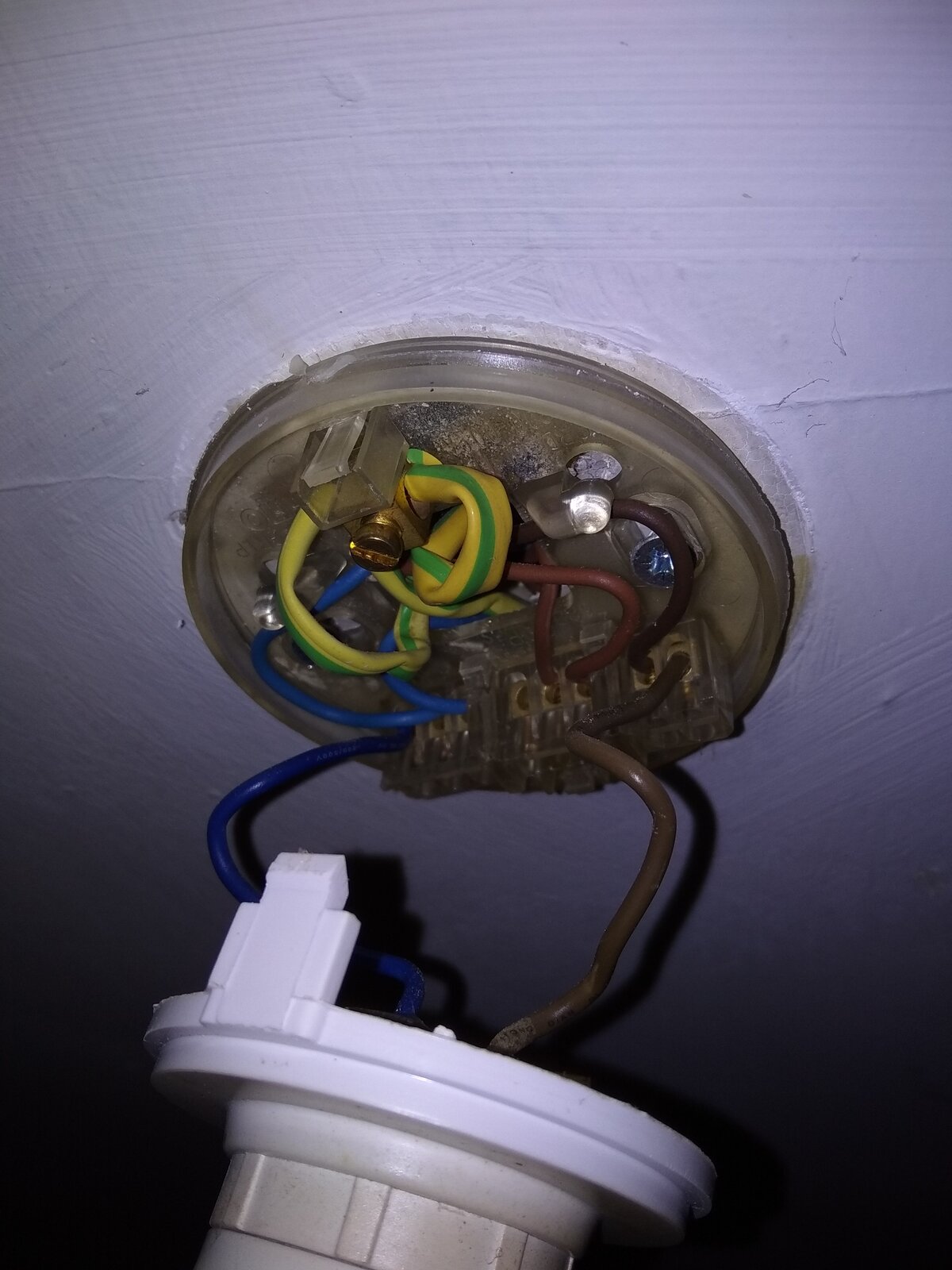

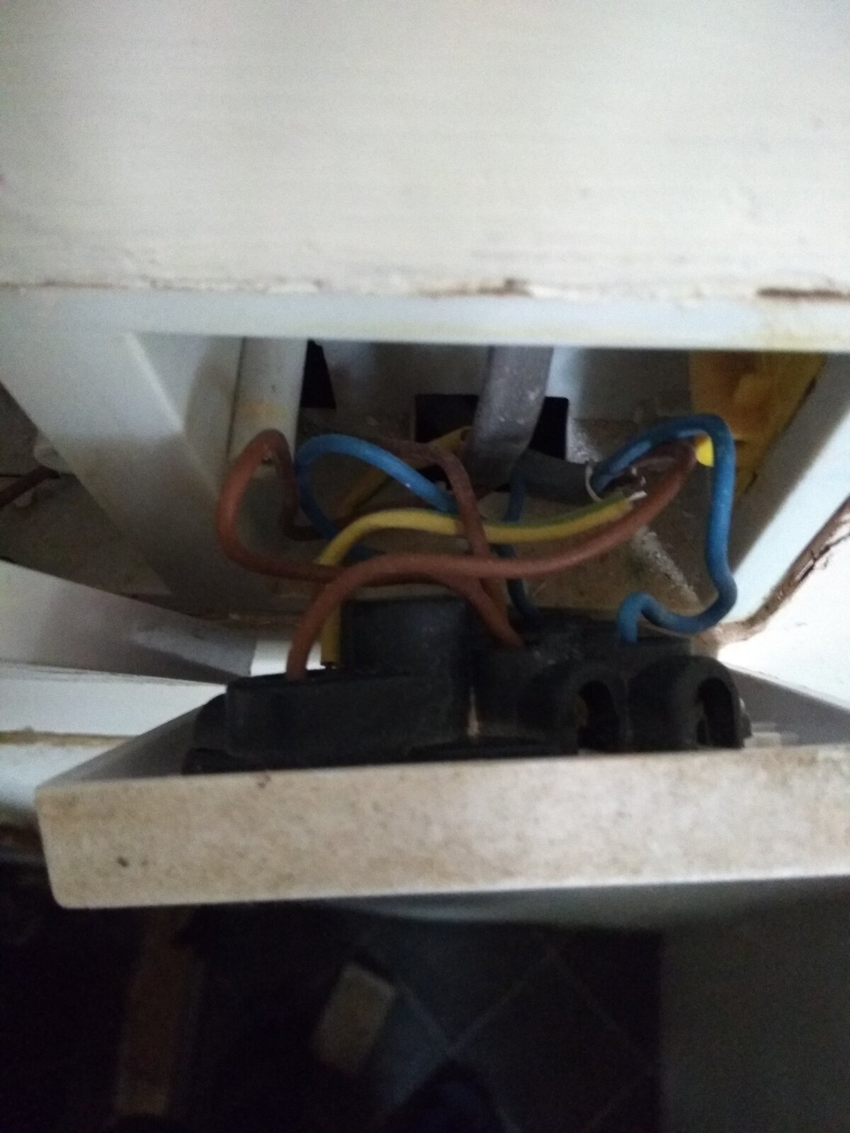

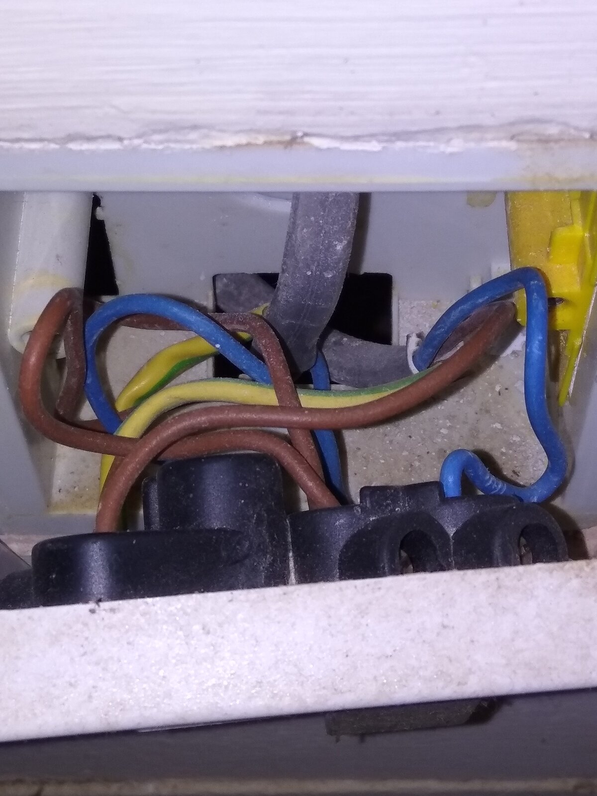

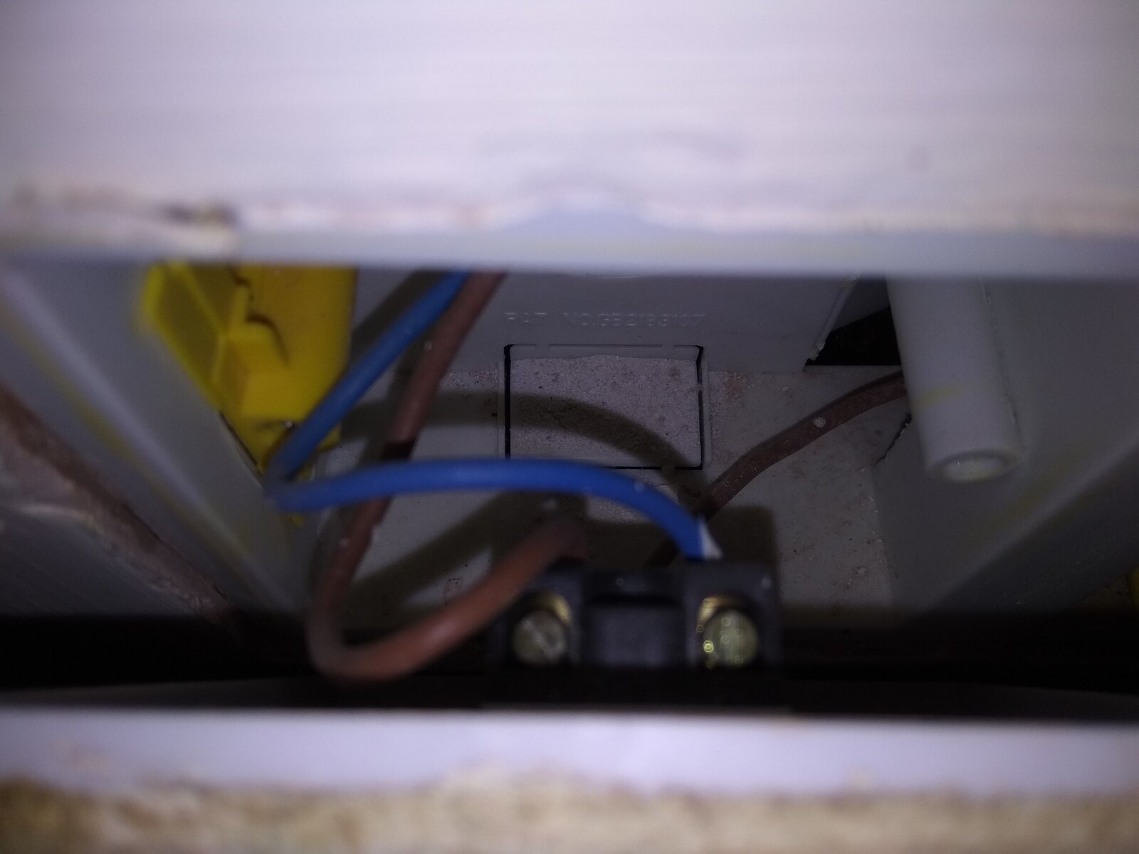

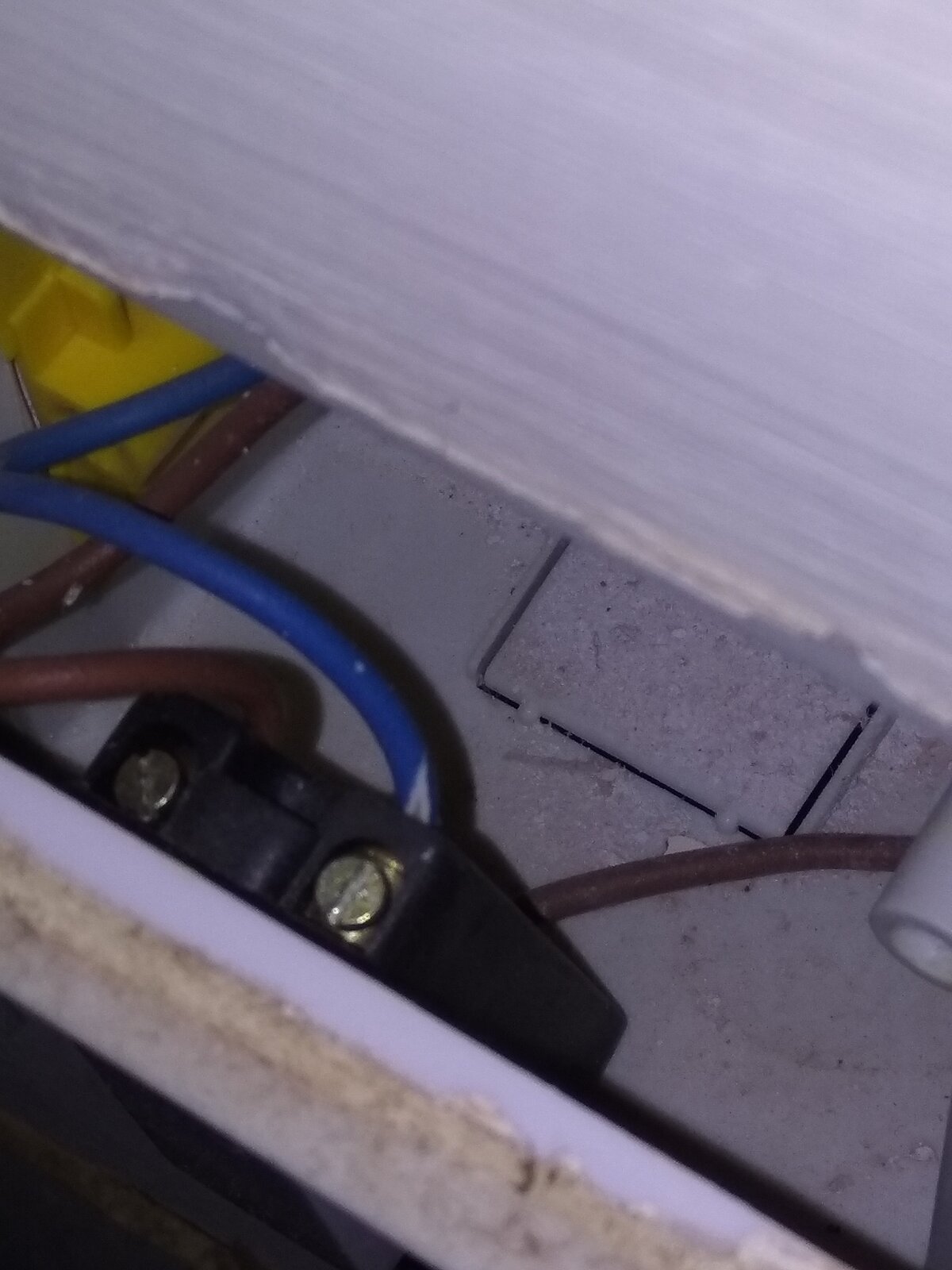

I have an existing outdoor light which stopped working. However, it is not accessible to replace as there is a plastic roof in front of it.

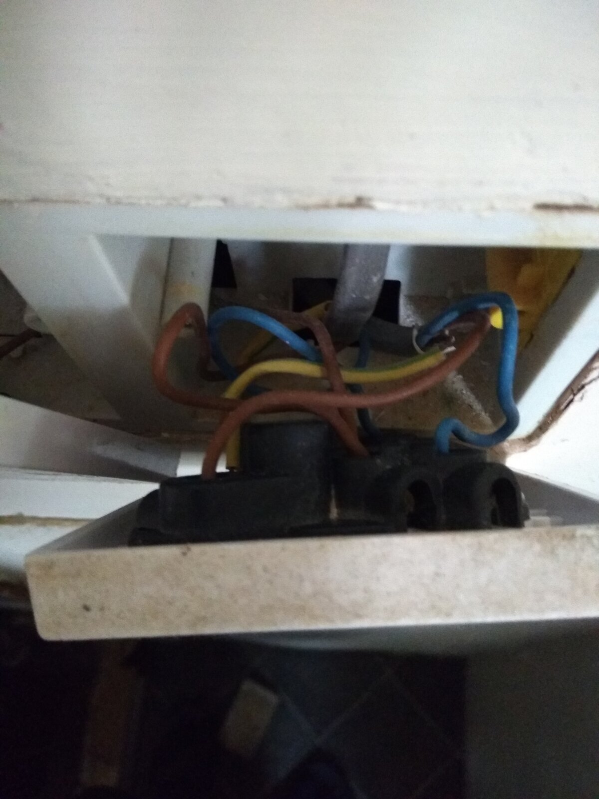

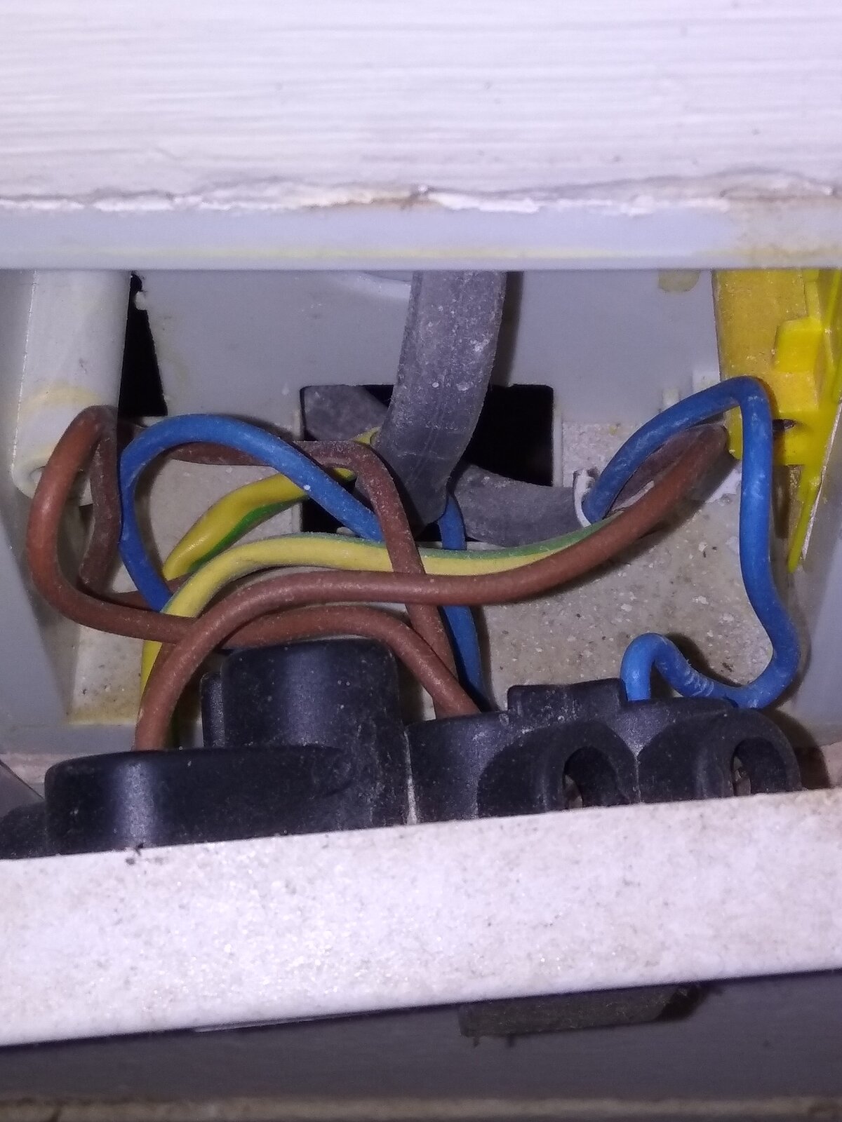

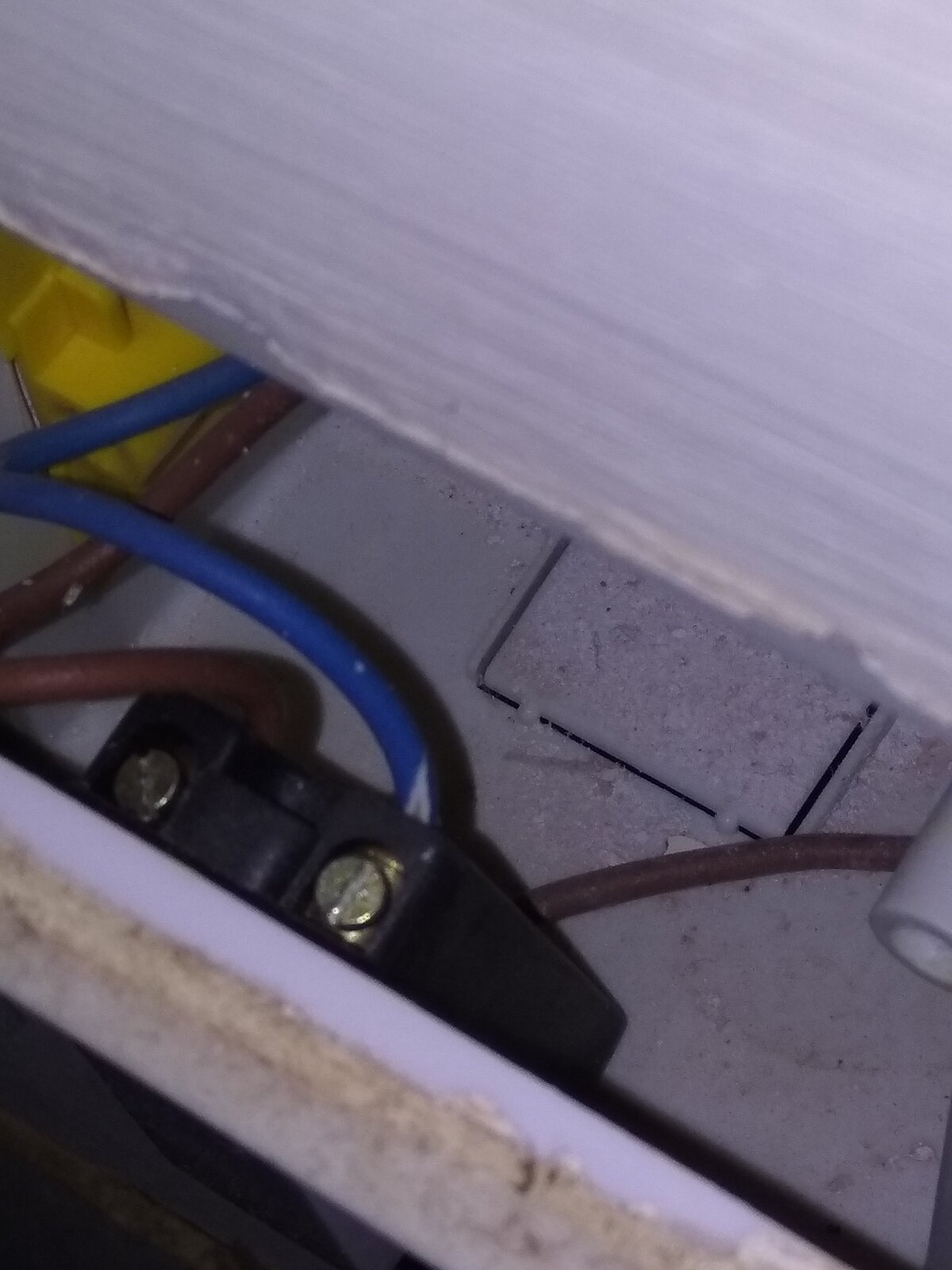

I was thinking of running a cable from the switch to a new outdoor light in an accessible location. It's easy enough to disconnect the current switched live from the switch to the old light and run a new switched live to the new light.

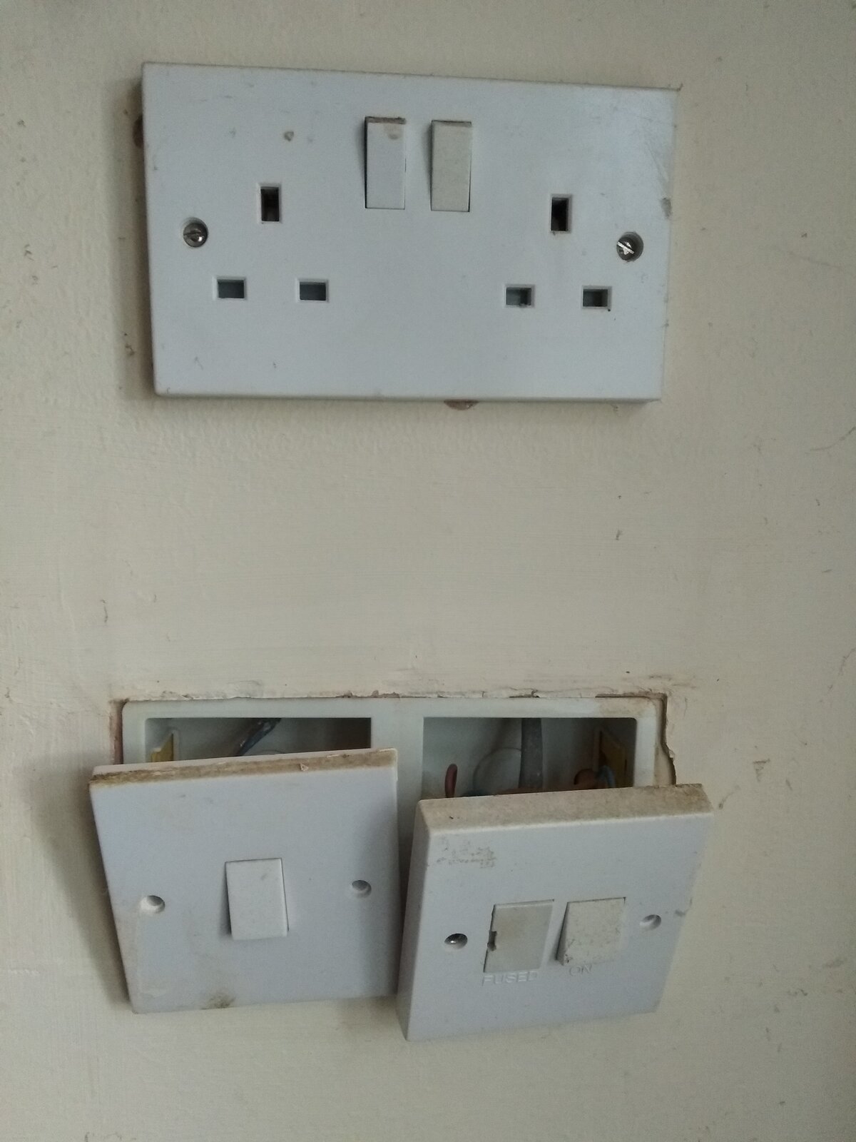

However, where do I connect the neutral of the light to? All parts of the old light is inaccessible, except the switch of course, so I have no idea where the neutral connects to, probably somewhere under the floorboards.
There is a wall socket near the switch. Is it acceptable to connect the light neutral to the neutral in there?
