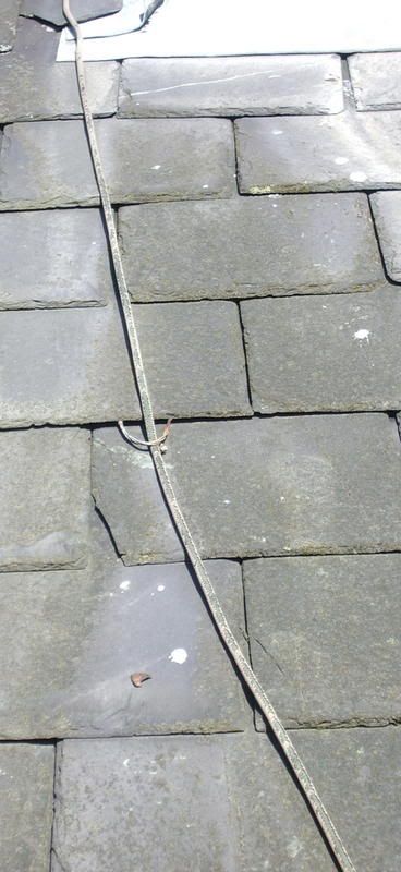

UV kills cables. Simple.
PVC T&E approx 2 years old.
Coax approx 10 years old.
