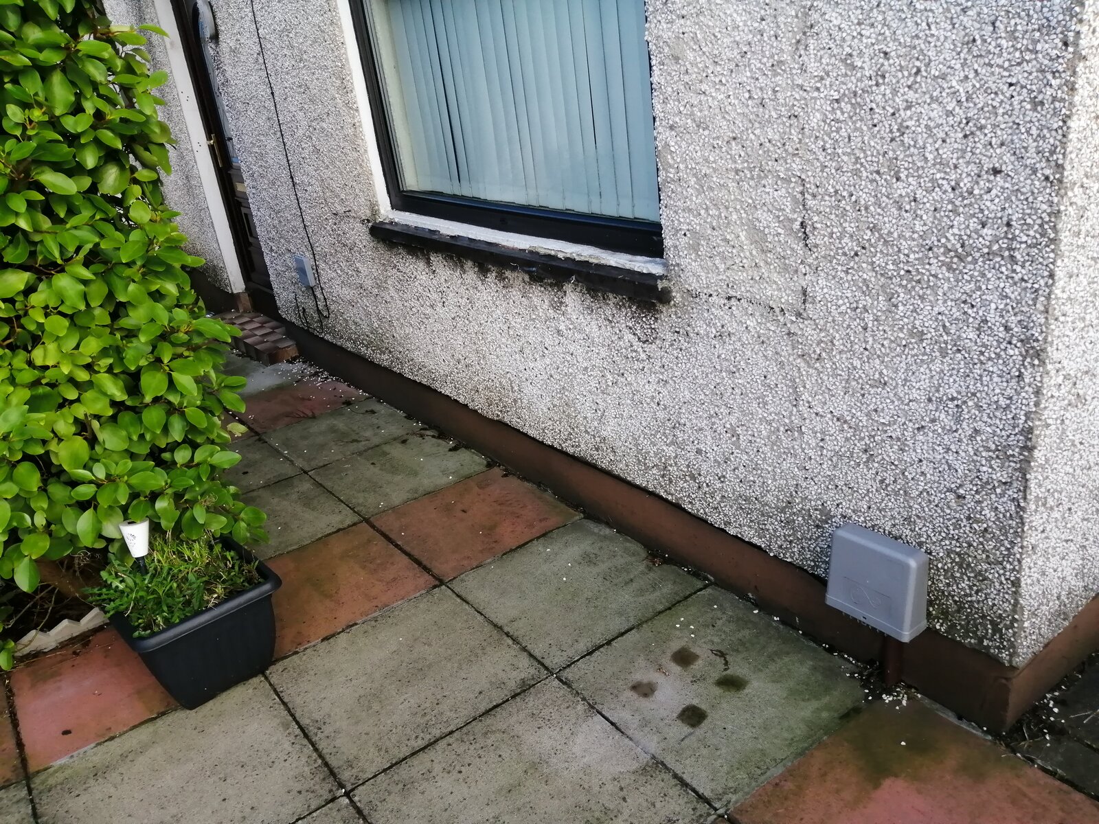

Hi All
I need to install an outdoor socket to charge my new car, it is a hybrid and can charge from a normal socket in about 5 hours so I don't see the need to purchase a "proper" car charger.

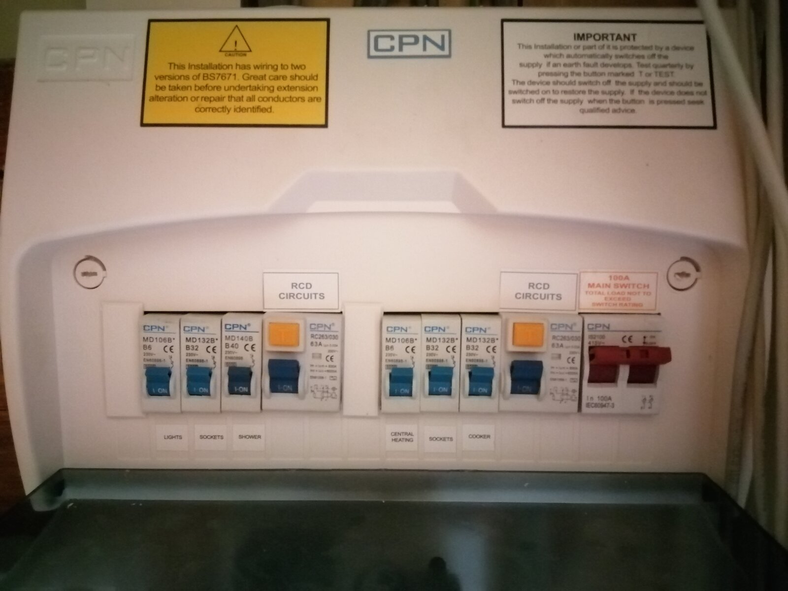

I plan to run this to its own dedicated 16a MCB in the consumer unit, my consumer unit was updated a few years back and is RCD protected.
The socket will be installed at the front of the house which is near the consumer unit, I have to run the cable externally and it is only a few meters away.
I am wondering does this need to be SWA or can I use outdoor rated flex?
From looking at the ratings of cables it says I could do this with 1.5mm, is this correct or should it be 2.5mm?
I have attached pictures of the front of my house, the socket will be going where the grey virgin media box is (this is being removed) and my consumer unit is just to the right of the front door.
Any advice on this would be appreciated.

Fit the socket higher than the rain splash area of the wall. This will reduce the risk of water getting into the electrics and you will not have to bend down so much when putting the plug in and out
Fit a two pole isolator ( disconnects both Live and Neutral ) inside the house. This will enable you to fully isolate the socket if ( when ) the socket is damaged and/or water logged. Switching off the Live is not enough, a Neutral to Earth fault will cause the RCD to trip. The isolator will also prevent people stealing electricity when you are not there.
The problem is safety, yes you can charge the car, but the car charger can freeze a standard RCD, so the charging station has a cut out which will detect DC, and at 6 mA DC it will auto disconnect so you can use a type A RCD, without that cut out you need a type B RCD, and the type B RCD is rather expensive, so cheaper to use the proper charging station.
The problem with electric car chargers is a fault can cause a RCD to freeze, so a fault in the house will fail to trip the RCD, and from what I can see from the picture you have type AC RCD so the one supplying the car will need changing anyway, but a type B is likely more expensive to a type A and a proper charging point.

I is not RCD protection for the car charging socket which is the problem, the problem is when it causes a DC current, which in turn freezes the main RCD so rest of house ends up with not protection. It seems some charging points auto turn off at 6 mA, but that only works with a type A RCD and already has a type AC so the RCD would need changing.

"I plan to run this to its own dedicated 16a MCB in the consumer unit, my consumer unit was updated a few years back and is RCD protected."
At the moment you don't have a spare 16A MCB. Are you proposing to fit one to the right of the left hand RCD?
