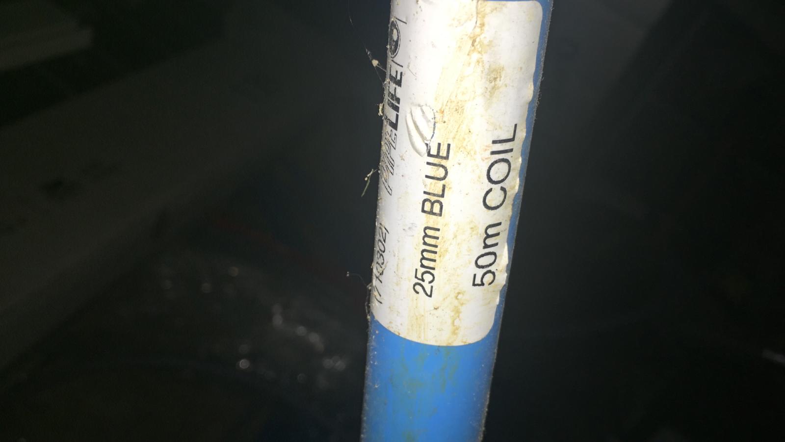

i have a blue pipe outside the house, heading up to my loft. This is the main supply.
I want to cut int this and fit an outdoor tap. Can someone please advise on this fittings required for this please.
Thanks in advance
Here a pic of the pipe
25mm equal tee and 25x15mm reducer or reducing to 15mm on the branch, a full bore isolation valve, double check valve any sleeving required and the backplate and tap of course.
Why is it on the outside? It's for underground/internal use as it's not UV stable. Maybe cover it with something?
