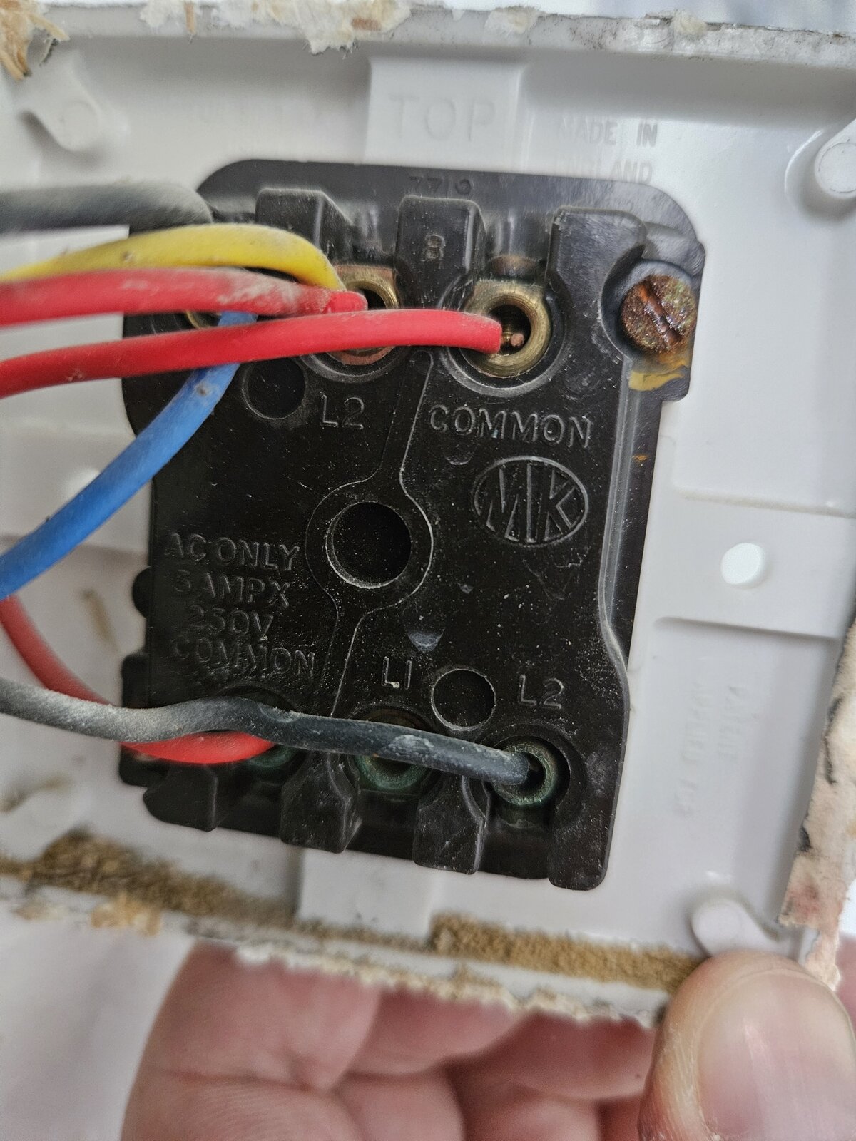

Hi DIY Expert,

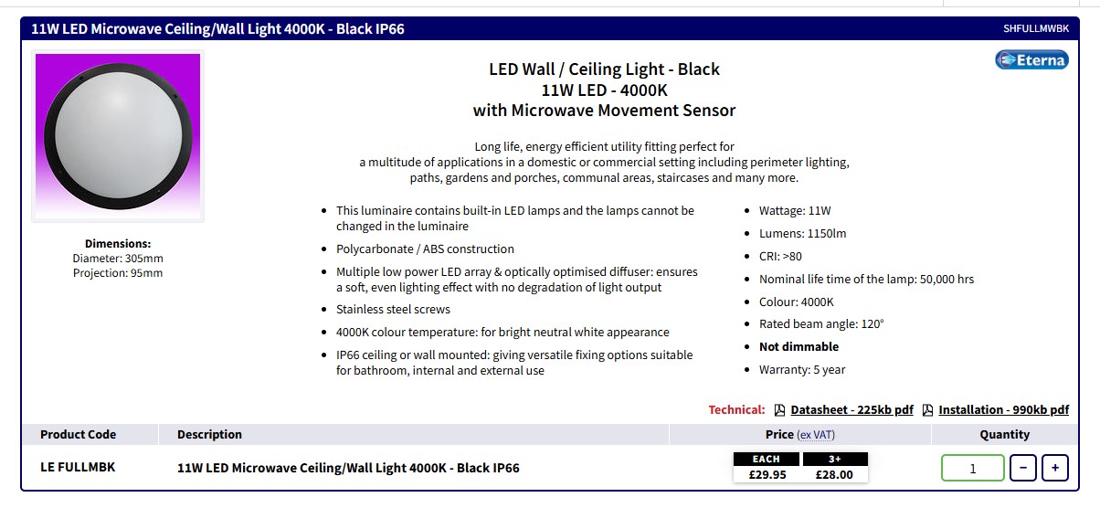

So we are looking to replace the outside light with a sensor one and have come across this model.
It is mentionned : Lumens: 1150lm and was curious to understand how bright this was. As we don't want something like floor light but something dim and gentle.

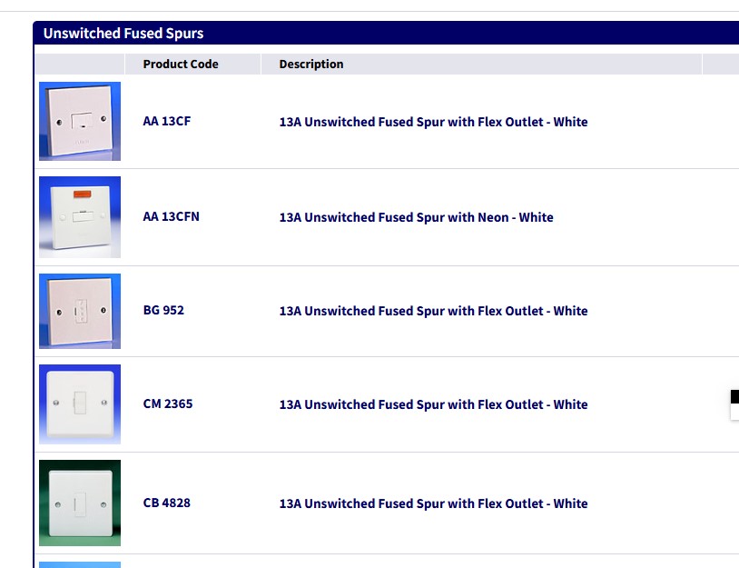

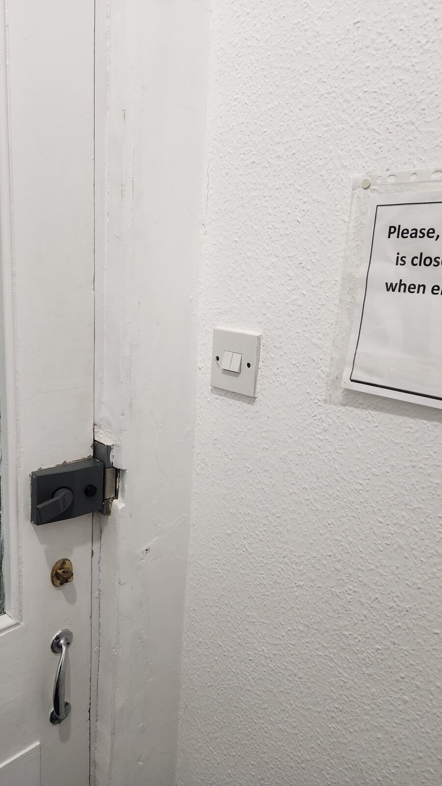

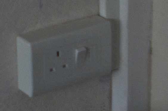

This is the existing switch with switch for the outside light and one for the inside one - I guess we would need to change that switch with something else so that the outside light is always on? (so that the switch does not get accidently switch off?) May I check what would be your recommendation for this? I was looking at switch but unsure what to select -I came across these but these have only one switch and not both and wondering if there is anything else possible that we can get.

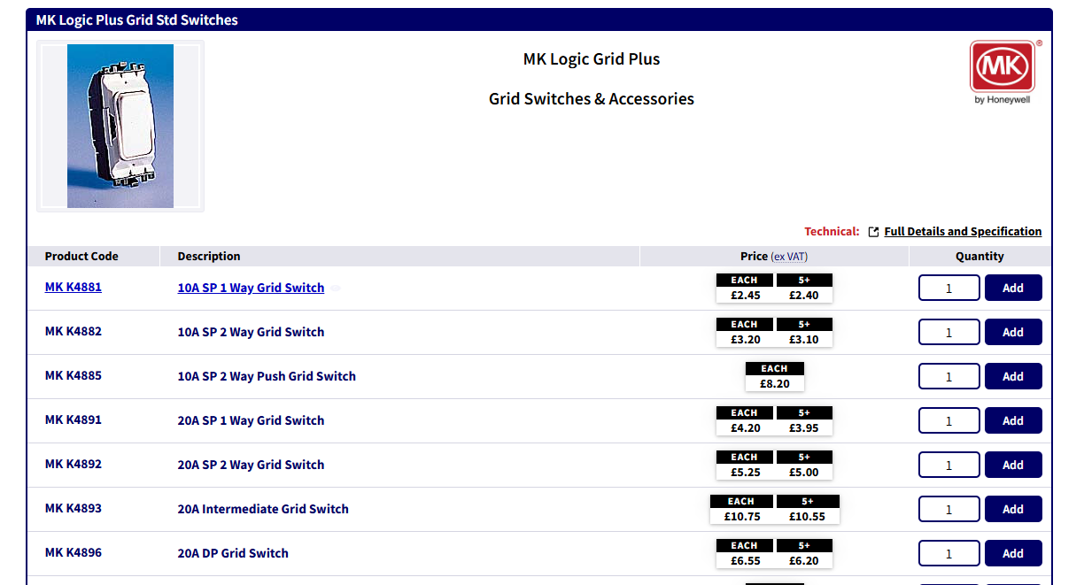

I would use a grid switch with a keyed switch for outside light 1734165716669.pngso if faulty easy to turn off until fixed, an you can still have standard switch for inside, if using a fuse, then again grid switch so again alongside standard switch.

oh amazing!
So a plate like this
with a key switch
and a normal switch
Thought there are so many different range of switch - any recommendation on which one to go for?

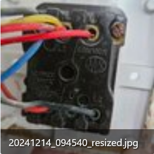

I know I should really get an eletrician to do the job, but I feel with the right advise, I should be able to do it easily. (i know I need to switch off full electricity before to venture closer to touch anything)

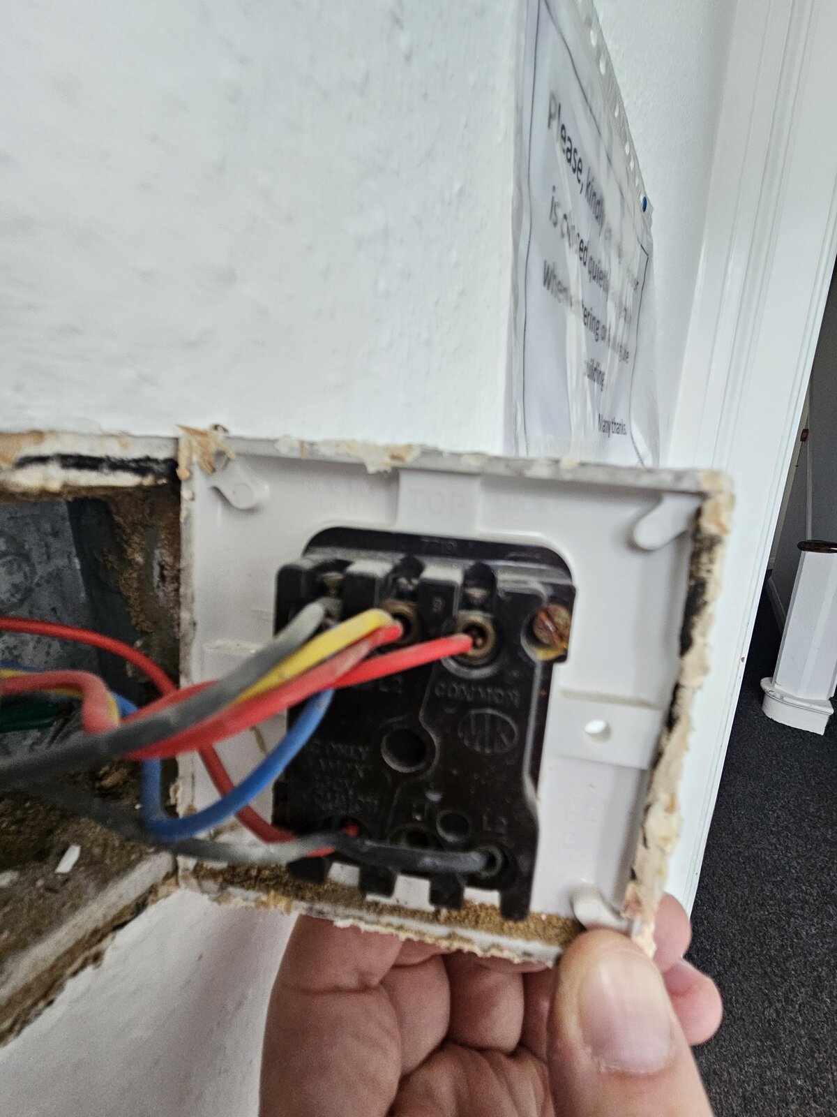

I just open the switch as well earlier today and might need further direction on which cable refer to which bit so when I get the grid plate and switch and key, I connect everything properly together.
Any directions, tips welcome :-)

1734172279570.png Left hand switch is two way, right hand as shown in picture simple on/off. I used the Screwfix own LAP grid system here to combine a socket, fuse, and switch into one plate. IMGP7387c.jpg You can basic design what ever you need to suit.
You would need the grid, faceplate, and the switch modules - key switch and 2 way. Other brands are available, stick to one for the whole assembly though. The site linked also lets you know what depth backbox is required, I would guess yours is a 25mm which will be fine for the above - worth double checking though.
If you do decide to have a go, even though you have photos make sure you mark clearly any cables where you have 2 or more the same colour
And go for the MK - far more robust and reliable than other makes
And a word of warning that looks like a 25mm back box so don’t be surprised if it’s a very tight squeeze. If you get a spark in get them to fit a 35mm back box
If the light will be outside, always better to fit a double pole switch, to ensure both L and N are isolated/ can be isolated, in case of faults.
Thanks for the feedback, Would the key switch not be the answer to that?
Depends. If it has four terminals, and the neutral passes through the switch, then it can be isolated.
Idea is - if water should get in the light, or external lighting circuit, it can cause an RCD/RCBO protected circuit to trip. A double pole means of isolation, allows the faulty circuit to be completely isolated, just isolating via a single pole, would not help - the rest of the lighting on the same circuit, can then remain in use, until the fault can be investigated. It also makes fault-finding, much easier. The alternative, is to either manage without the rest of the lighting on the circuit, or investigate the problem immediately.
