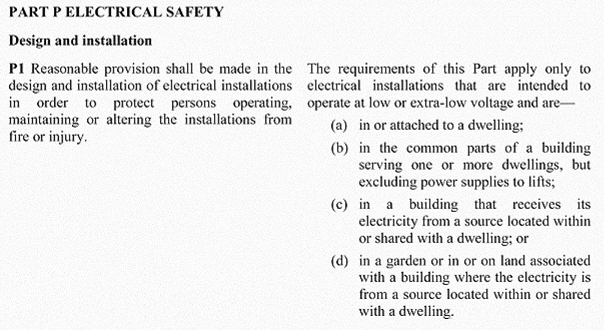

Attached is section 3.13 I was referring to.
Do you know the section in the BS that relates so I can see what I need to get done.

This is Part P of The Building Regulations:
That's it. There is no more.
Anything else you read is just something someone else has written.
It's only been sixteen years since it was introduced.
Yes I was referring to the AD which is not technically the BRegs Part P requirement, and I appreciate the AD isn't the only way of complying with Part P; but in lieu of not complying with the Approved Documents that follows the Part P requirement, usually the alternative is to follow BS requirements as "Reasonable provision" - which is basically where we have ended up anyway. Unless you are suggesting there is something else I can follow?
The usual method of compliance with Part P is to comply with BS7671.
BS7671 requires that an appropriate certificate is completed for all electrical work.
The vast majority of electrical work in England isn't notifiable. Only replacement consumer units, new circuits and work within the zones of a bathroom are.
