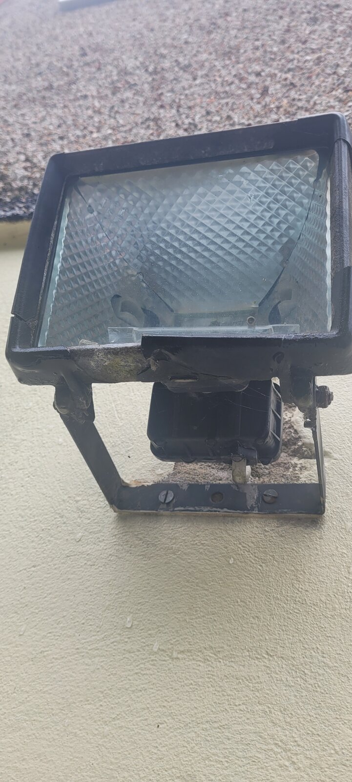

Here are photos of it.

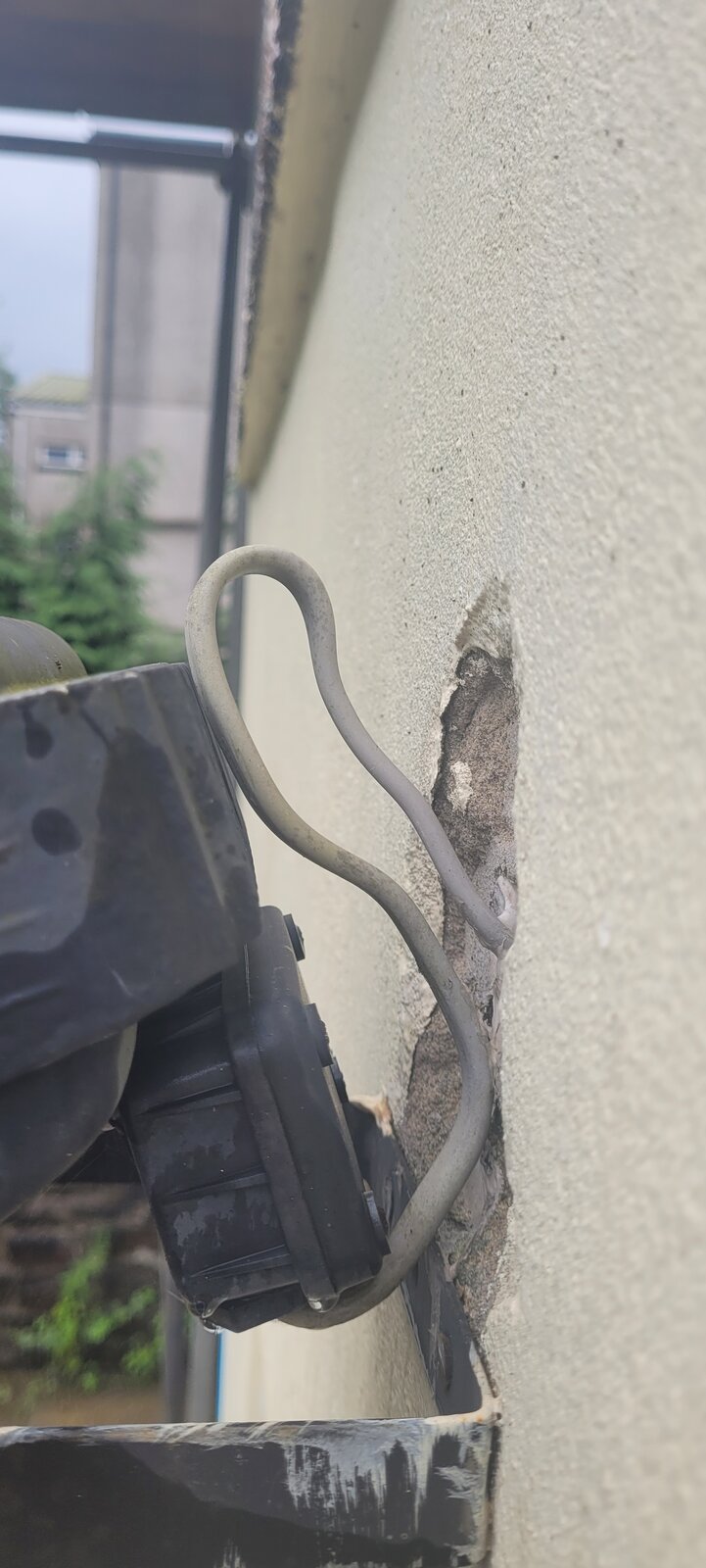

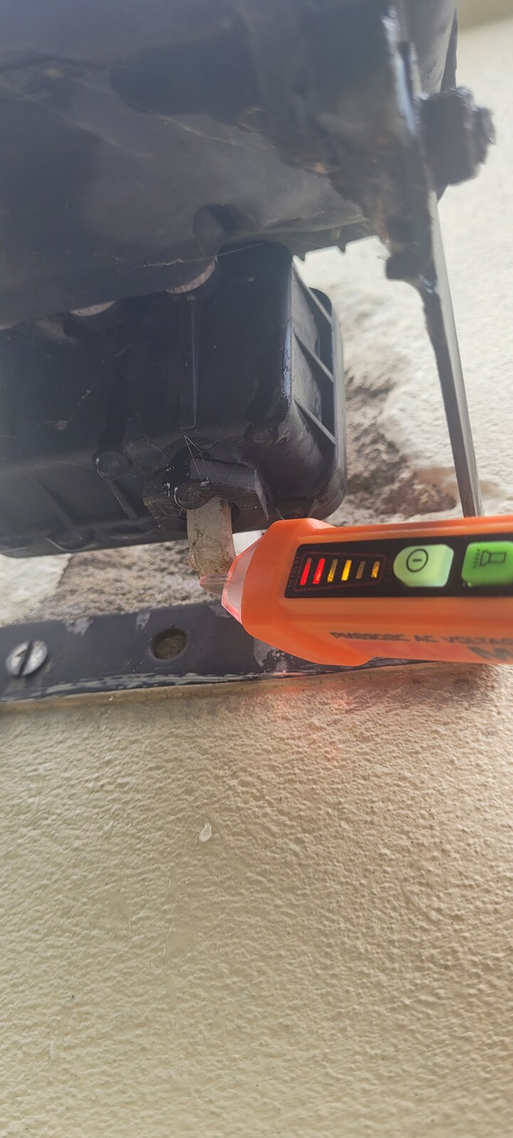

The outside floodlight:
The wire coming out of the property into the floodlight:

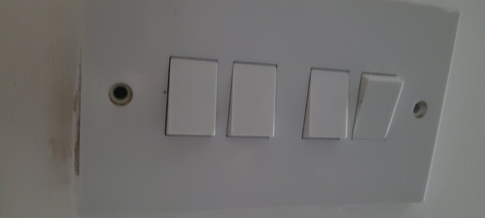

The 4 way switch panel that controls the light (the 4th switch turned on is one that turns on floodlight as confirmed by volt stick in later picture):

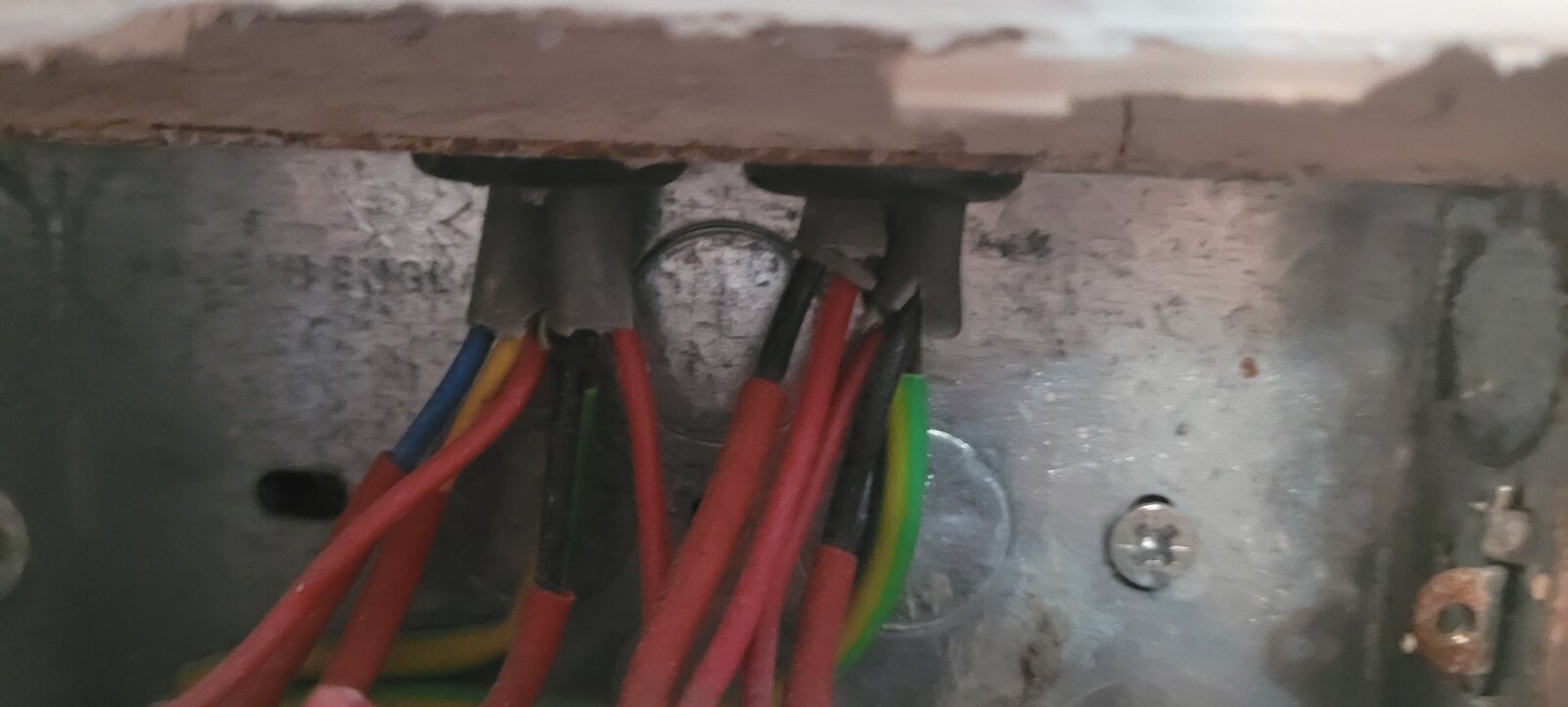

The wiring coming out of the wall behind switch plate (the wire on the right most side is one going to 4th switch):

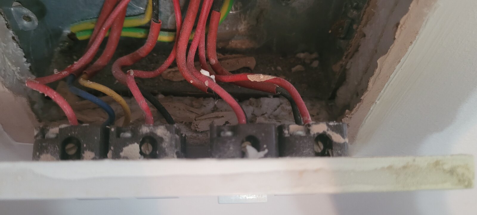

The wiring behind the switches (switch on right hand side is the 4th switch controlling floodlight):
Volt stick confirming when 4th switch is on there is power:

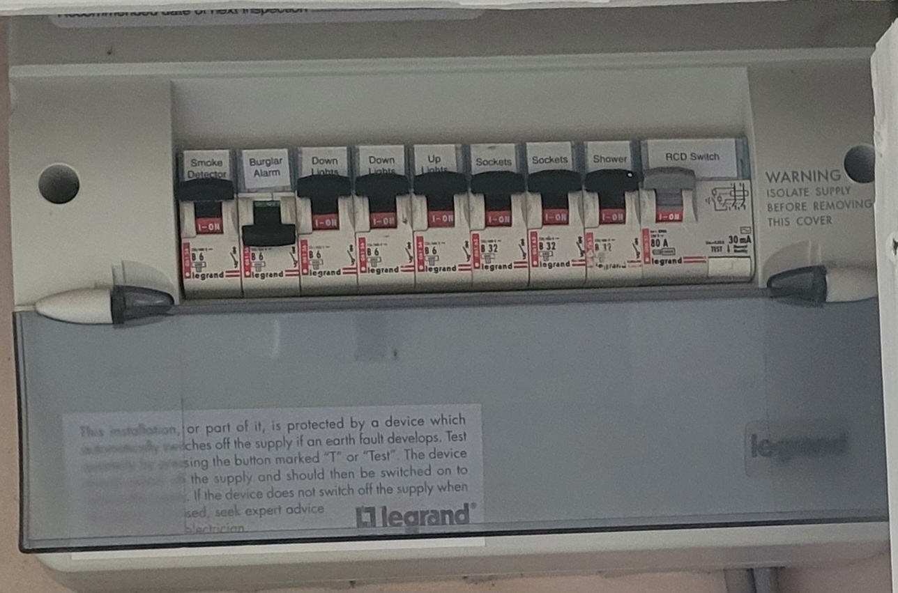

CU:

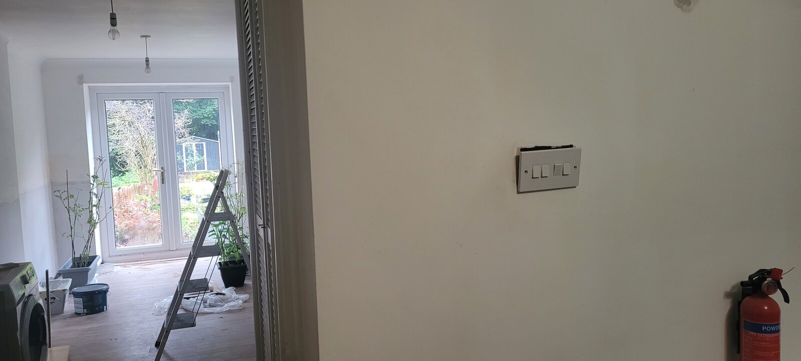

The lives do not seem to be looped at the switches, just one live in at the top, black switch wire marked with red sleaving in the bottom terminal. If you disconnect the latter wire, the one with the red sleaving, then your light cannot then be turned on, but there is no sign of any neutral connection in there at all.... Which is a major problem for you.
You will need to trace out that cable, to find out where it has sourced it's neutral connection, and disconnect it, before you can tackle removing that light and cutting the cable off. If you were to simply disconnect the switch-wire, cut the cable and insulate the end, the risk is one of nuisance tripping of that single RCD...
As you only have one single RCD, my suspicion is that who ever wired it, might perhaps have 'borrowed' the neutral from an upstairs circuit. Basically the live comes from your cellar circuit, the neutral taken from either the upstairs, or the ground floor circuit.
Another possibility, is that the cable feeding the light, comes vertically down the outside of that wall, buried under that render, then goes through the wall at ground level, to enter the basement. That would suggest the neutral has likely been sourced from the correct circuit, the cellar circuit, making life much easier for you...
Have you got access to some sort of metal detector, and could perhaps check the wall for a buried cable under that render?

This is where the switches are. The floodlight in question is above patio door at end of this photo:

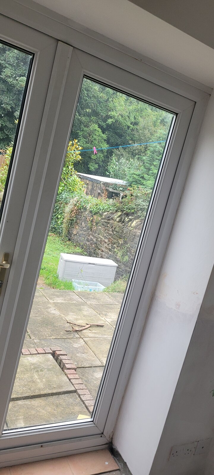

This is the patio door, and there is a double socket to the bottom right, which has a plastic white conduit on the outside:

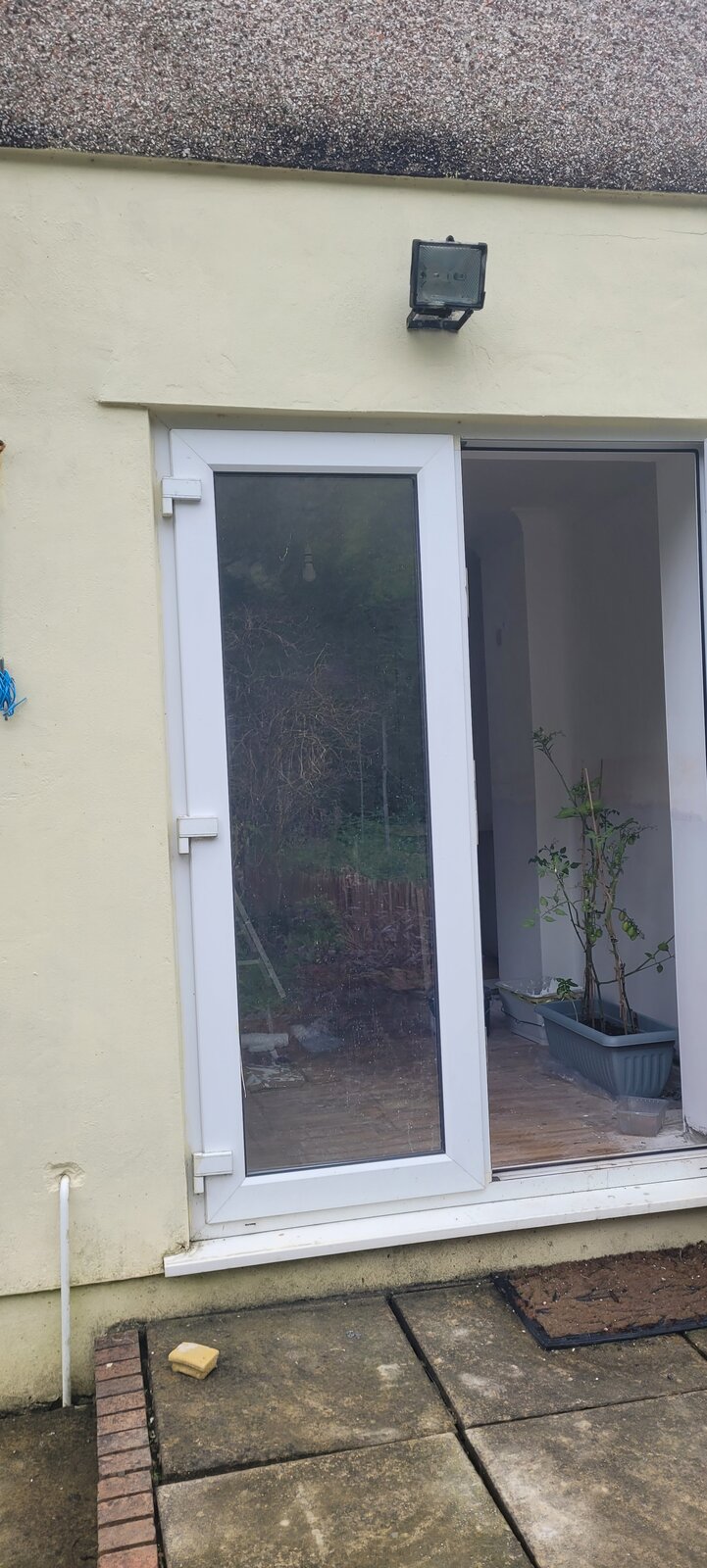

This is the outside view of the floodlight, and the aforementioned conduit:
I must admit, I was half expecting the cable to go straight down, under the render, into the cellar.
At this point, I think your only way forward, unless someone else can offer ideas - is to use a signal injector and tracer. I'm sure you will not have one, and not many electricians will possess one..
