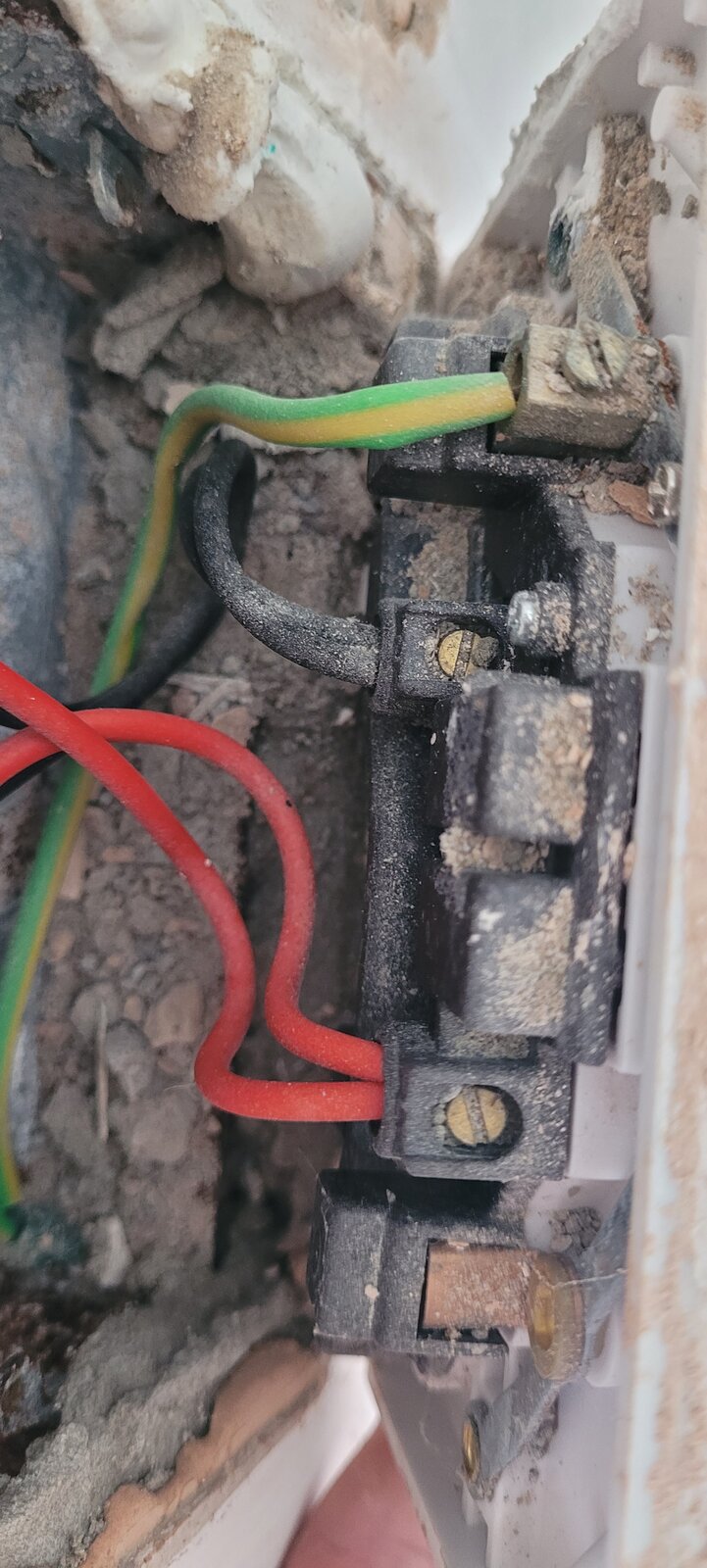

Just been thinking, how would I identify if the neutral is connected behind the sockets or in one of the light fixtures?
Is there any way of detecting with a volt stick or similar if I turn on the switch for the floodlight and have everything else switched off?
Yes, with everything off except the light, and supposing a load of some sort were added, in place of that none working light - Then a clamp-meter, would be able to identify any neutrals, through which there was current flowing.
Doesn't look like anything easily identifiable on the double socket next to the patio door where the floodlight is:

The neutral, should correctly be sourced, if it has been installed properly, from the very same source and MCB, as the one which supplies the light. Which means it should be connected to the neutral, of your cellar circuit. If it is (wrongly) connected to the neutral, borrowed from a different circuit, then it is called a borrowed neutral.
The borrowed neutral, if it is borrowed, would not be obvious at the moment, due to all your circuits appearing to be fed from a single RCD, and individual MCB's. If in the future, the RCD + MCB's are upgraded to RCBO's, a combined RCD + MCB, one per circuit, then you will suffer tripping of the RCBO's, due to the borrowed neutral.
It obviously not connected to that socket, in the photo, but there is an issue with that socket - the amount of debris. The debris, might - I said might, cause a low value on an insulation test of the installation, should it become damp. Were it me, I would turn the power to the socket off, and see if I could clean it out with the hose of a vac., and maybe the use of a paint brush.

The socket debris isn't a problem for me. Like I said earlier, we have only just purchased and moved into the house and doing some of the initial renovations, such as painting, flooring, and removing random things like this floodlight. Once decorated, all sockets and switches and light fixtures are going to be changed to ones we prefer and more decorative ones than the standard plastic white ones here at the moment. Therefore, all sockets and switches will have any debris and dust cleared out at that stage.
