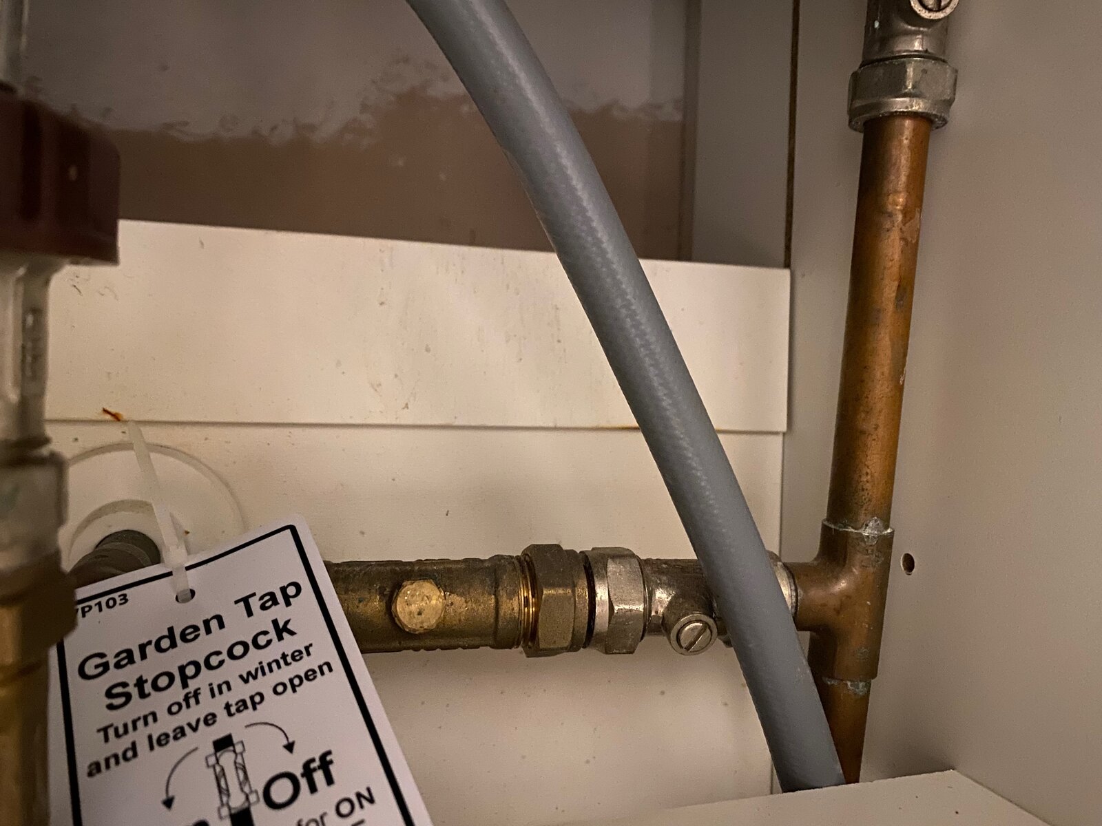

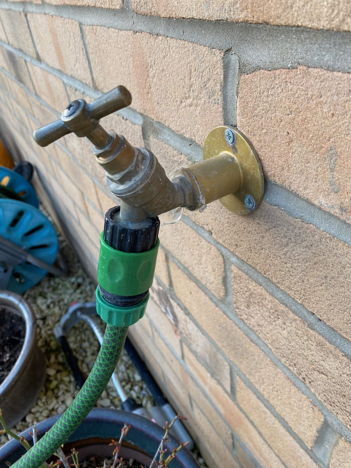

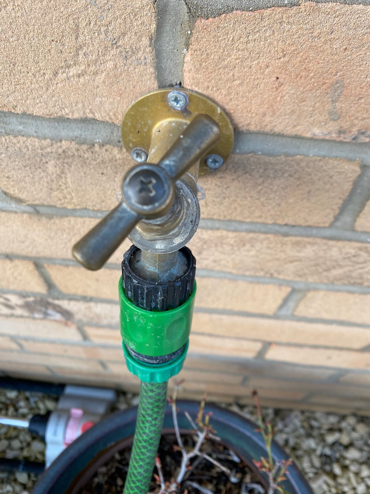

photos of the tap as requested.
Doesn’t appear to be the check valve inside the tap type, so either failed check valve inside, or a possibility that the washer has stuck at the tap. Before doing anything - you’ve not turned it off for winter or any other purpose have you?
The brass fitting ,next to the Chrome isolation valve ( that's partially open by the way) is your check valve and may be stuck closed.
If you unscrew the outside tap from the wall plate and no water flows out ,the check valve is the likely culprit.
If water does flow ,buy a new tap.
Hi terryplumb thanks for the input. If it is the check valve is stuck closed, can it be manually released or is a new one required?
