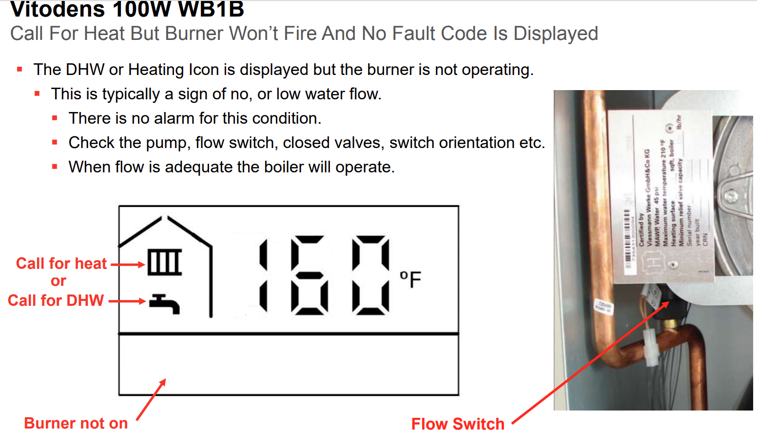

I have installed a dedicated boiler Viessmann 100-w heat only boiler with external pump and an EV on boiler's flow. The intent was to connect it to a vented hot water cylinder.
I have filled system with pressure guage showing 1.5 bar on boiler piping, the boiler turns on but it keeps showing the temperature on display. It doesn't go through the ignition sequence even in 'SERV' mode. I have checked with viessmann and the boiler can be used for open or sealed system.
Could it be a circulation issue because these boilers work on the principle of 'no flow no go'. Any ideas or suggestions please.

All valves open? Invariably the first thing to start in the sequence is the pump, not sure if that particular boiler has a proving switch that then allows the rest of the sequence to activate.
All valves open. The boiler has a flow switch, I'll check if it works.

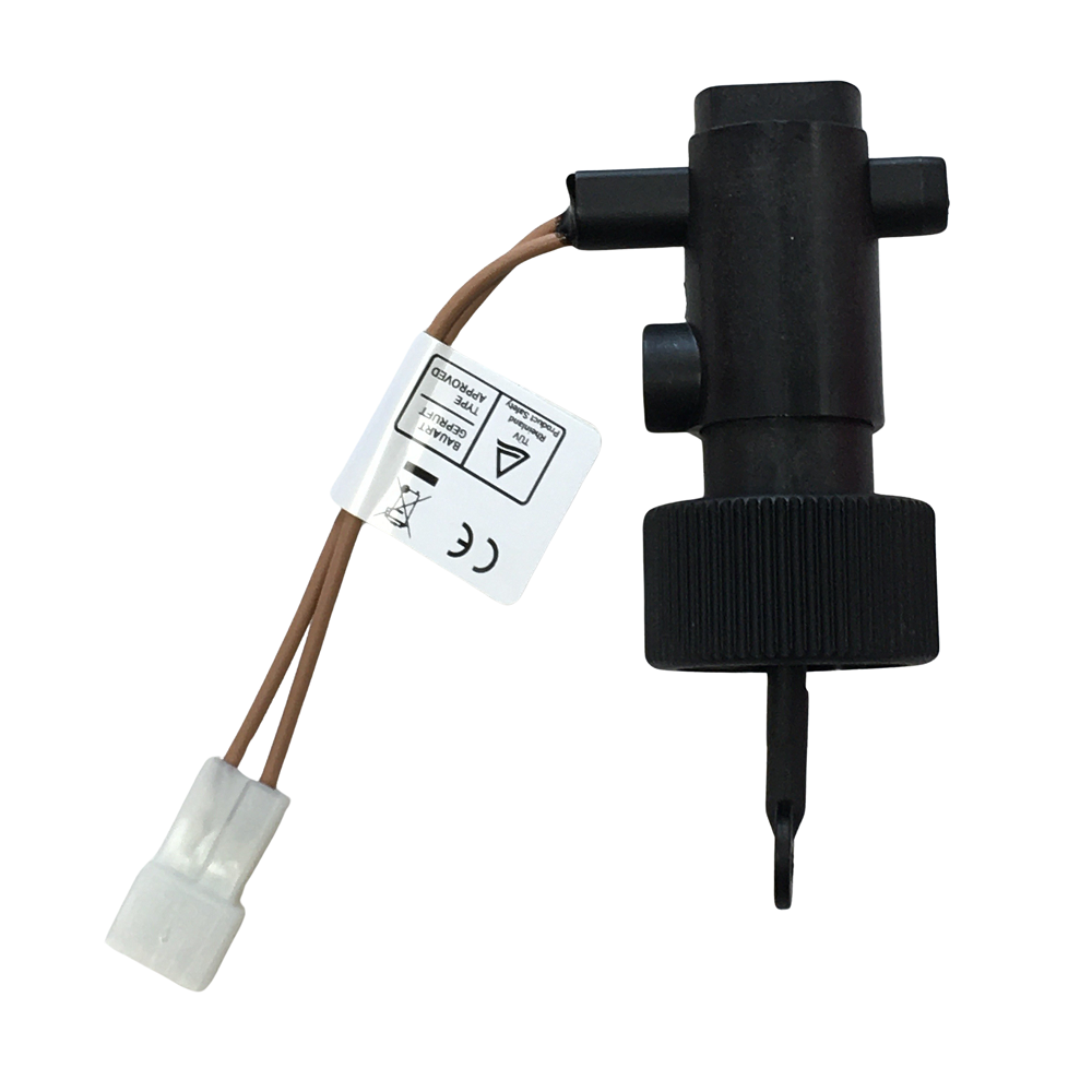

I am facing the same issue. Before I install the boiler, I opened the flow switch to service it but couldn't get it out completely so turn the sealing nut back on.
After installing the boiler I am facing the exact symptoms. Any ideas., Can't get flow switch locally.

Not sure if that switch can be tested/shorted out
Can you feel the pump running at initial start up, is it actually turning? If so then it can really only be another couple of things as indicated by the fault finder. As far as getting the flow switch out then difficult to say without seeing it, never had to replace one on that boiler before. That being said it, it looks like it's just a knurled plastic nut that undoes and then the switch should just pull up and out, probably just tight in there. Not cheap to replace though.
Apart from that then time to start ruling out things then I guess. If it came to it, I'd bypass the system and run the flow directly to return and see if it starts. That'll rule out the boiler as the issue.

I managed to get the flow switch out.
After putting it back into boiler, when i start it in 'SERV' mode, the boiler did fire (previously it wasn't firing).
