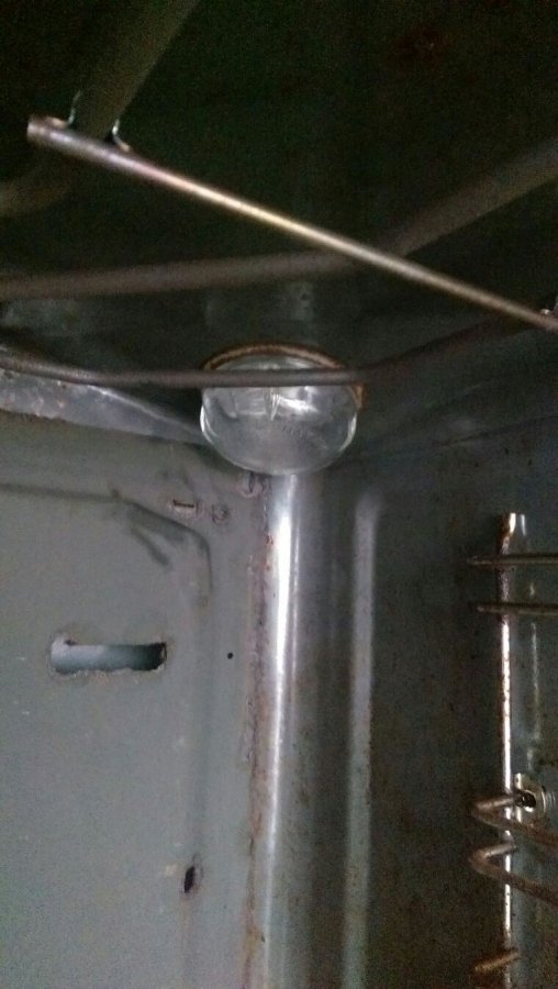

Hi all
The attached oven bulb is stuck; just turns in either direction but can't seem to be removed.
Is it just a case of wd40 and a good tug?
Thanks in advance

Is it an Screw in "Small Edison Screw" (SES) bulb? If so it needs to be turned a few times to remove it. Isolate the cooker first.
Is it the glass globe that's stuck, Mr.P?
It could be bayonet or screwed, I fear - but a little WD cant do any harm......keep it off the elements though, they'll pong afterwards.
Keep working the thing - it'll give up eventually.
John :)
Thats the cover for the bulb, usually bayonet so 1/4 turn anticlockwise and pull.Some are not accessible from inside the oven , is there a small cover on the outside casing?
