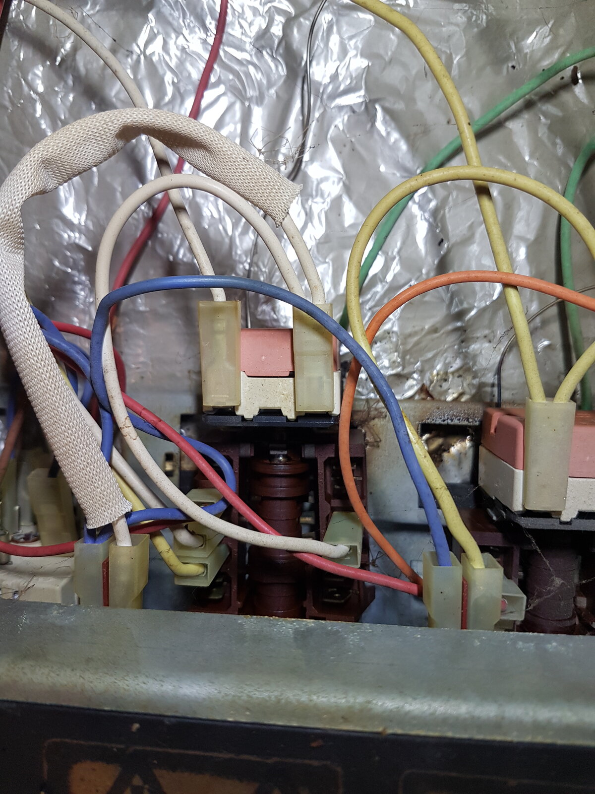

I took front panel out and tested thermostat switch, getting a reading of around 0.09, is this normal? I'm assuming I tested it correctly. Attached a few pictures below.

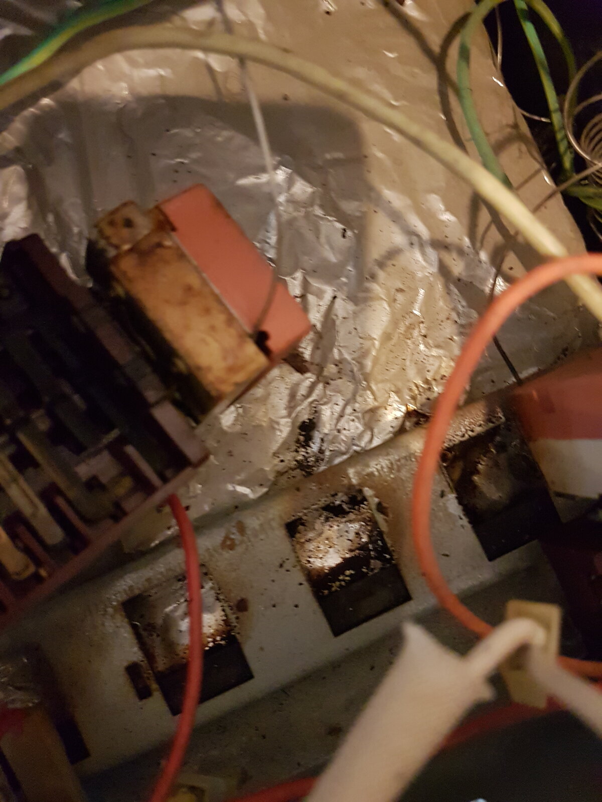

The bottom of the thermostat switch unit is quite brown, possibly from burning out?? There was a dead spider attached to part of it.
Bottom is a bit brown/black and looks like a bit is broken off?

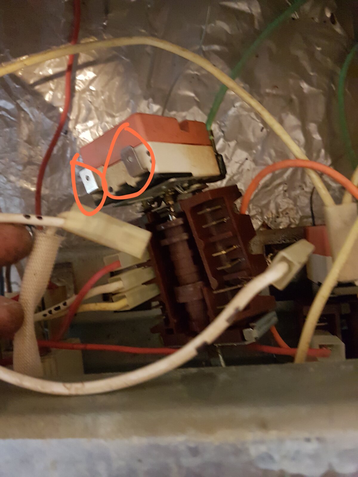

After disconnecting all wires I put multimeter on the two terminals circled in red...

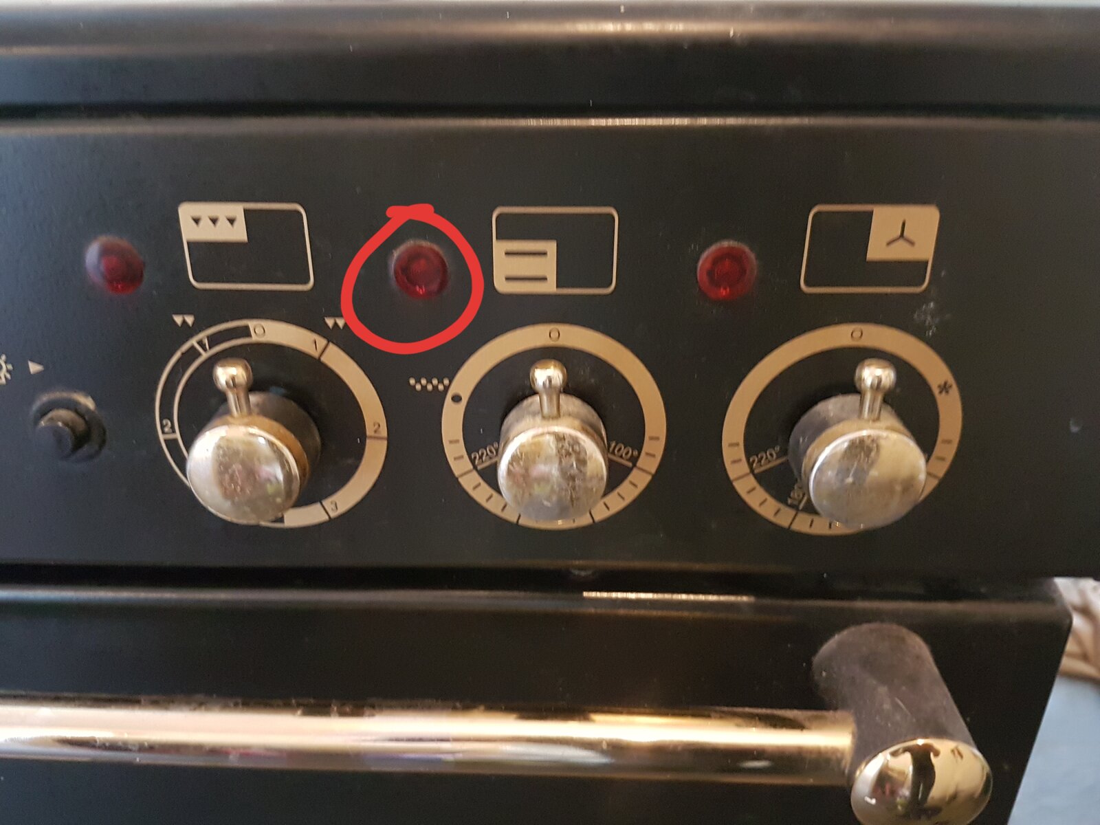

Sorry I've edited my post as it was misleading... it's not the oven light as in internal light, I meant the red light on the front next to the on off dial. That's the one that's always on, even when not in use.
Thanks. The switch still works fine, turns oven on/off etc if that makes a difference?

You will appreciate it is difficult to be sure from a photo - The blackening will be due to old age/ lots of use/wear and tear in a heavily loaded component. Resistance in the contacts make them generate heat, the more heat the more they become damaged, generating even heat.
Absolutely, I wouldn't expect anyone to diagnose fully without seeing it in person. Thanks for your help. I'll try and locate one of the switch units and replace it. I think you can buy them without thermostat attached for about £30.

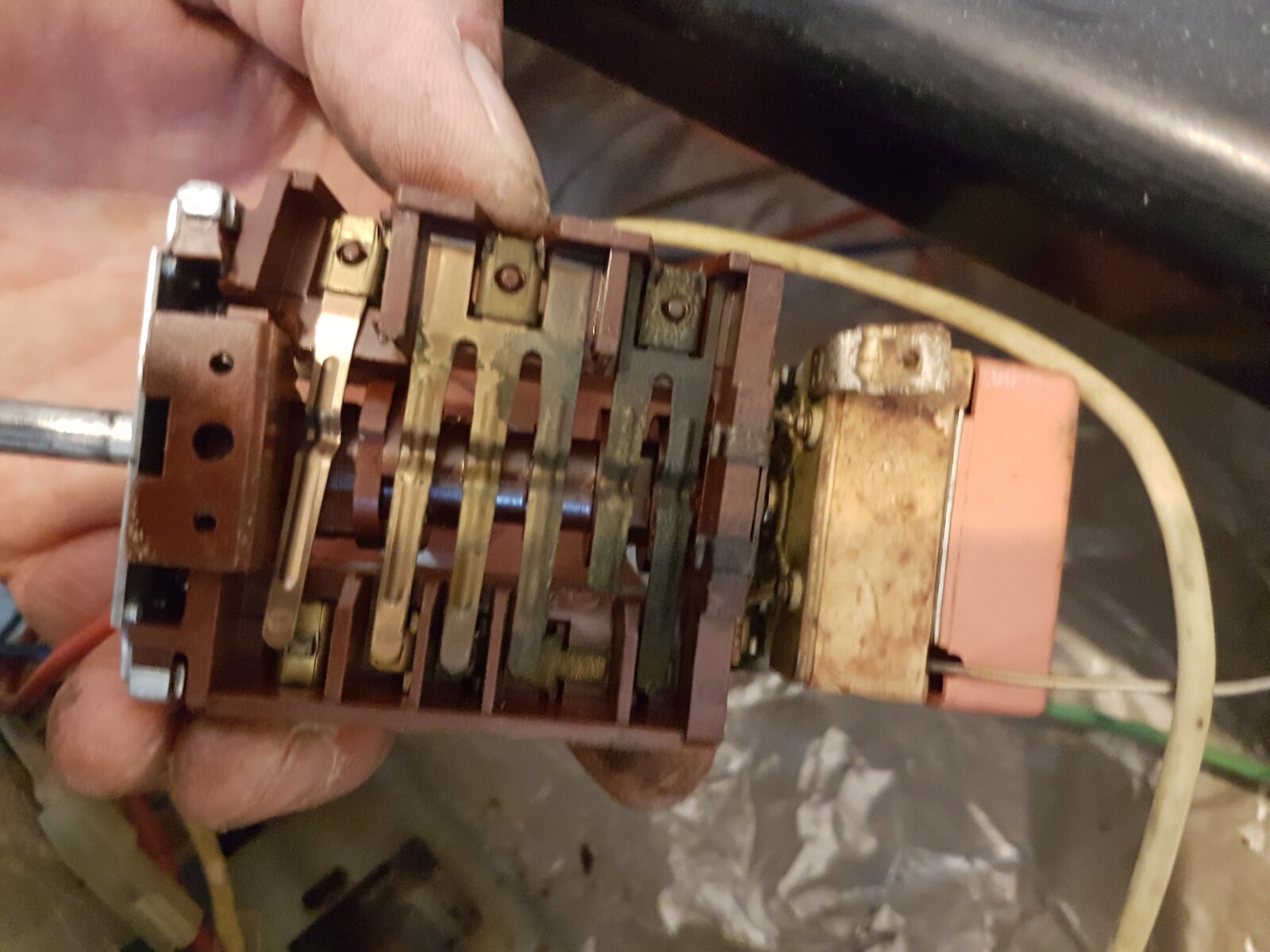

That's right. So you have the oven control switch unit, then attached to that is a small white module, attached to that is a thin wire that runs down into the oven cavity to a tube that detects temp.

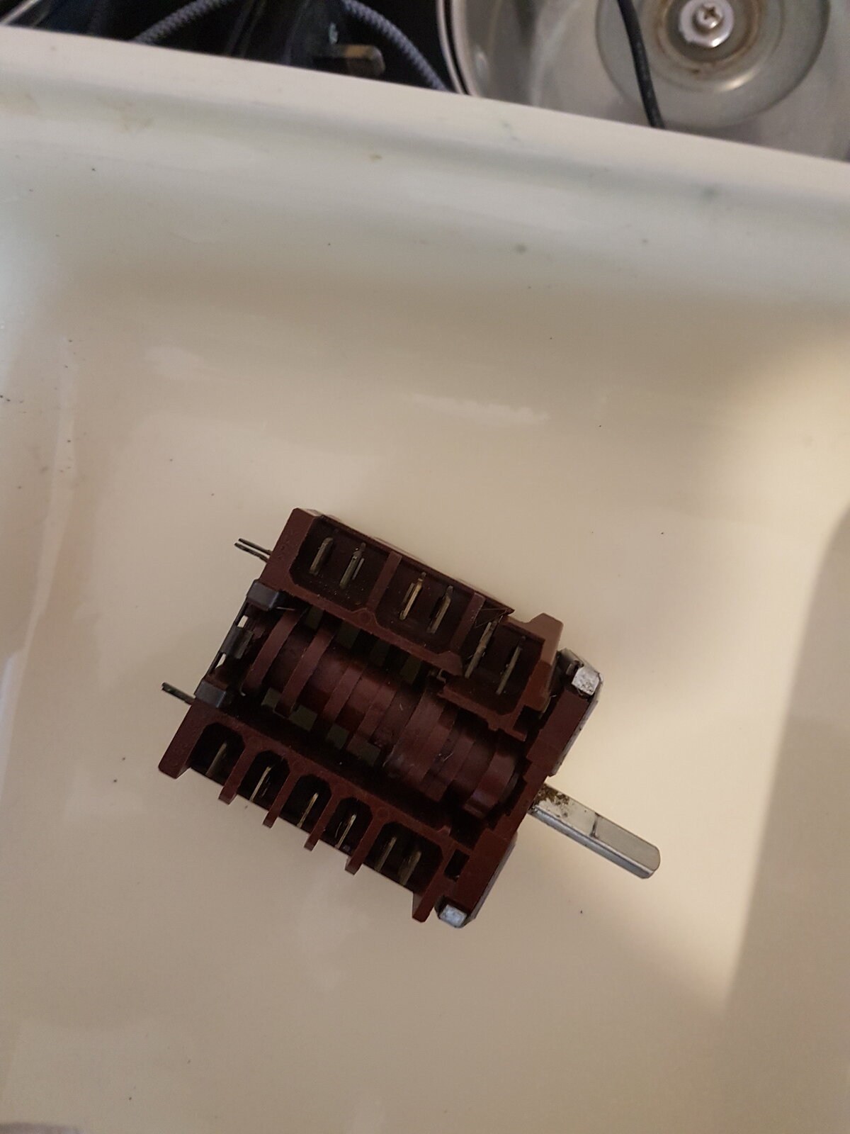

On these the thermostat white module/wire can be detached from the switch unit, which is what I have now done in the photo below.
I'll order a new switch unit, reattach stat and hopefully it'll be ok. The switch is £26, the complete switch/thermostat assembly is £58. I swapped the stat over with the one in the right hand oven, it worked fine, so I think the stat is ok.
