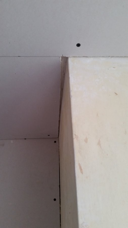

Hi,
After being let down by my plasterer I attempted to overboard my spare room ceiling. Turns out the room is no where near square which has left me with 5 - 10 mm gaps in two places. Do I need to replace the boards or can these be made good somehow for plastering?
Thanks,
Laurence
Not a big problem. Neatly fill up the gaps with bonding coat/ easifill. Leave it to set, THEN tape the joint, wall/ ceiling line. I'd also dab a drop of pva into the gap along the ceiling first, before you fill it up.
It's ready to be plastered then. One thing i would say though, put a good few more screws in the plasterboard, especially on a ceiling.

Easyfill is rubbish. Just use plasterboard adhesive.
Well, use anything, as long as it's a quality product/filler that fills up the gaps and then "sets". I prefer to use Bonding coat for these types of gaps, but each to their own Joseph ma boy. :))

Bonding cracks and drops out. That's why we don't use it to fill gaps around boards. We use plasterboard adhesive. It sticks to plasterboard. It sticks to walls. It doesn't crack and fall out. That's what it's made to do. Simple really.
